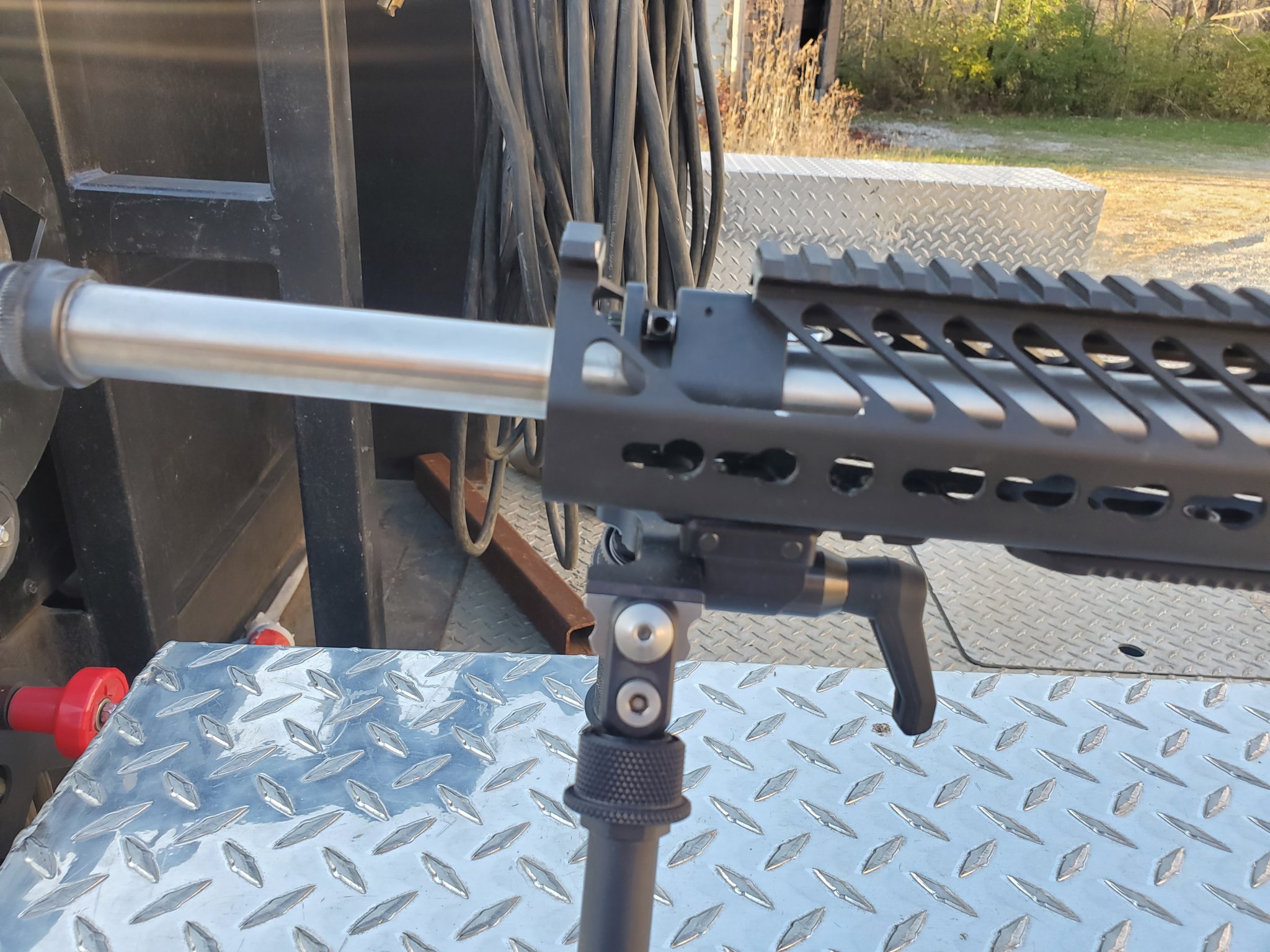

    So quick question: if you get the throw lever gas block and install it, will it fit under the handguard? It’s not the best but I’d do that and then switch it with a stick or Allen key or something. Let me know. I may just do that.
    Ok. Thanks! It will be a pain to flip under the handguard but I carry a pocket knife always.

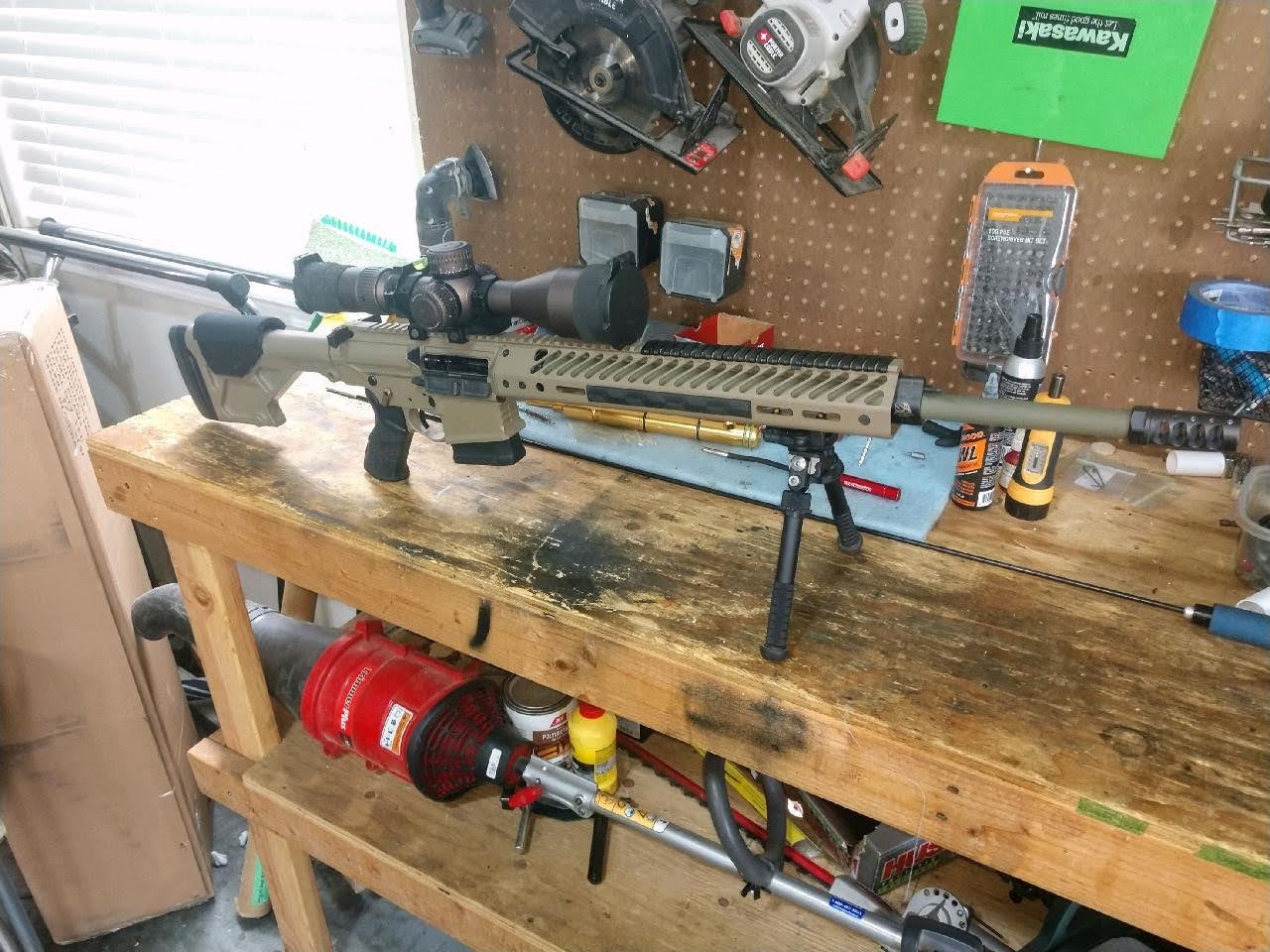

    Proof of life pics

    The lever gas block might fit under the handguard with a .750 barrel but not with an .875 barrel. As to the rifle gas length. I have an sp10 that with the original 6.5cm Seekins barrel and the Seekins GB completely closed, it would still lock back on an empty mag with my AAC titan QD can attached and still brat the hell outa the brass. Thats a 338 can so there is lots of room for gas in it. I do not understand why Glenn went with a rifle gas instead of a +2. I would imagine it had something to do with setup cost? I have since switched the barrel out with a 20" Krieger 308, slash buffer/spring and milled my handgaurd for the lever adjustable GB and it hammers 185 jugs! Lever gas block is the shit!
