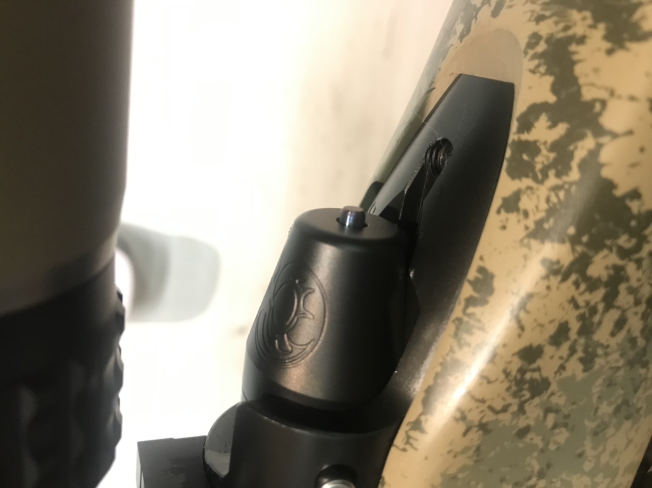

I have a TT diamond in mine. Pretty easy swap since the bighorn bolt is easily disassembled. I can’t recall exactly but I think I paid $30 or so from Bighorn for the different cocking piece.
Since their firing pin protrudes out of the back of the bolt you can measure the amount of of cock on close if you have calipers and they’ll send you a new cocking piece to adjust properly to your trigger.
Picture for reference

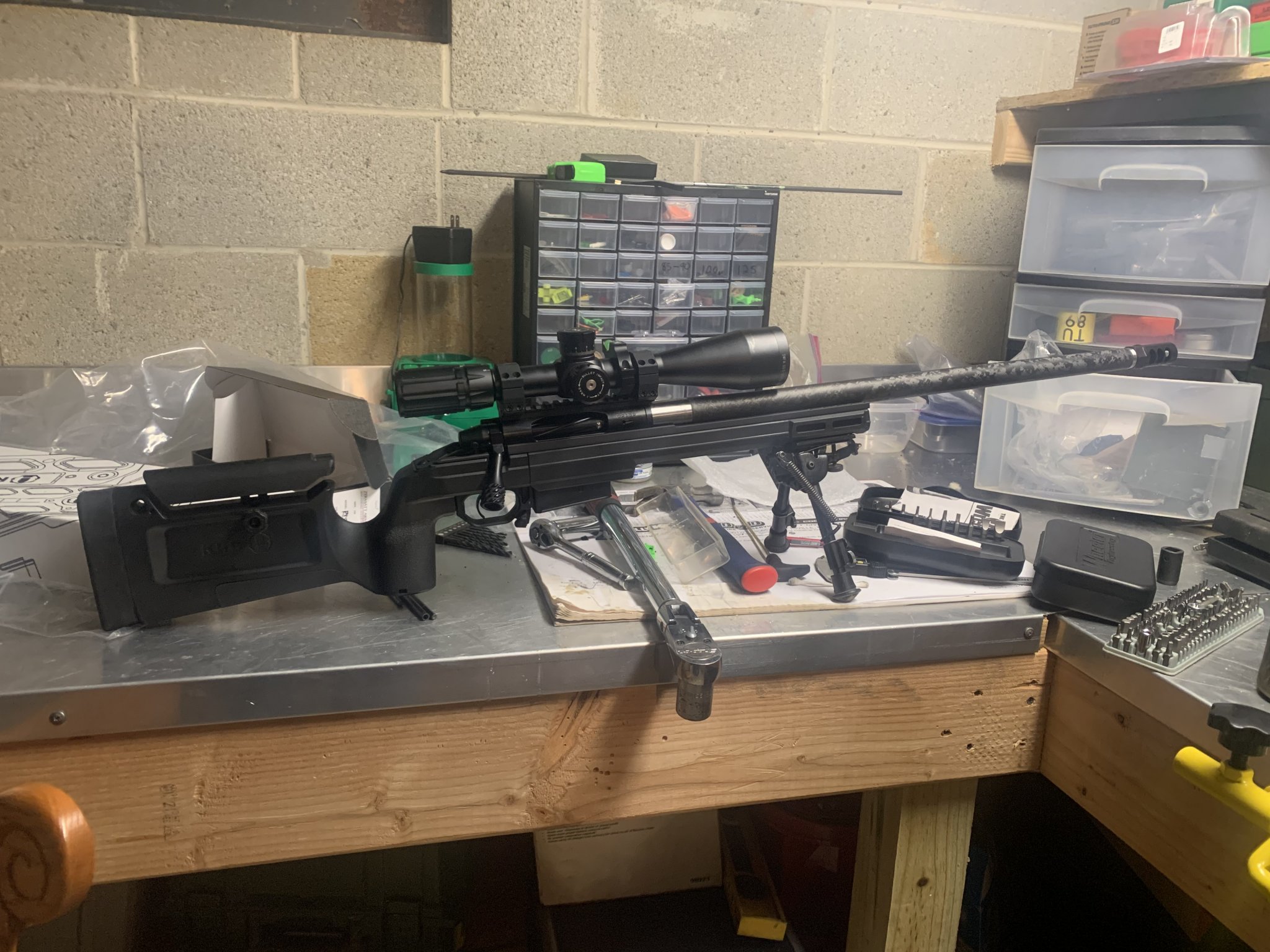

I recently had this same question, I decided to build it myself. It was quite easy and at no point did I regret building it. I purchased a barrel vise, go/no go gauges, and a action wrench. Take your time and you should be fine
