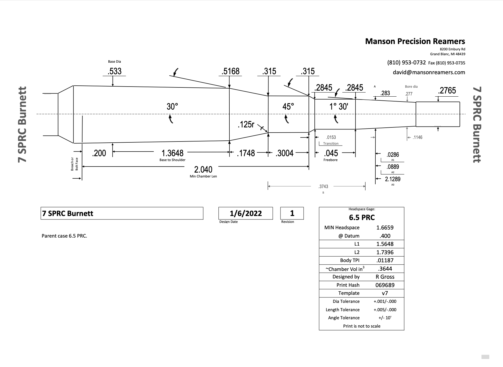

I'm really wanting to do a 7SAUM, it just seams to be right at the sweet spot. BUT...brass is non-existent right now so that's something to consider. As a second option, I ordered a reamer from Manson that's a 7mm-6.5PRC. Mine will be used in a SA with the 180 Hybrids, but if you put it in a LA with ~190s you could increase your range from ~1600yd transonic distance in the SA to hell and back, give or take a few yards. As for brass, the 7SAUM is basically limited to ADG and I haven't seen any available for quite awhile. However, Lapua and Peterson (among others of course) make the PRC and the conversion is simply running the mouth over a 7mm mandrel. Easy peasy. If you want the print I'm happy to send it your way.

Oh it's happnin lol. I ordered the reamer with 0.045" freebore which is shorter than I would've liked but it'll make a 180 Hybrid fit in a short action pretty well I think without eating up a bunch of case capacity. As for powder, I'm gonna start with 6.5PRC appropriate stuff like RL-26, N-165, H1000, etc. and go from there. I ordered the reamer at the start of January so the earliest I'll get it will be April. Then a few months to get the barrel done so I'm thinking July or August I might be in business. Of course, all that need be uttered is 'COVID' and schedules are automatically shot to hell so there's that.
I think of this as a grownup version of the 7mm-08, which I like a lot. It's not the best, an XM action and longer freebore could exploit the 190 class with better results, but I have a SA so I do what I can. Of course you're welcome to have a go when she's a thing my man

Oh yea, absolutely. I planned this out with an OAL of ~2.95" for ARC/MDT mags. But it would be a beast with hand loaded 190s. I'll probably puss out til the torrent lets up. All that 'if it ain't rainin', we ain't trainin' ' stuff is total crap lol
