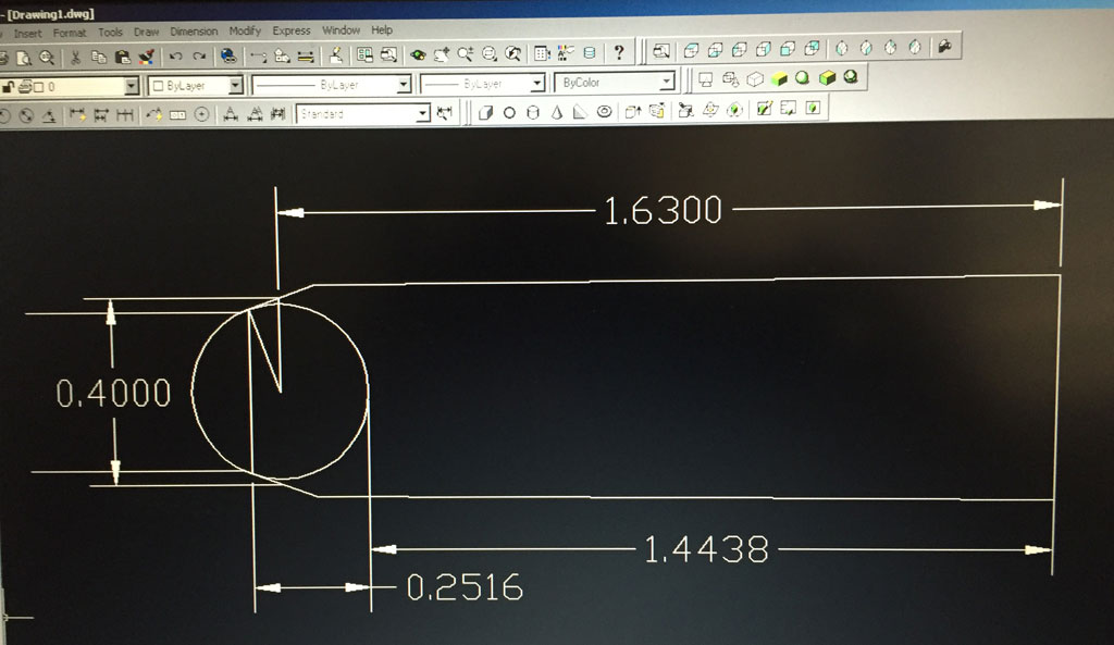

Why what? If you are rolling your own, then you can make your own gage using a case. You're running your own gamut there. When I fireformed, my headspace was who cares.. If you are shooting factory, you might want to know where your headspace actually is. If you don't want to purchase $100 headspace gages to find out, you can use a precision gage ball to check that dimension and math it out to figure out where you lie in the headspace tolerance. It's called ball checking. One. two. three?
Reactions: laserlite
"From time to time, I've been caught short of a head space zero gage when chambering.
My remedy is to use an appropriate diameter steel ball and do the math. Actually, it's nothing more than a tooling ball. I use this method all the time when fabricating my custom forming dies.
HTH
Alan Warner"

How is it done? I guess I'm the only one interested.
OK,
Start with the diameter at the body/shoulder junction. Lay in a sphere that is known and smaller than that diameter.
Now , do the Trig to determine the distance the center of the ball is below/ or above the body/shoulder line. Now you know from add/ subtract how far it is to the bolt face.
In case you have not realized, you need a reamer drawing for basic dims
Alan
OK,
Alan

That PT&G UNI gauge has a ball at the end of it. They discontinued it.
That because most don't understand how to do the math, Dave Kiff included. I refuse to use any of his prints. Over the years, iv,e found about a dozen math errors on his reamer drawings.
Head space gage for my 416 Warner is topped off with a .750 sphere.

The following week, I head spaced the barrel all over again, and the proper Go gauge required more headspace, by a fair amount.
Overconfidence was getting me into trouble.
Between the too hot load, and reduced headspace; I had overly souped up the cartridge, and nearly done physical damage to both both my rifle and self. A perfect storm is a perfect storm, and it is in our power to create one at any time. Don't cut corners doing headspacing.
I no longer recommend using a cartridge case to head space a barrel.
Greg
Sounds like a hot load was the problem, not the headspace. Did you measure the jump or did you jam the bullet?
