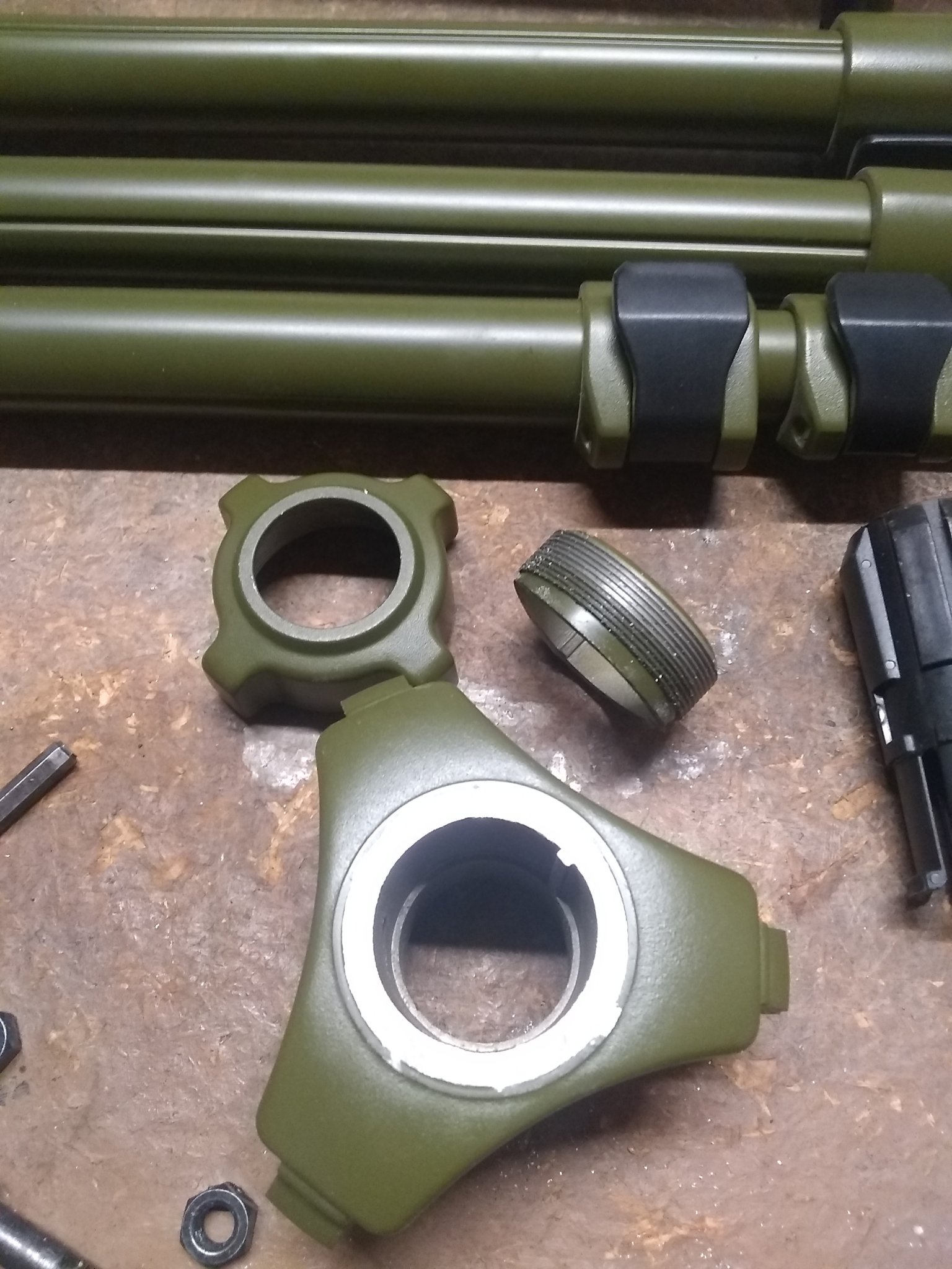

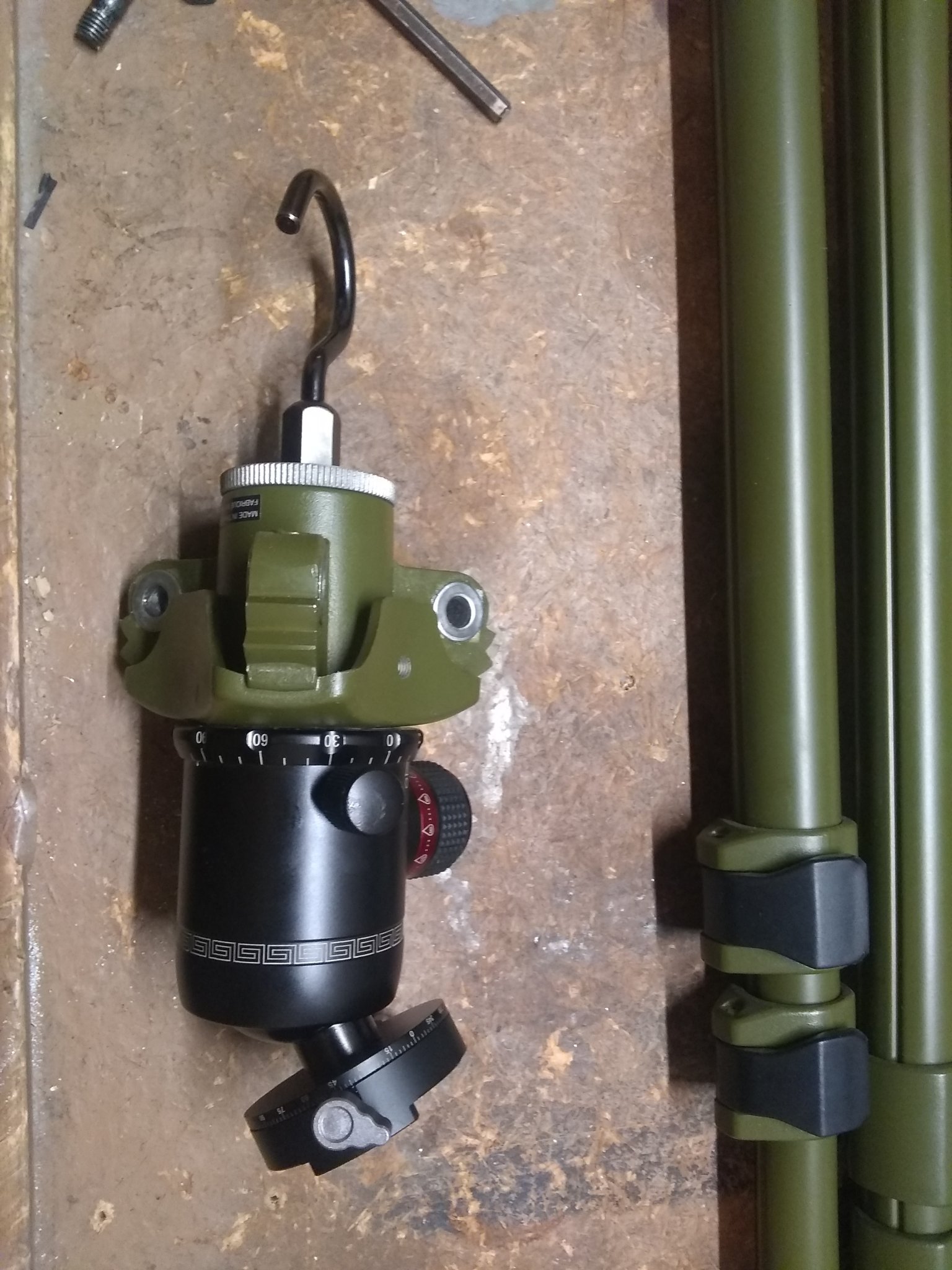

I took if apart:
Then I cut of the threaded collar

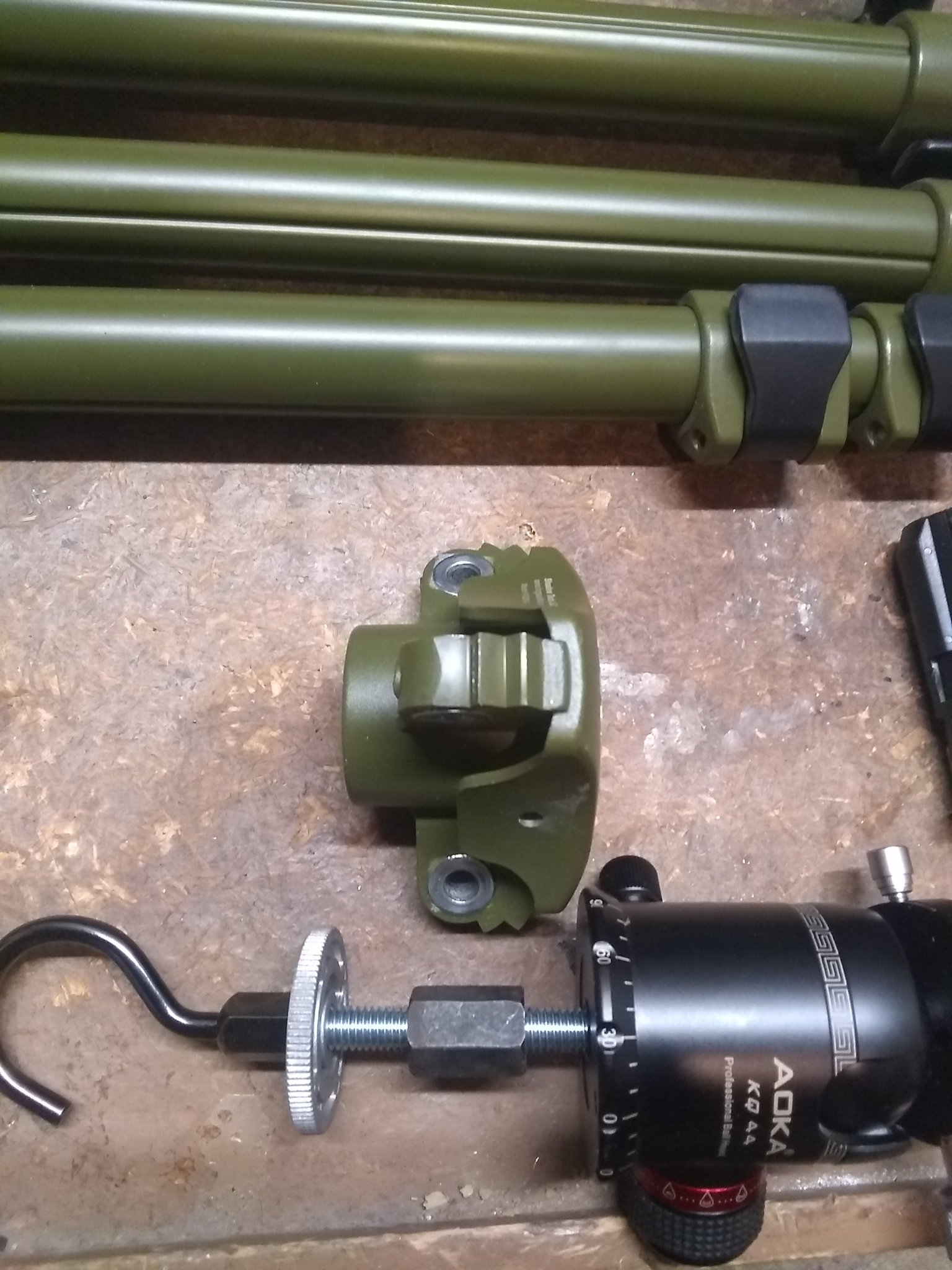

Connected the 2 screws and mocked it up

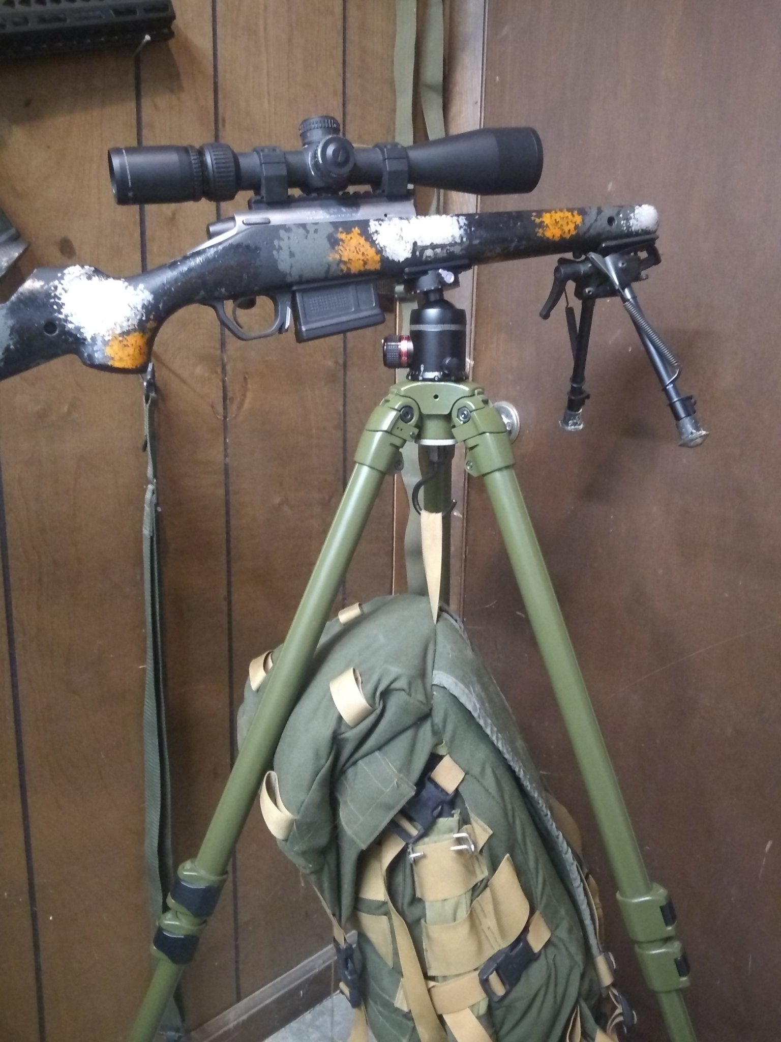

Here is it all tightened up
And here is the tripod now fully functional and it appears to be more stable, the ballhead is from Amazon but it does the job pretty well, I'll see how long it will survive but for now I can tighten it and it will hold the rifle good.

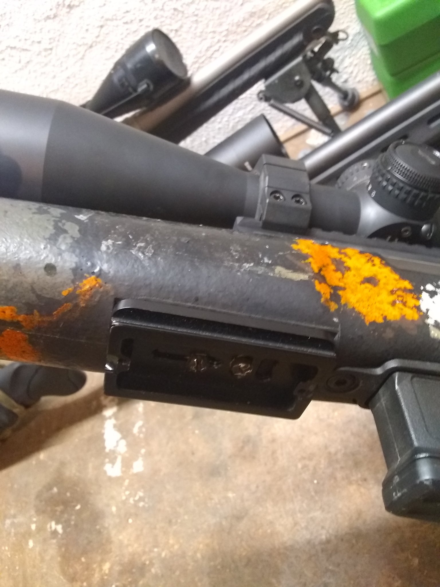

I just milled a square pocket the size of an arca plate, and screwed it to two nuts that I bedded into the rifle stock under the barrel
