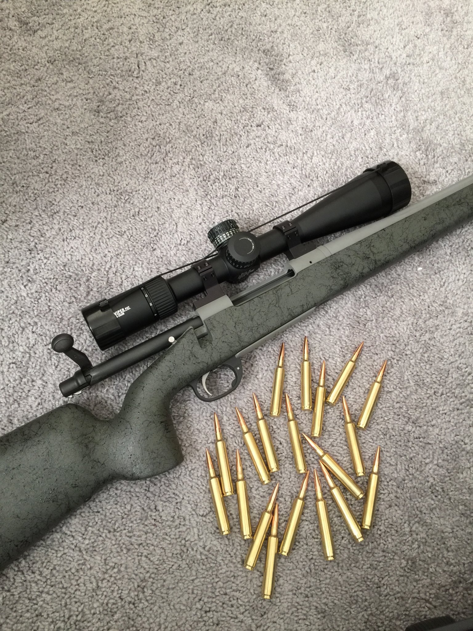

Rich is a great guy to deal with! I've got a 6.5 Sherman (long action) built on a Rem 700 and had a great time hunting in WY this past fall. I'm pushing a 140 VLD at 3167 with 60.5 gr RL-26. I achieved ~ 3240 with 61.5 gr, but accuracy was slightly better at 60.5 gr. This is from a 25" barrel.
