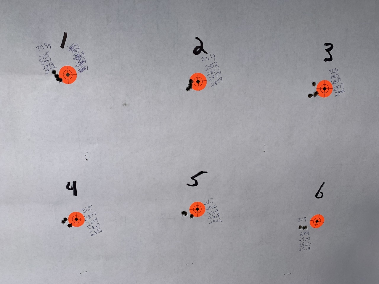

went out this morning and shot a few rounds with the shooters world precision in a 6BRA..fed205M and a 105 hybrid .005 off the lands...this powder is about 100fps slower than varget in my rifle...26" bartlein...but im pretty surprised with how well it shoots...im going to try it with some CCIBRs and 450s next and run it up a little more...at 31.9g i had zero signs of pressure...seems to burn clean as it took 10-12 rounds to foul from clean bore....4 rounds on each dot.

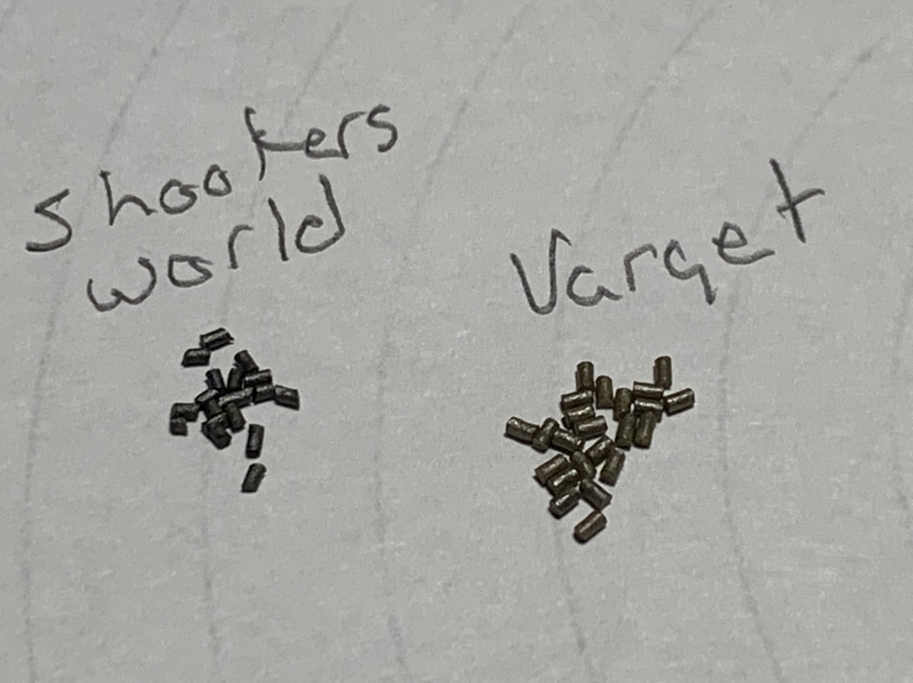

this powder looks and smells like IMR even went fired....
ok im pretty impressed with this shooters world precision and would not hesitate to run it in my BRA if i could not find varget...it is slower for sure but just stoke it up a bit and run a CCI450 and your good to go.
i only shot 1 round of 4 at each dot over the chrony but it looks like the CCI450 added about 20-25FPS to the 31.9g load compared to yesterday...i went up to 32.3g and pretty sure i could get 32.7g before compressing much...ZERO pressure at 32.3g...heres the groups...
View attachment 7268382View attachment 7268383

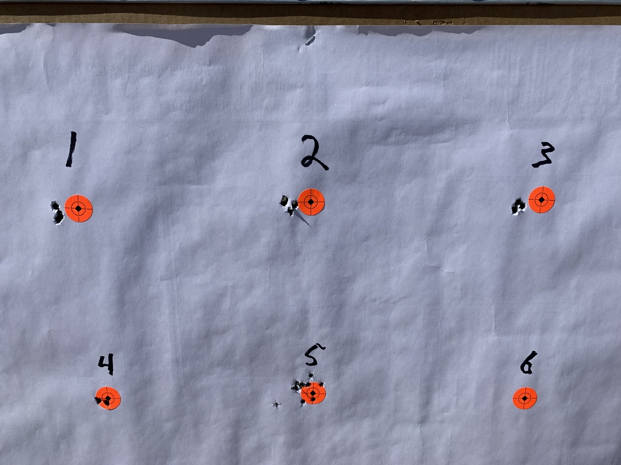

Stumbled upon your old post looking for a good charge for my BRA with SW PR. I loaded 30.5 grains and had slight pressure and only 2747fps. My rock creek must be slow! That’s awesome results you got. I got 200 rounds through the tube now and the pressure has seemed to lighten so maybe I’ll keep experimenting with it. Are you using Lapua or Alpha brass?
