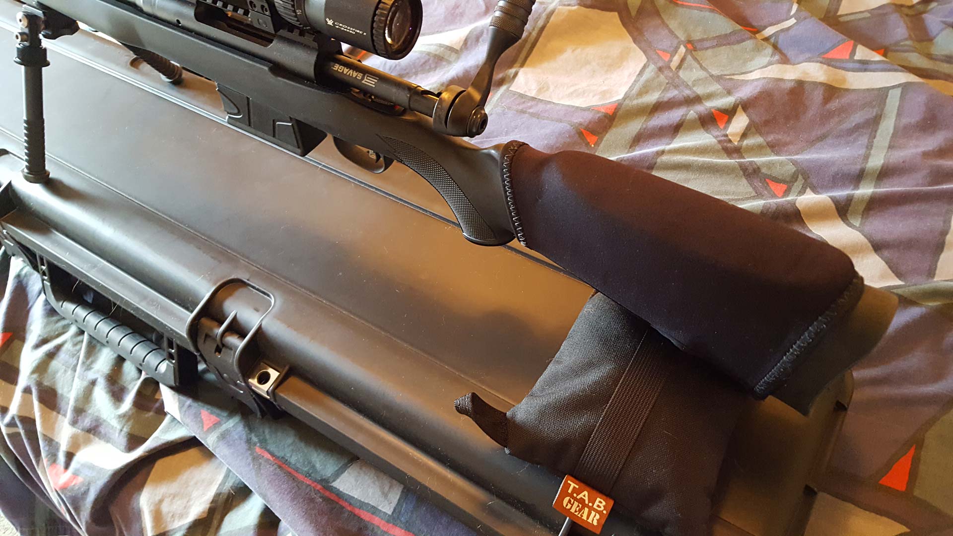

    I'm a newbie looking for advice on this item...I need a little something to slide under the butt stock so I can balance and concentrate on optic alignment and breathing, etc.
    Can I make one? Steal one? Tapered, heavy, light, wedge shaped, sticky, slippery, useless?
    What's yer opinion and super thanks in advance for it!

    Received my Tab Gear large rear bag and a shooting mat as well yesterday. Didn't get to the range but did mange to get an hour of dry firing in and the rear bag works perfectly and adds stability and micro adjustment to my sight picture at long range and high magnification. Just a squeeze or a little relaxation of the bag and micro adjustments and rock solid sight pix is possible. Exactly what I wanted.
    Fit and finish on the Tab Gear items is absolutely top quality. Easy to see at a glance that these items were crafted by someone who is both skilled and motivated to produce top end stuff. No Chinese Knock Offs here. I was stunned. I don't usually see this kind of good stuff for reasonable prices - super well done to Tab Gear. I'll try and post a pix or two later this weekend.
    I even got a $9 cash refund in the box as shipping cost less than originally calculated when I ordered online. So I got a note from April at Tab Gear and $9 cash in the box. When was the last time you saw *that* happen from an online order?
    I'll be buying lots more stuff from Tab Gear in the future. Good stuff.

    The TAB Large Rear Bag I got has poly beads in it...the outside material is thin enough to give and squeeze but heavy enough it'll be a long time before it rips or tears. Seems abrasion resistant and moisture proof as well. I'm pretty impressed . 1000 Denier Cordura Nylon triple stitched.
    Really has stepped up my dry fire practice. I'm holding on a metal chimney about 400 yards out at 18X and have the head of a sheet metal screw under my crosshair. Just a little squeeze or relaxation and I can control elevation with no wobble, jiggle or movement. Cool stuff - highly recommended.
