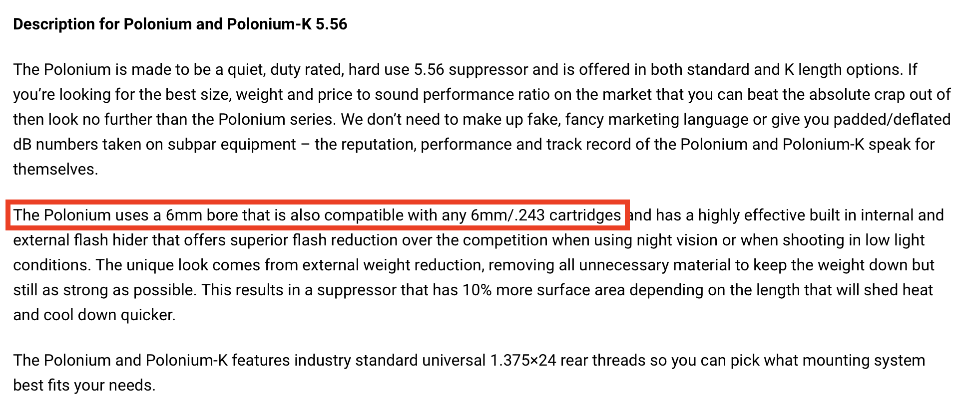

You can shoot a 6 ARC through the Otter Creek Labs Polonium 5.56 suppressors... Because they were purposely made to be able to do so.
Reactions: strikeeagle1
