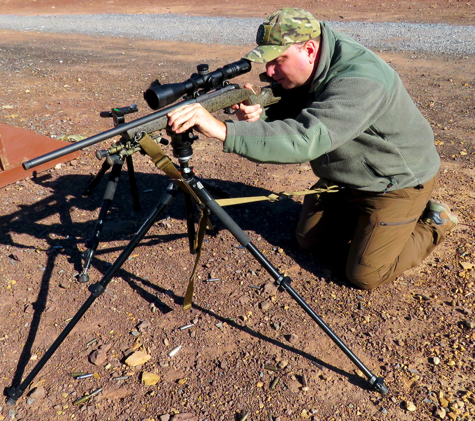

Across the Back
This method is quick and dirty but it can be used with carbine slings and slings like the ones from Armageddon Gear, TAB Gear, and Rifles only that are fast adjusting and/or have some bungee action to them. It’s effective when you are carrying the rifle in a patrol carry fashion and need some stability quick, fast, and in a hurry. From the patrol carry all you need to do is get into a shooting position, tighten the running end at the front, and let the tension pull across your back to the front of the rifle. I've used this method countless times from a variety of obstacles and not only is it very fast to bring to bear and it's also pretty stable. Personally, I like to use this particular method off of barricades or other obstacles where I may need to move from position to position and I can’t bring a lot of stuff with me. To gain some more stability using this method I also like to push my support arm out, sometimes against the front of the buckle and rotate my elbow inwards slightly to put more pressure on the sling. This helps draw the rifle down a bit more and I've found that it works well to help steady the reticle just before I break a shot. If you are using this method in a standing position, it will help to square up to the target, spread your legs about shoulder width apart, and lock your knees out while leaning forward slightly.
7119572
Using this method works in multiple shooting positions, not just the standing but it's pretty effective in the prone, sitting, and kneeling as well.

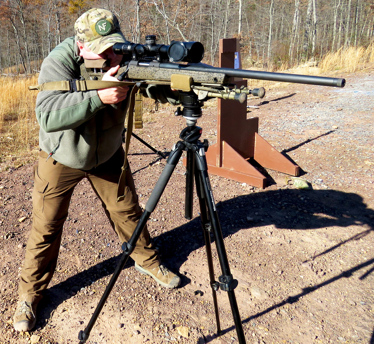

Carabiner Loop
Some precision rifle slings don't even feature a shooter's loop anymore because outside of some specific circumstances it's even really used. That’s not to say the sling turned back into a carrying strap though, typically they're still fast adjust so there are applicable techniques to get extra stability. Using a tripod to shoot from has taken on a whole new form there’s been a lot of techniques born from that. Some slings feature a built-in loop towards the rear of the sling that can be used to clip the sling to a belt via a carabineer when shooting from a tripod. Once in position the sling can be routed under the legs of the tripod to my belt and then I'll tighten the sling to draw the front of the rifle down into the tripod. Rolling my hips back slightly puts additional pressure on the rifle and helps make the position rock solid. This method can also be applied to shooting off of traditional barricades, natural obstacles, and a host of other situations. At the PRS match I had no issues hitting some targets like a 12” plate at 470 yards and a pepper popper at 400 yards from standing positions using this sling and applying the fundamentals.
7119573

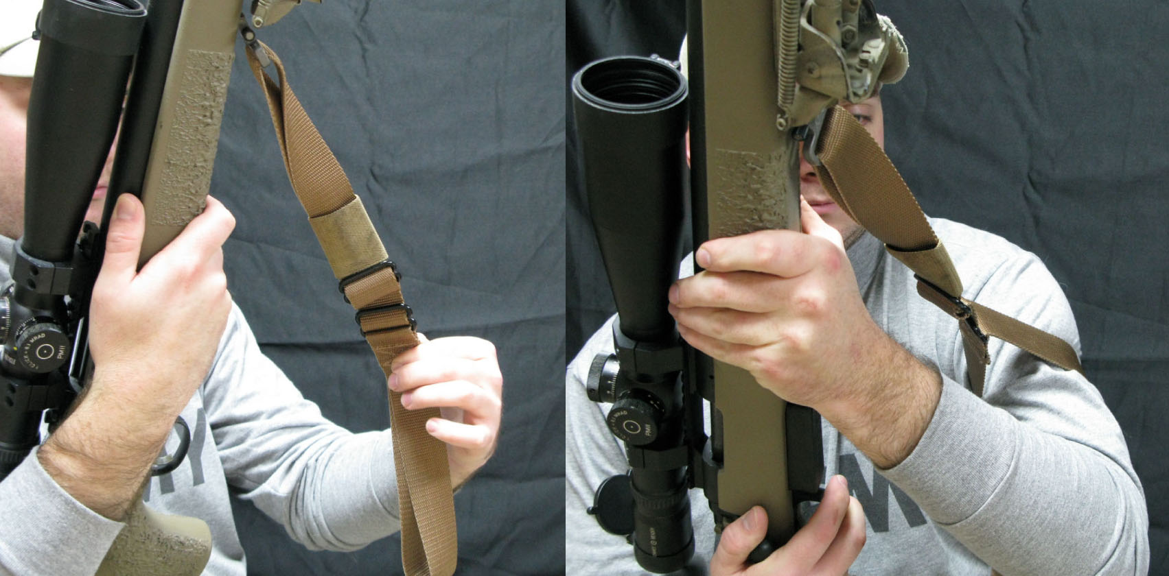

Wojcik Method
7119574
7119575
I first saw what came to be the Wojcik Method in an article by Caylen in one of the first Guns & Ammo Sniper magazines . What I like about this technique is that it’s simple and easy to adapt to multiple sling designs. Essentially, what you are going to do is pull the sling up as high as you can behind the tricep of your firing arm so that it runs from the rear sling swivel around your arm and to the front of the gun. Now, if your sling is adjustable, tighten it up so that you feel the sling pulling the rifle back into your shoulder, for some more tension you can also pull your elbow back if need be. Like I said, this method works across many different slings from precision rifle slings to hunting slings and works great off of tripods, shooting sticks, or even natural obstacles like logs or boulders.

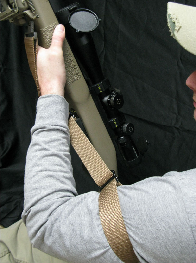

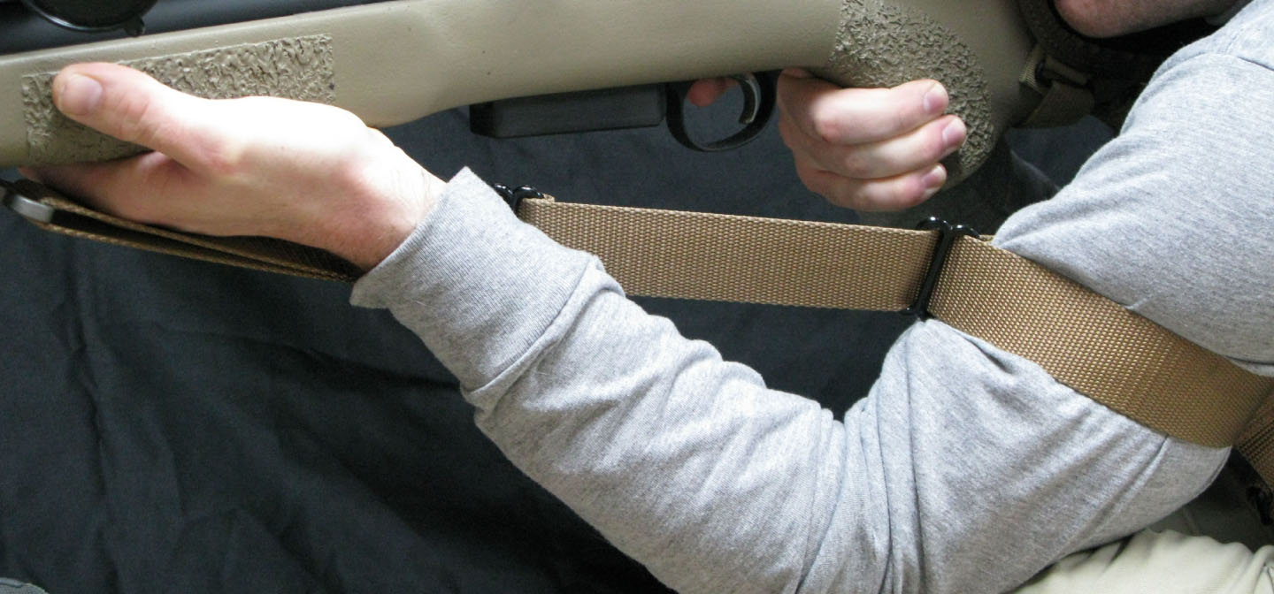

Here's some more pictures that I did years ago for another article. I think they'll provide a little more clarity on the set up of the sling and some traditional shooting positions.
Slinging up into the loop:
7121469
7121470
7121471

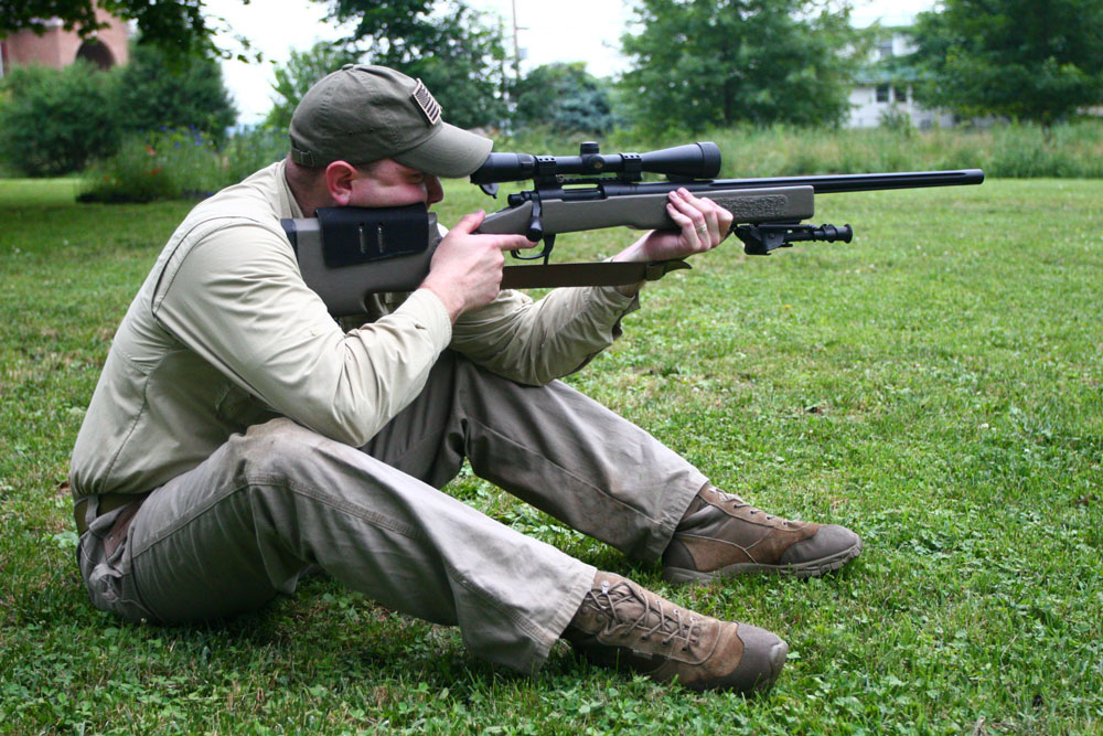

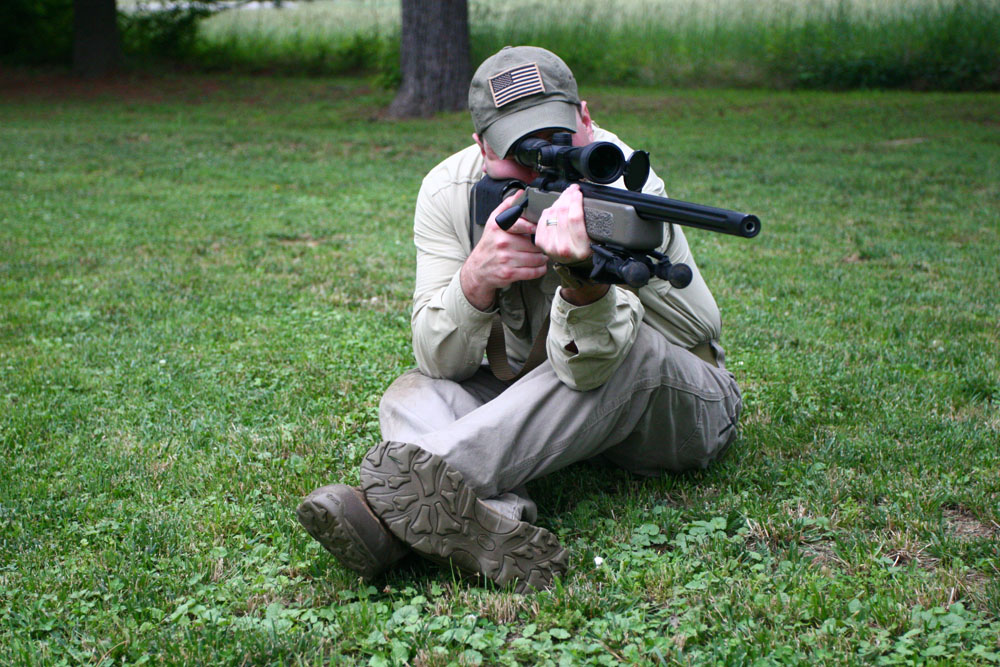

Variation of the sitting with my legs extended and ankles crossed:
7121472
7121473
Not everyone can get comfortable or stable in this position but if you can it is very effective. If I put a rear bag under my right leg, that seems to help with stability some more.

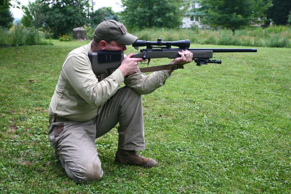

Traditional kneeling:
7121474
7121475
This is the only way I've ever been able to do sitting. Shot HP a lot of years that way. As you say extremely effective, just got to watch for pulse coming from the arteries in the lower torso.

Looking at your photos I can already see one glaring error I'm making: In your photos it appears that you have a lot of your palm in contact with the stock. Prone's not an issue for me with that, sitting, I'll have to make the adjustment. Might try the crossed ankle position.
I can't thank you enough for posting the photos and your article.
