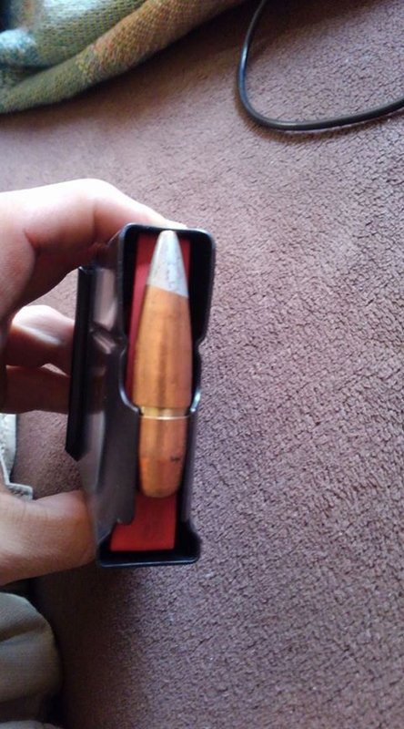

I've made a dummy round before, but never seriously pursued it. You cut a 300wsm case off at the shoulder and trim to length, then debur/chamfer and plug a .510" bullet in it. It really depends on how heavy a projectile you want. If you're looking to shoot 600+gr ball or solids like what you'd shoot out of a 50bmg, you're going to probably have to go long action because of the relatively massive ogive length. Or cut the case shorter and MAYBE get away with it in an AICS pattern magazine
Here's an API bullet in an ARC magazine; you see not much room for a case.

I had not heard of that one! Is the ID of the case close to .510? I had not considered the 300 was but I sort of figured the short magnums would produce a case capacity usable to get to 1k FPS. I am not beyond a single shot build but I honestly want to see it mag fed.
It is fairly close. A little bit of a bulge around where the bullet is seated. Unfortuately I don't think I have the dummy anymore. I like using the API bullets as reactive targets so I think it got shot.... but my feeling about it was that after the first fire-forming shot, and with appropriately sized dies/chamber, it would work out pretty easily without having to ream or turn anything.

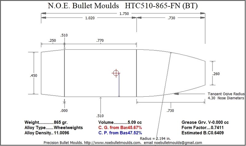

I have some molds for lead cast .510 bullets, on them I can control OAL of the bullet fairly easily. ONe is a custom mold I had made up recently to powder coat solid lead cast.
