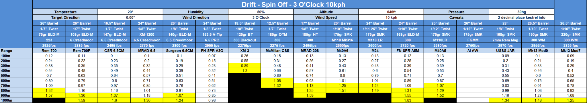

We are fortunate enough to have a 1000y range open to us any time we want and what we are finding is that, choose a good bullet like the 185gr Berger Jug in 308 or the 147gr ELD-M, and impacts on MOA targets at 1000y are still entirely possible.
Below is a chart of our guns with their respective loads.
Yellow is transonic. Black is subsonic. The mil values are wind drift in a 10kph 3 O'Clock wind simply for comparison's sake and hit probability 1 cart/bullet vs another.

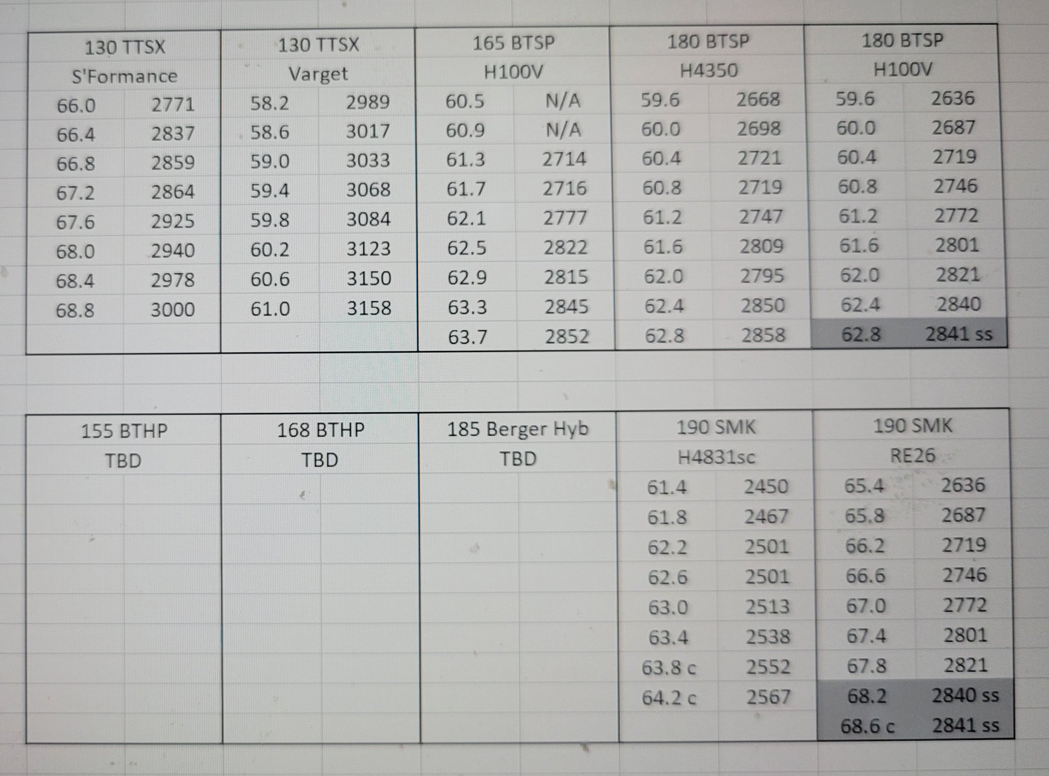

As for short. 300 WSM, here are some velocity spreads that I shot with 200gr ELDx, 168gr E-tips and 165gr TGK over RL-16 and Staball 6.5 in my 18" barrel.

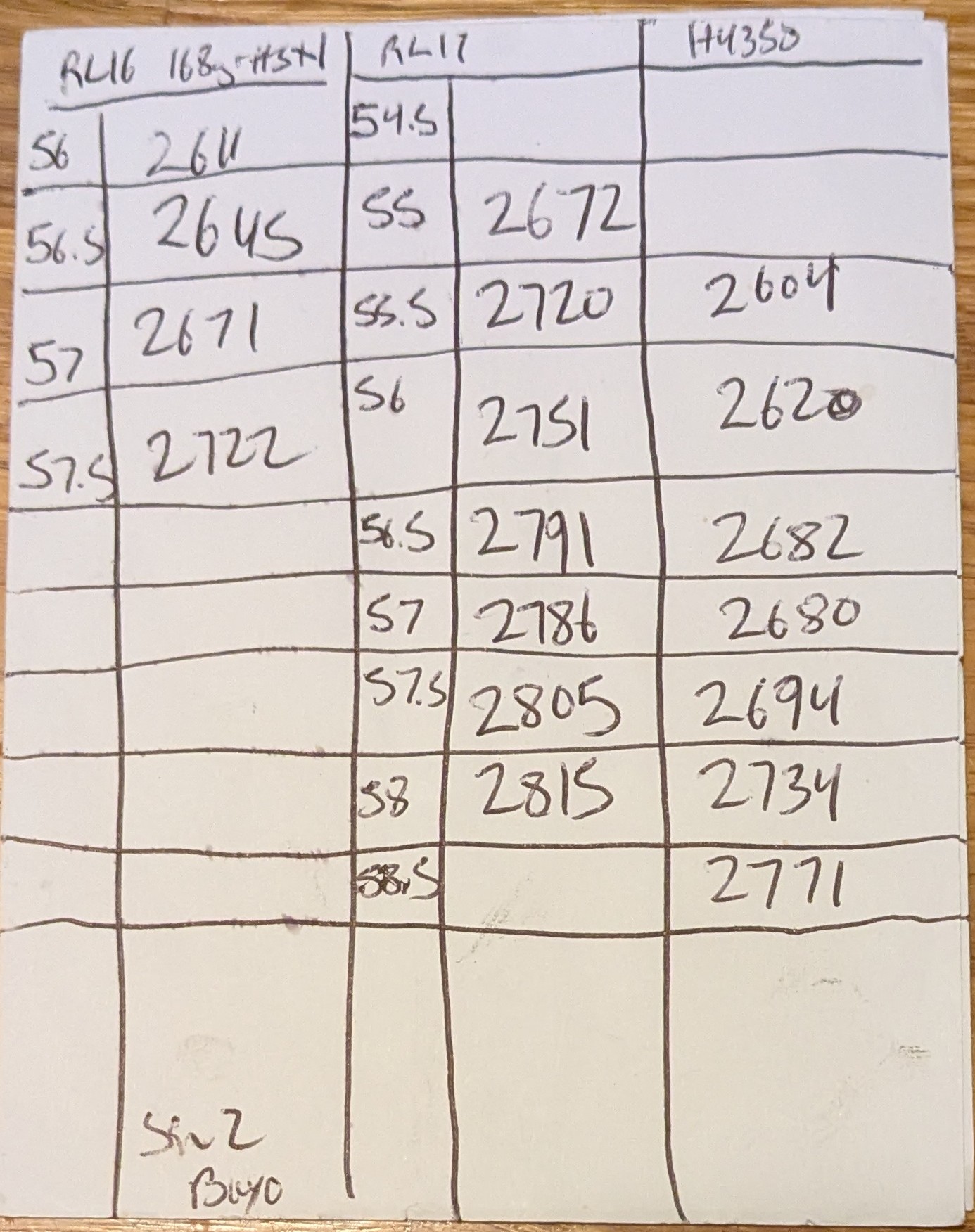

I'm not being pedantic, I'm saying I've tried what you're theorizing about, and the equivalencies and generalities you're throwing out as facts are wrong.
I'm saying I've found the real world difference between top end .308 and .30-06 loads is usually closer to150fps, not the 50fps you're stating, sometimes more with heavier bullets. I also haven't seen that difference change much in shorter barrels. So your conjecture about the .30-06 being "too inefficient to burn the extra powder" and therefore not delivering a significant velocity bump over .308 of the same size is just nonsense. There are folks posting real data and experience with shorter .30-06 rifles, but you don't seem to be interested in learning, just doubling down to argue that your initial assumptions were correct afterall.
I didn't see any .30-06 data in the table in your first post, but you said above that your example velocity of a 178gr bullet at 2,560 fps in a 16.5" .30-06 is a measured number right? Is it your load, your rifle and if so what is the load?
Here is some load data from my 18.5" .30-06.
165gr SBT, 59gr H4350, ~ 2,800 fps (was 2,920 fps when the barrel was 22")
Here are some spreads I shot with 168gr TTSX to start load workup.
One of the posters above also mentioned that his 16.5" .30-06 with 165gr ran around 2,725 fps, which is only about 25fps slower than I used to run 165gr NPs in my 22" .308.
For comparison, here are some of my current and past .308 loads.

130 TTSX @ 3150
180 BTSP @ 2850
190 SMK @ 2800
Reactions: Gtscotty
I have to agree with @Gtscotty
I built a 16" 300 SAUM for deer and hogs from a blind. I wanted to dump as much energy as I could on the hogs because I hate chasing after a wounded pig in real thick cover and cedar. I want to anchor them.
You can squeeze more performance from a shorter barrel, but you have to burn more powder!
My 300 SAUM from a 16" barrel beat my 30-06 from its 24" barrel when doing pressure tests with several bullets and powder combos.
130 TTSX @ 3150
180 BTSP @ 2850
190 SMK @ 2800
