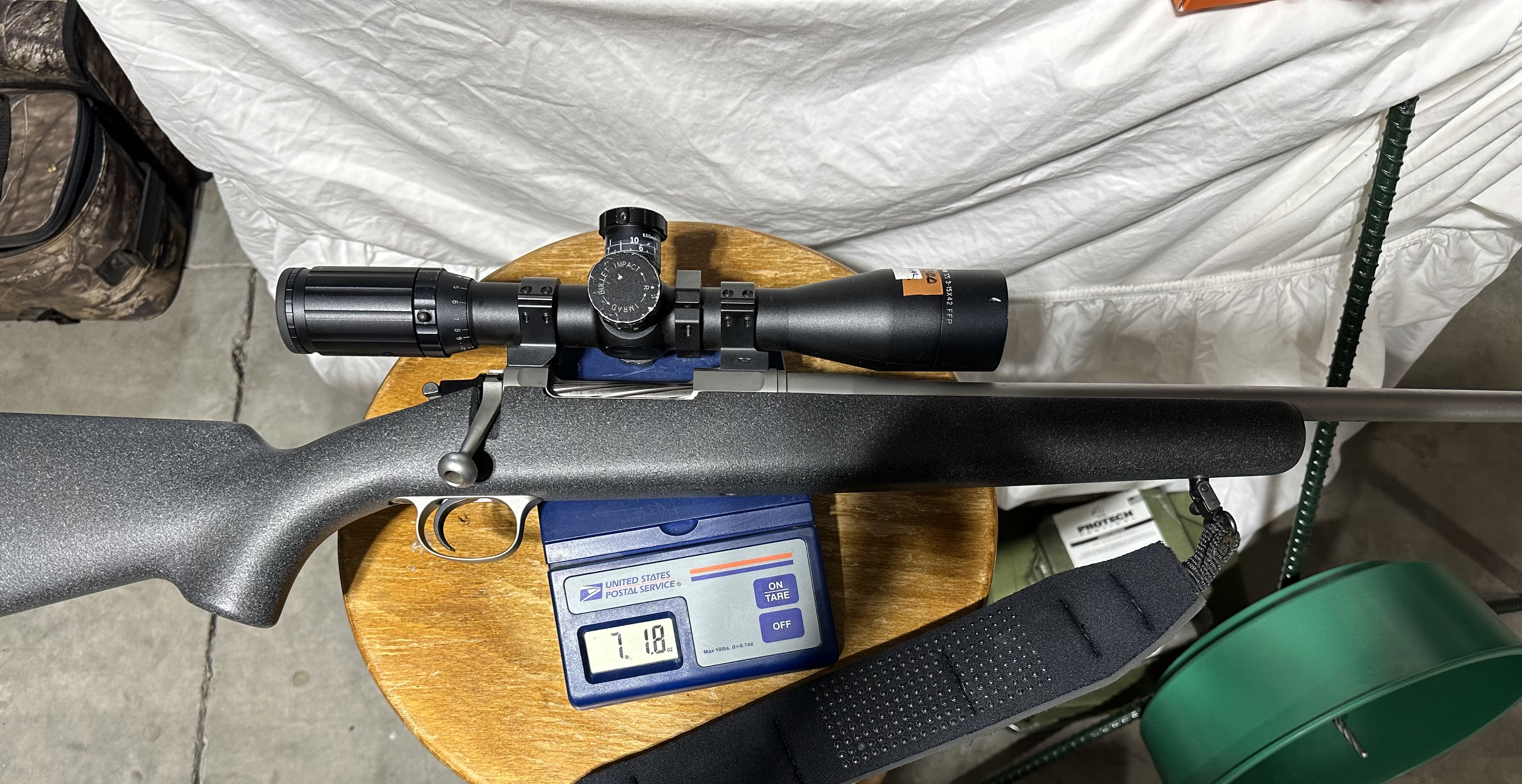

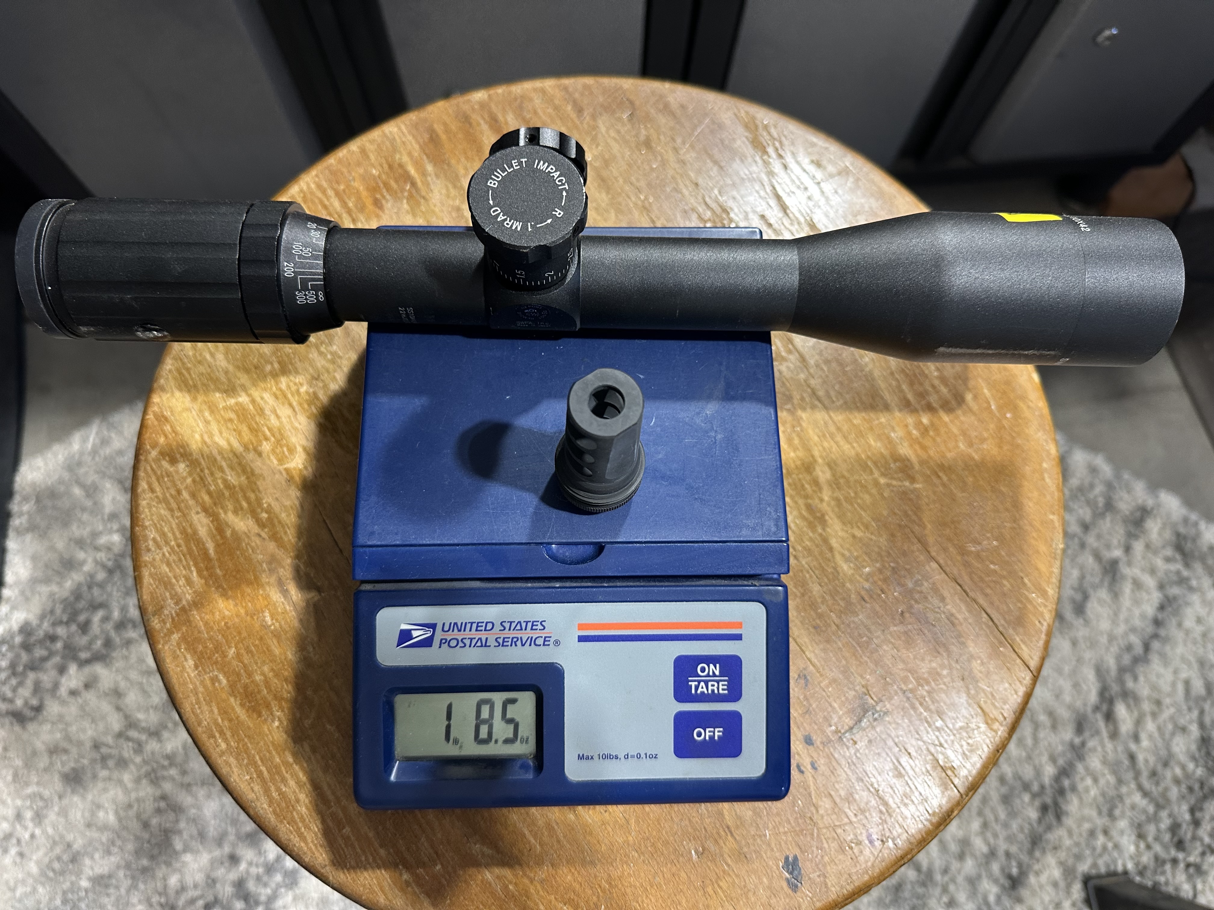

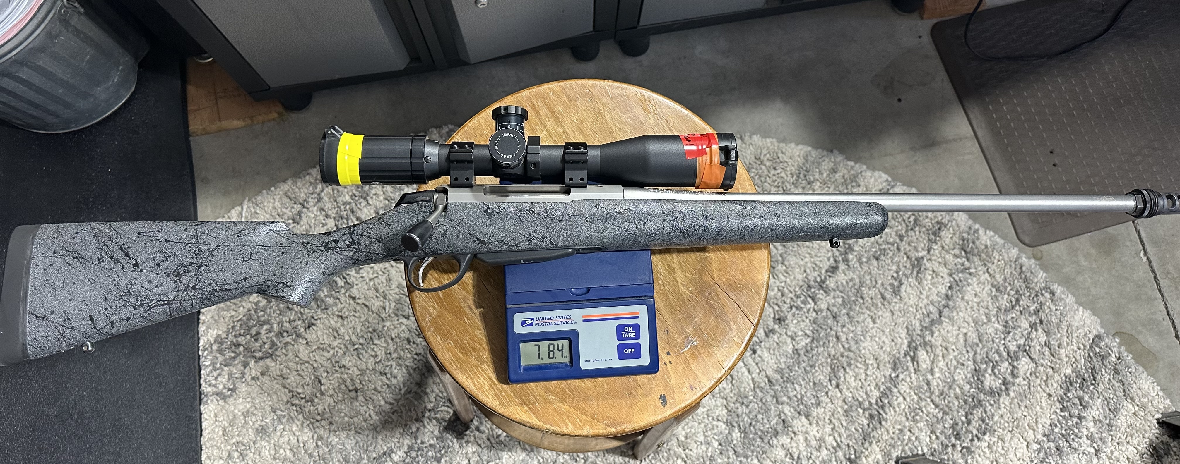

This is my 20” 6.5 creed in the stock. I’ll pretty sure it’s a stocky’s. 7.5 lbs all up, and the scope and silencerco adapter weigh 1.5 lbs, so 6 lbs-ish for the rifle with Sportsmatch 30mm rings.
The 17-1/2” 308 has a Athlon 2-12, so the weight savings with the bigger bore and shorter barrel are offset by the additional scope weight.
With the can on (AB Warthog), it’s not unwieldy, and with the can off, the brake tames recoil.

This is my 20” 6.5 creed in the stock. I’ll pretty it’s a stocky’s. 7.5 lbs all up, and the scope and silencerco adapter weigh 1.5 lbs, so 6 lbs-ish for the rifle with Sportsmatch 30mm rings.
Thanks for checking on that, it’s right around where I’m hoping to weigh in.

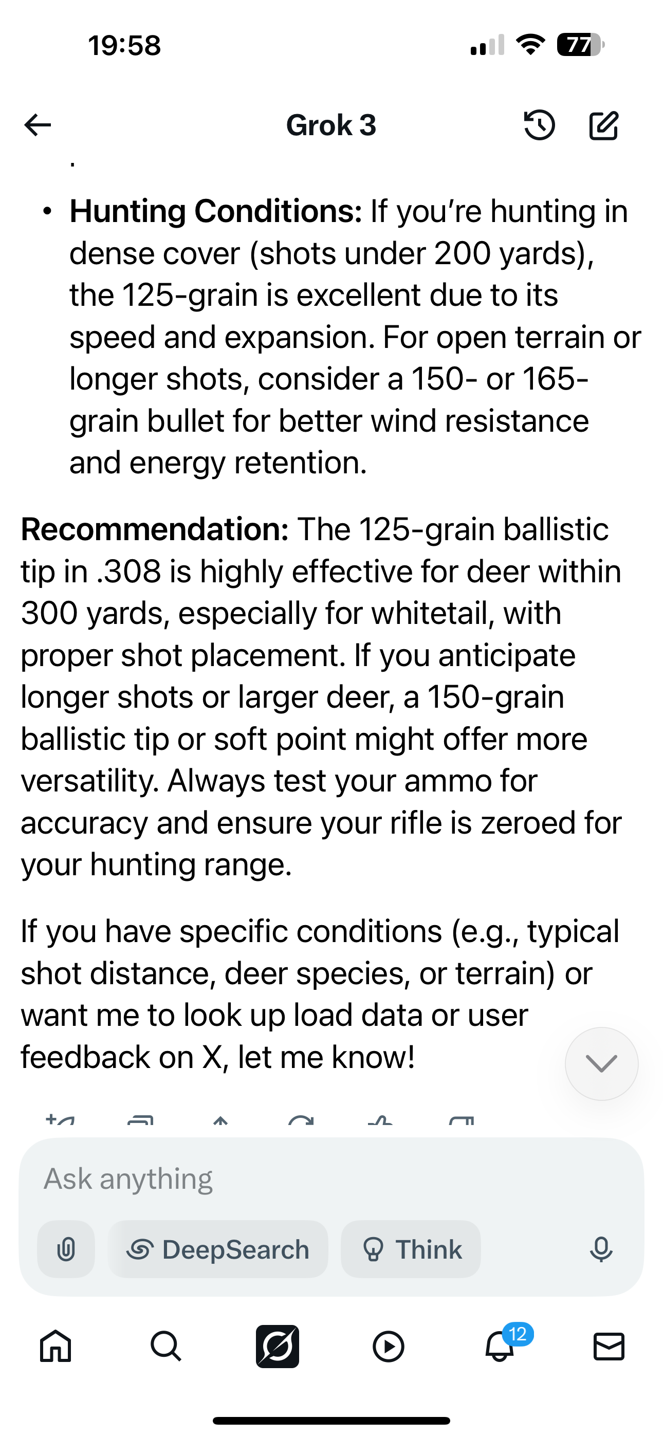

Have you actually shot a deer sized animal with a 125 NBT out of a 308? Your response leads me to think you have not, but know a guy, who knows a guy, who knows a guy, who’s uncle, on his mother‘s side, once shot something with a 125 ballistic tip, and it blew up, or that’s the excuse he gave when he didn’t recover the animal.
I have. And got similar results to what Grok says.
And explosive!
Reactions: Guns&WhiteWater
I grew up shooting everything with lighter for cal nosler ballistic tips, as my uncle was a huge fan of fast and light as he did our reloading. So yes, 25-06 270win 30-06. I saw dramatic damage on game with these bullets. Very short necks on the wound channels and then heavy fragmenting. Granted we were pushing these bullets faster than a short barrel 308 would. These were like poor man weatherby loads. We did our best to stay off the shoulders as meat loss was pretty heavy, but just in the crease resulted in many bang flops.
