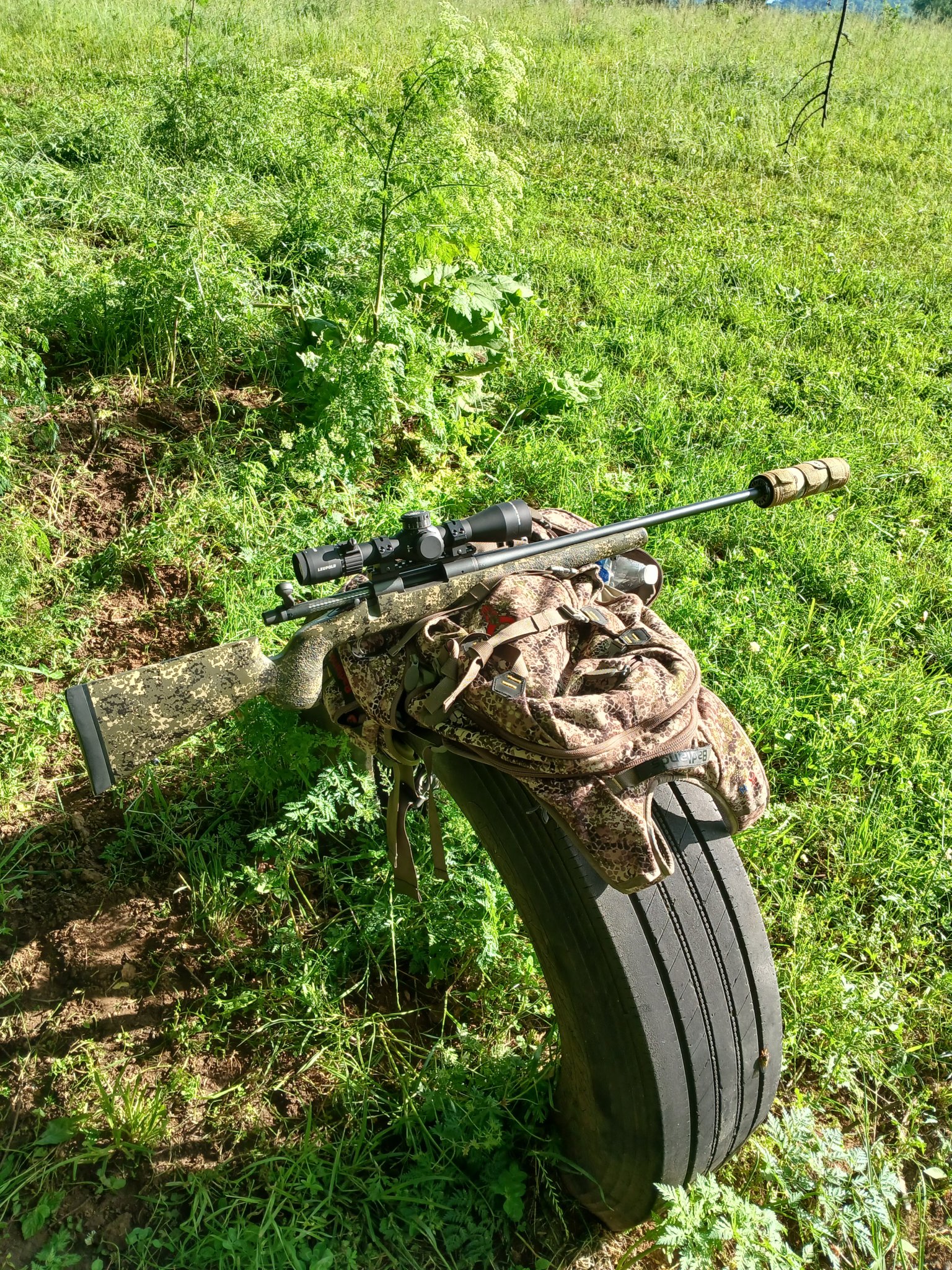

Pest/vermin control like rabbit/ ground hog sized targets. I have other rifles that are 4x the weight which I use for going farther. Wanted to keep this rifle light, compact, and handy

I hear ya. Man, given your use, some magnification is in order. I'll tell ya, I'd just write off the idea of an LPVO. I run a 1-8x NX8 on my "very general purpose" rig. It's a good scope. Kind of narrow field of view, but good glass. Depending on my surroundings and the general atmospheric conditions, making a 400 yard shot on something the size of a groundhog is very doable, but in less than ideal conditions, I find myself wishing I had grabbed the rig with the Leupold on it.
Honestly, I think that if you got a 2-10x, you're gonna be wishing you got more. I'd go with something with a 3x bottom end. With at least a 12x or better yet 15x top end. You'll just plain have to work less to see what you're doing. There isn't much of a size/weight penalty going up a step from a 10x and it'll be a much more enjoyable experience.
