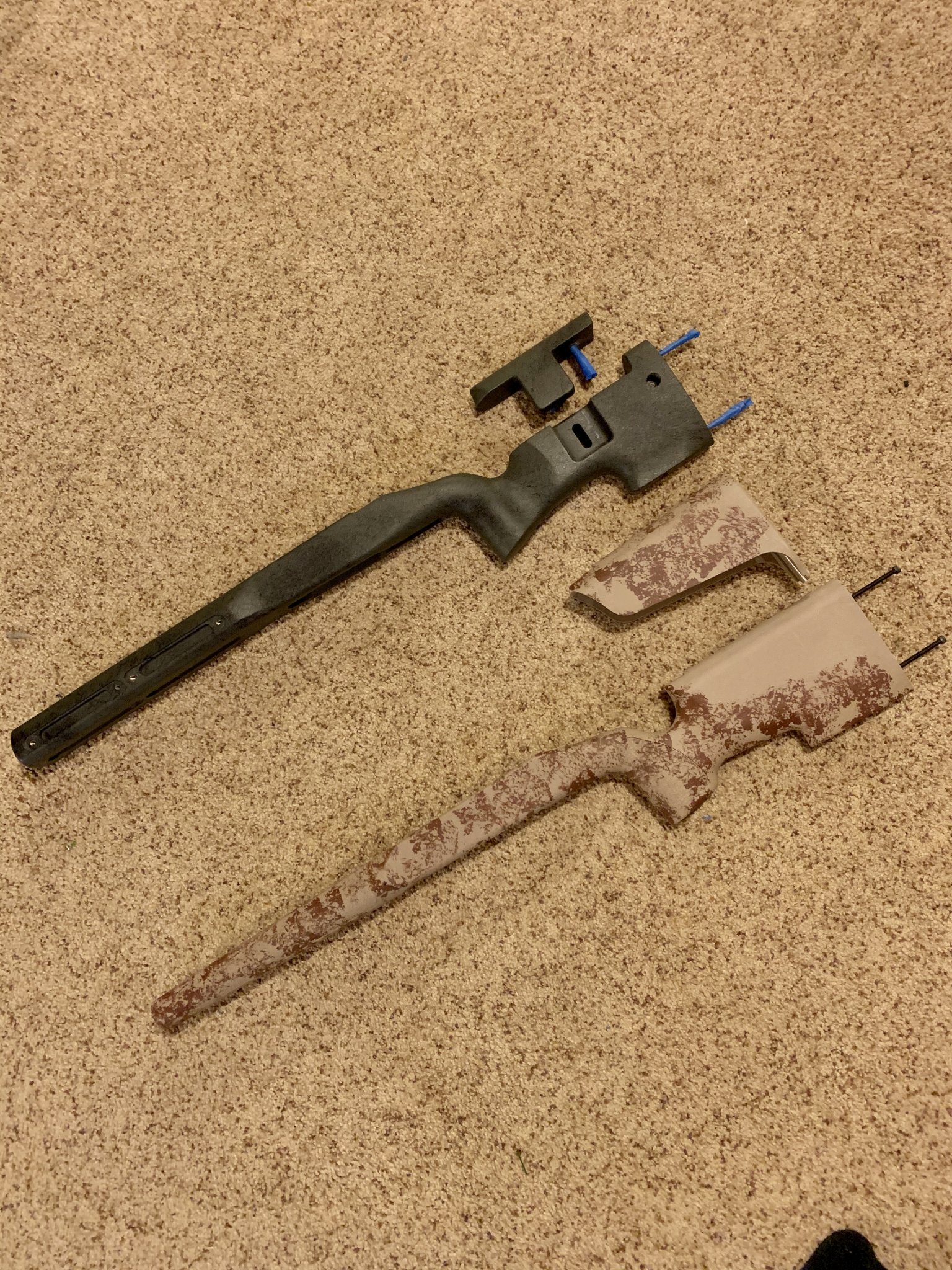

    Here is one that I had torn down before paint... just looking at the LOP, even adding a recoil pad should get you pretty close.
    EDIT: just measured. Won’t go under 13” with recoil pad unfortunately. Sorry.

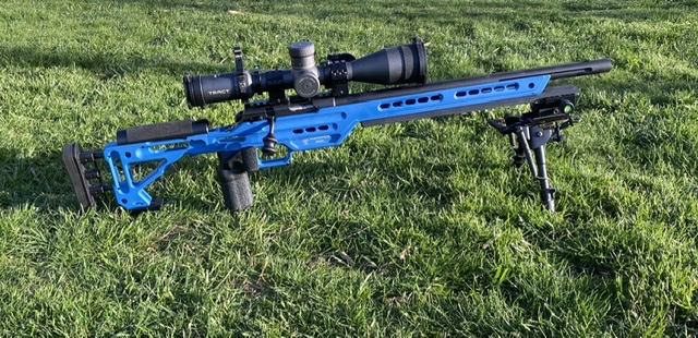

    MPA is the way to go. I had this one built for my son back in the winter. I told Phil what I needed and he took care of me. From GP what I gather this is basically a folder with the hinge removed. If you want to stretch it back out you just need to add the hinge. This is my sons rifle.

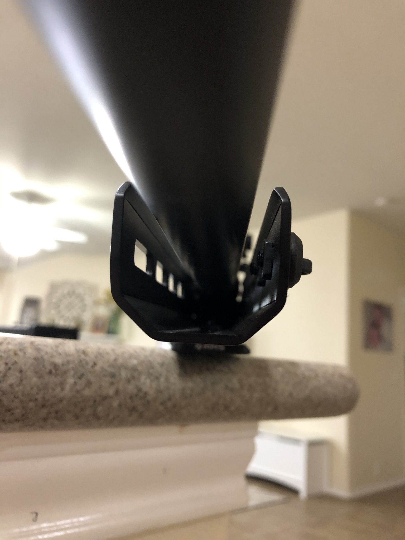

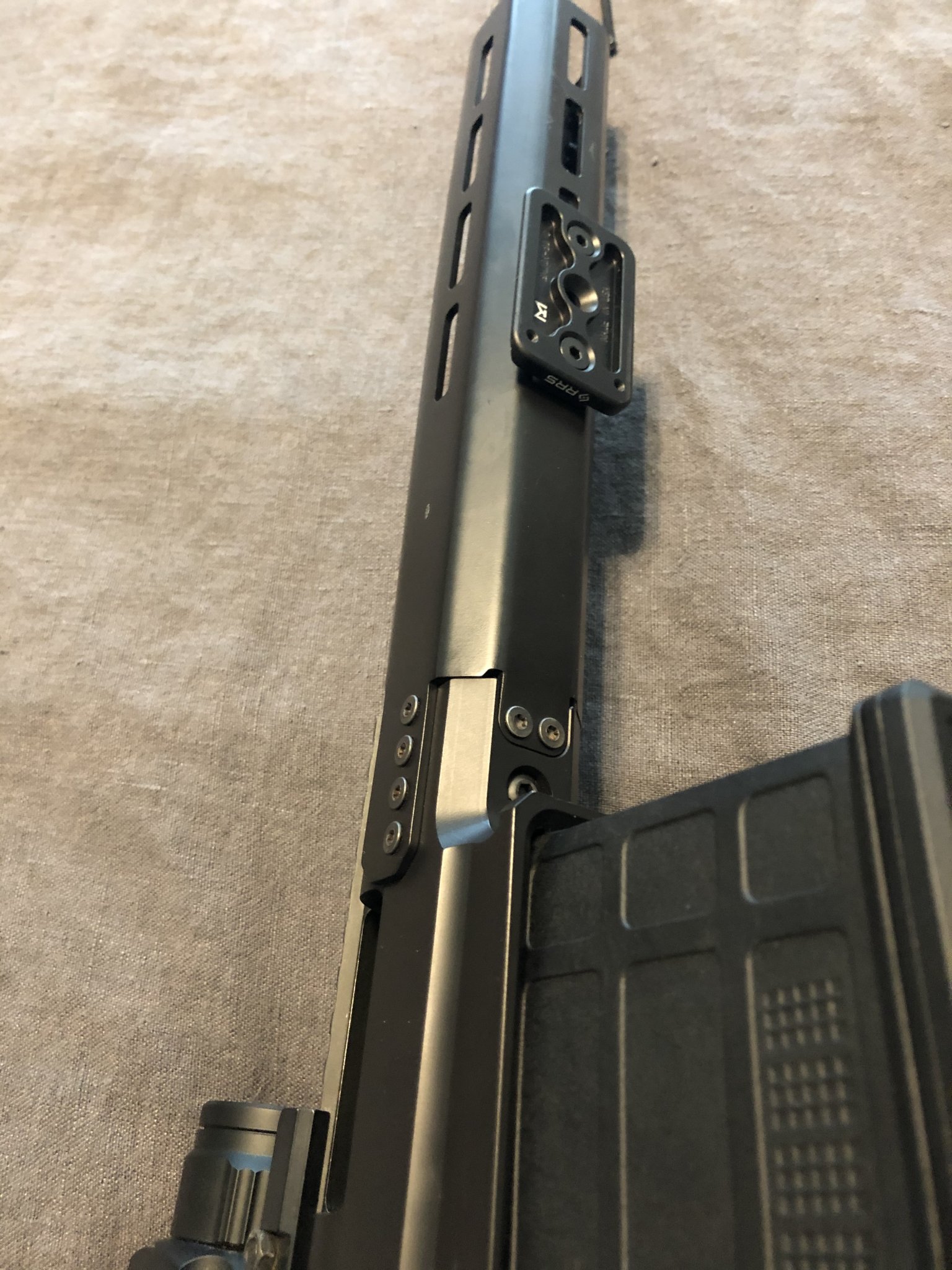

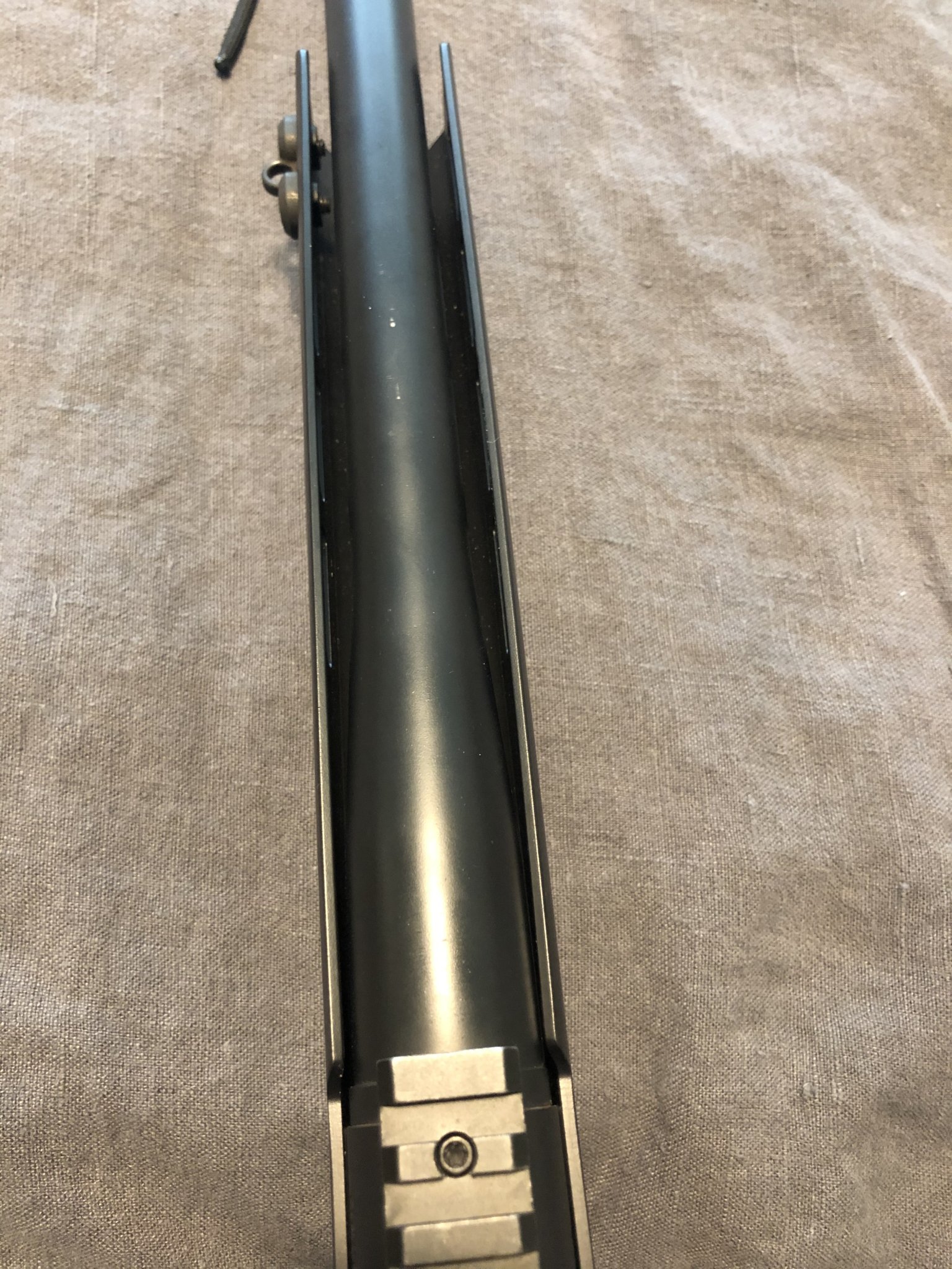

    Quick update in case anyone cares. Never know who will be reading this as a result of a google search. The JTAC chassis came in and I’ve got everything assembled. The shortest of 3 preset lengths on the collapsible stock is right at 11.5”
    The unit looks nice and was packaged well. My barreled action dropped right in. My only constructive criticism is that the rail is more rounded than I’d like but there is a narrow flat part on the bottom. And the M-lok slots don’t go all the way back to the mag well for RRS plates. I suppose they designed the rail more for people to carry, and didn’t consider people mounting on a tripod.

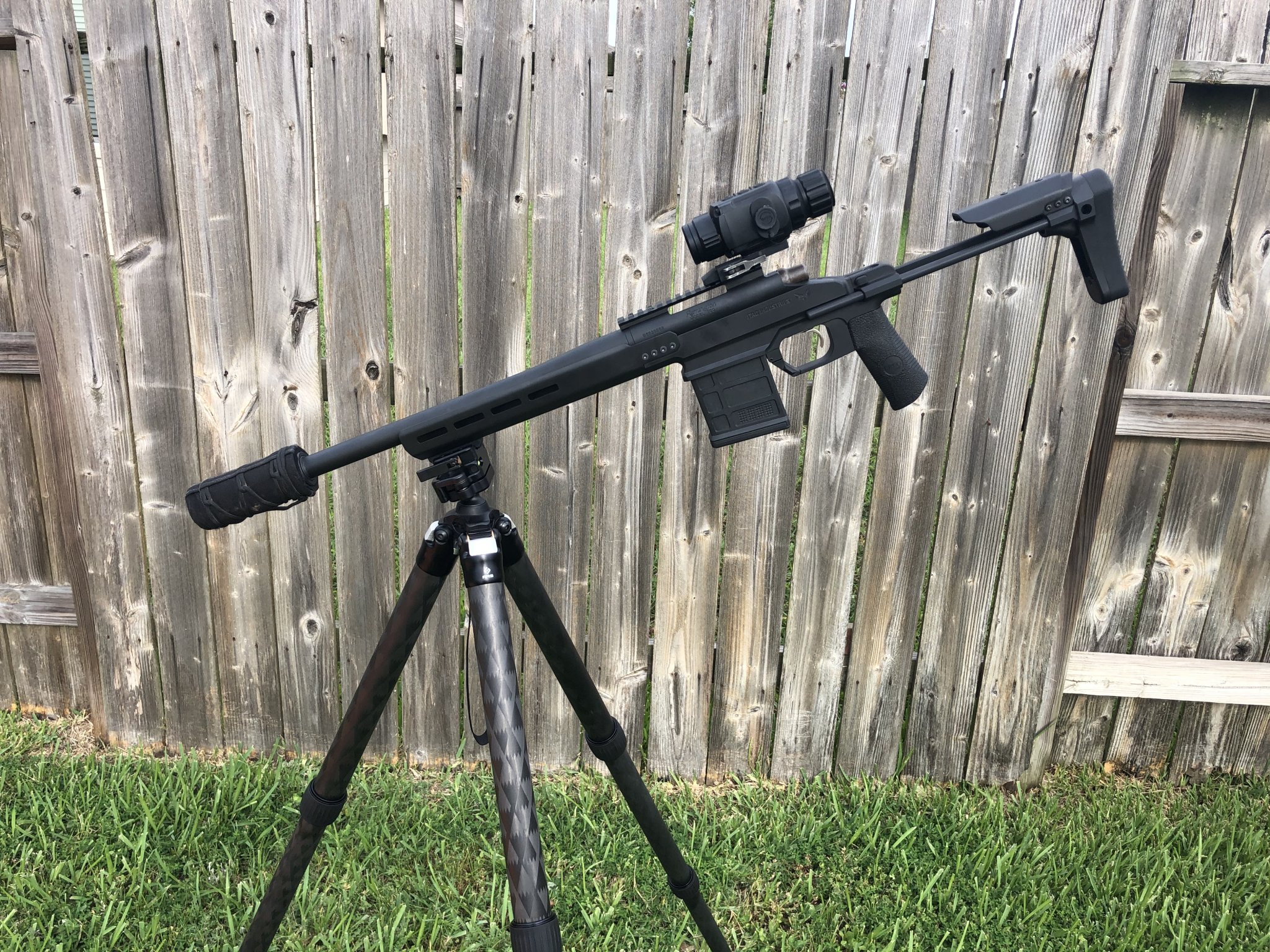

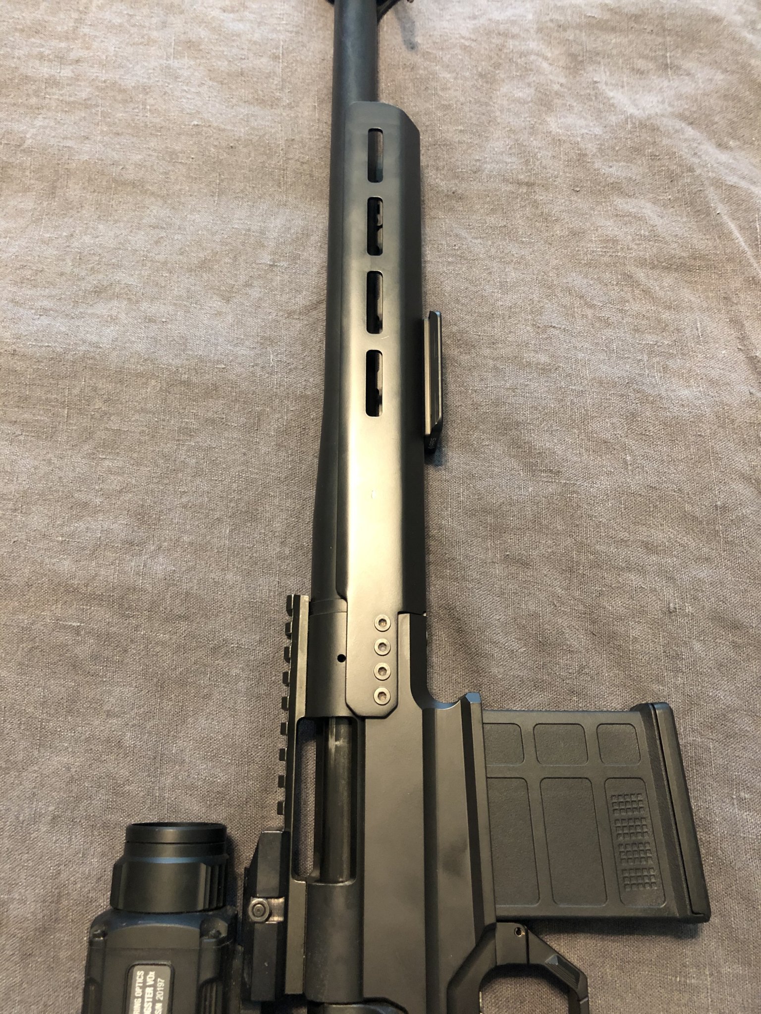

    very nice!.....what grip is on that gun?
    What caliber? How does the stock feel under recoil? Does the hand guard flex?
    sorry for so many questions....I’m just on the fence with this chassis and debating if I should get the manners CS instead
    It’s a 308, dedicated unknown distance thermal night hunting gun. 14.5” pinned shooting 115 Bergers at 2950. The stock is minimalist but has enough adjustment to set it up properly and recoil really isn’t too bad at all. I haven’t had a bipod out on the end to really lean on it, but the rail is pretty solid. There’s a flat spot on the bottom but it’s generally rounded enough to feel good carrying it.
    I even got a lil 2-10 day optic for it during hunting season because I like it so much. It’s shooting 175 FGMM box ammo at 2410 with a suppressor. Good enough for a mini truck gun. I really like it.
