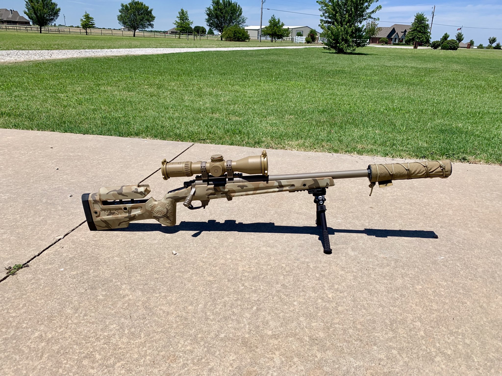

    6 Creedmoor 16.5” Bartlein 1-8 twist
    TBAC Ultra 9 30 cal.
    Berger 87gr VLDH
    Varget 39.5
    ADG LRP brass 3x fired
    FGMM LRP
    BTO 2.131
    3006 FPS avg.
    H 3020
    L 2997
    SD 9.6
    ES 23 FPS
    .256 group at 100yds
    this is max load in my gun. 39.6 showed slight ejector swipe but easy bolt lift

    West Texas Ordnance Switchlug
    Nosler 80gr Ballistic Tip
    Varget 39.8grs
    CCI BR2
    Brass ADG LP
    BTO 2.126
    3083 fps avg.
    H 3092
    L 3074
    SD 7.8
    .241 group @ 100yds
    DA 1998
    Temp. 70
    Alt. 997
    Humidity 42%
    Berger 95gr VLDH
    IMR 4451 43grs.
    BTO 2.138
    Have you loaded any H4350?
    CCI BR2
    Hornady 6 Creedmoor brass
    2846 FPS avg.
    H 2857
    L 2836
    SD 8.6
    .291 group @ 100yds
    DA 1885
    Temp 70
    Alt. 997
    Humidity 44%View attachment 7159987
