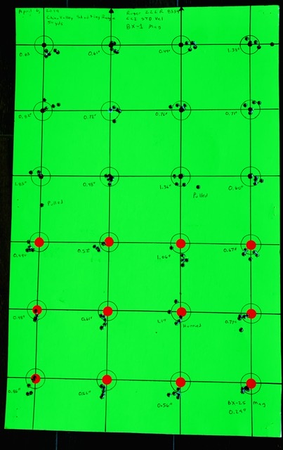

I also like to shoot and try to make tiny small groups. On my T1X I have a 6-24 Bushnell which I’ve only used out to 100 yards.
On my Tikka T3X 223 I have an Athlon 8-34 which I’ve shot paper out to 200 yards. I can still see the bullet holes.
What makes the holes much easier to see is I’m using a fluorescent poster board which I use to place my targets. I also use fluorescent dots which I focus on.
https://www.hobbylobby.com/Art-Supp...-Pacon-Coated-Poster-Board---22"-x-28"/p/4268
Instead of upgrading your scope, I would suggest using the fluorescent poster board and getting a nice spotting scope something like 10x60.
Just my 2 cents from another paper puncher.
