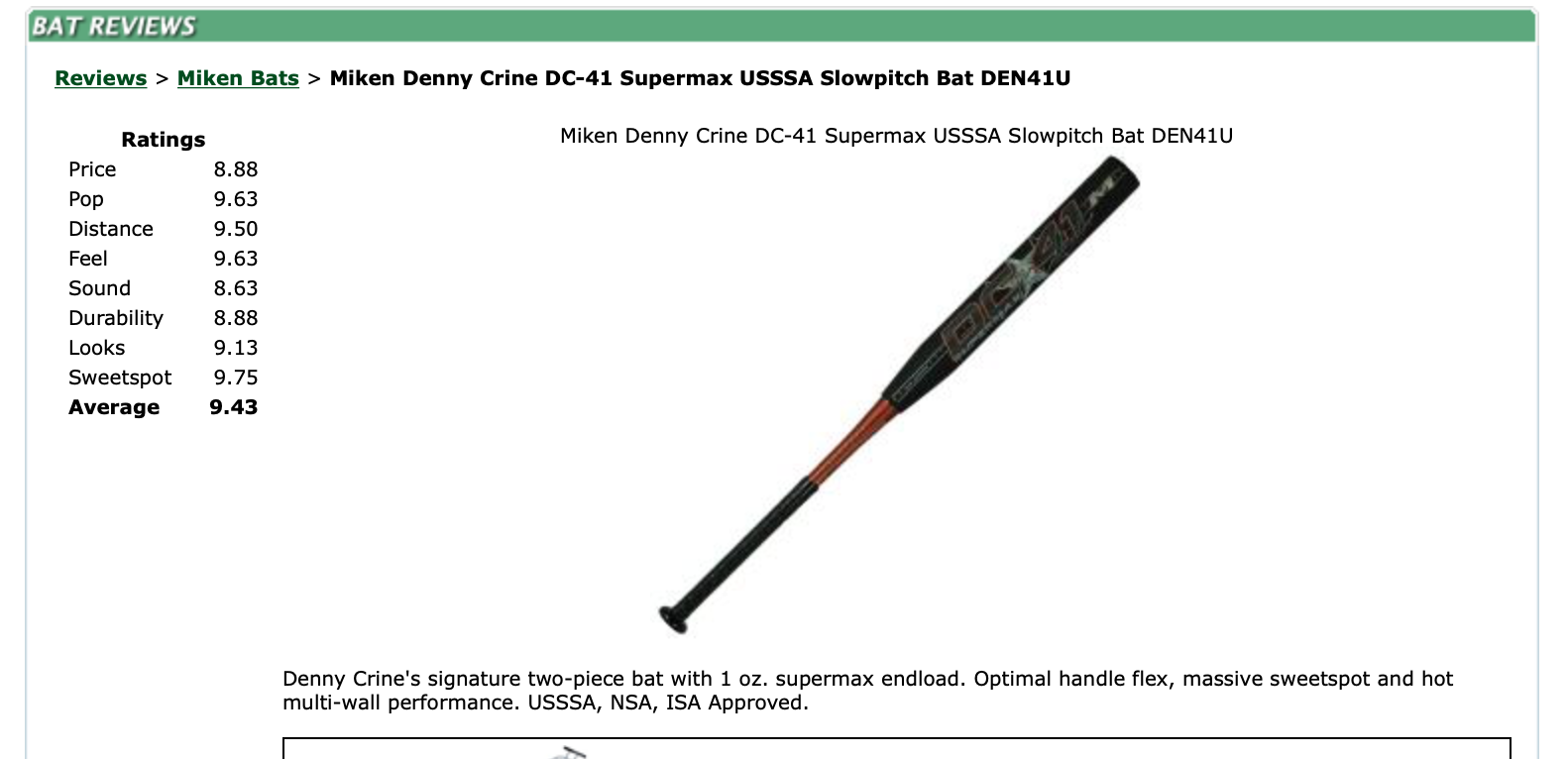

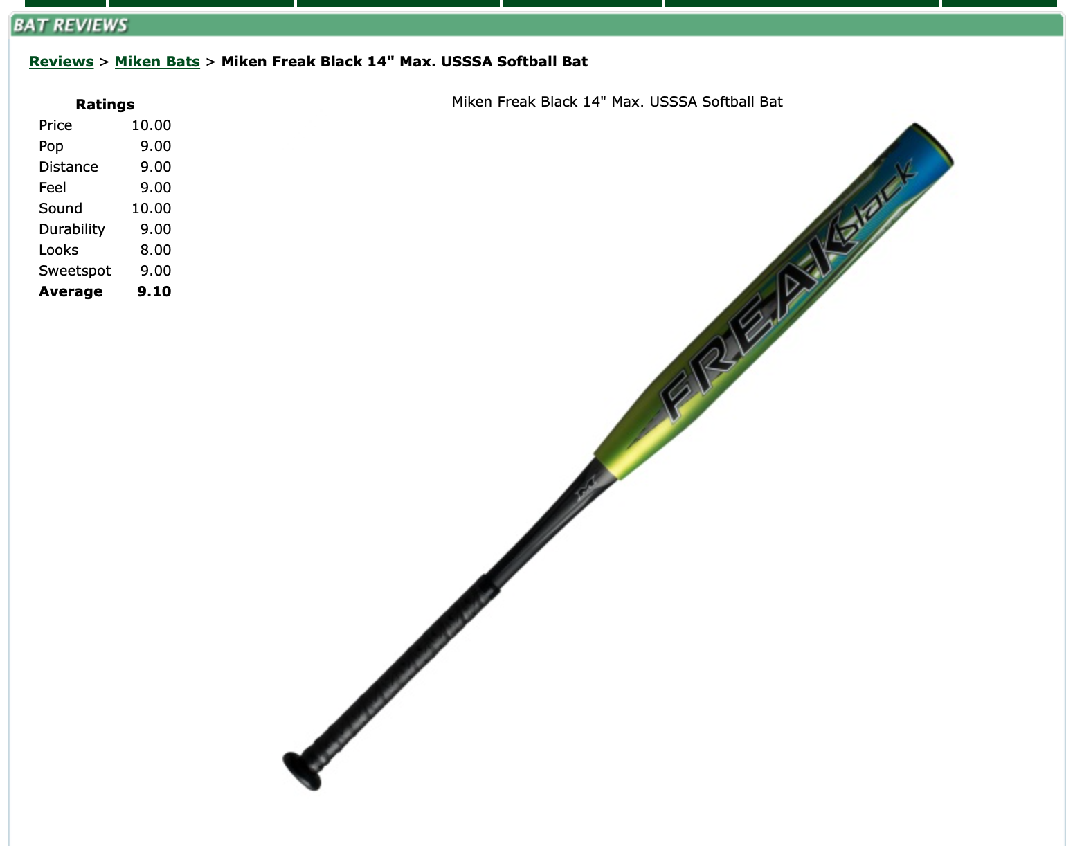

    Look at the softball review posted above,
    See the Ratings, we need this before any of the other stuff, pages, handling, etc, come after
