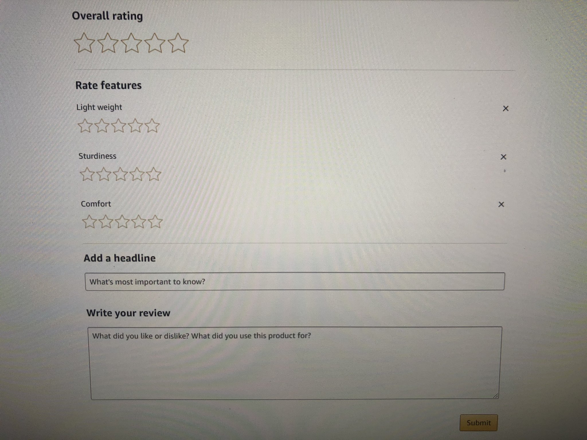

Yes, I think guys are getting it,
Viewing it as a snapshot is a great way to put it, but with that, we want the snapshot image we look at to include certain criteria. That is where the question started.

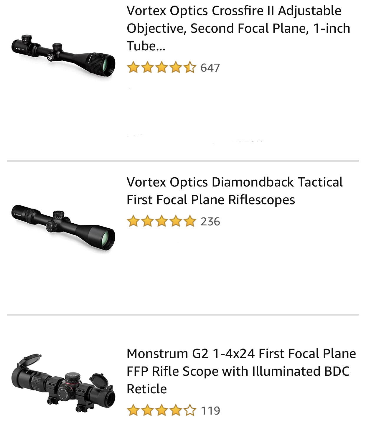

Going back to Amazon again, think about a visual star rating we see today. You scan your search results and see the star rating under them. this is kinda like that, a quick reference for people who understand how star ratings work.
Are star ratings perfect, no they are not, but they help, can they be skewed, sure but anything can. Are they are effective in giving us a snapshot of what others thought about the product we are interested in, yes, I think they help.
@Leftie i like how you proposed the weighting concept for all the criteria. I agree the next step is still finalizing the criteria and definitions of each so they easily and correctly consumed and utilized.
@lowlight the amazon star high level “quick ranking” is a great idea. When we get this all built that could be the highest level view to similar to Amazon(see pic attached). For example the razor 4.5-27 may have 4.6/5.0 star rating which equals a 92/100 overall score. Having each of the 4 categories weighted at 25% of overall score seems right on. By having the star score at the high level it gives a quick scorecard view the user can then click into to see the detailed review. This star approach also wouldn’t clutter the overall ranking of the scopes. Also having the number of reviews submitted along with the star view is helpful.
