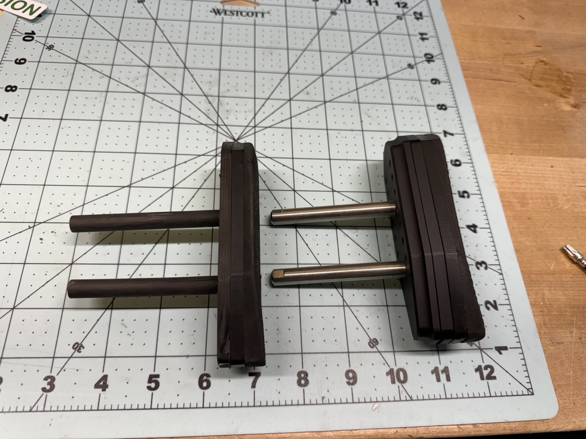

Been waiting on manners to release a light weight adjustable recoil pad. Well, i decided not to wait any longer. Ordered a piece of carbon fiber plate, and some 3/8” carbon rod and made my own. Unfortunately it isnt wicked adjustable like the manners version, but i only make mild adjustments anyway. If one knew how much cant then needed, you could easily drill and tap the correct locations to add the cant you need.
No idea how well it will hold up, but it’s worth a shot.

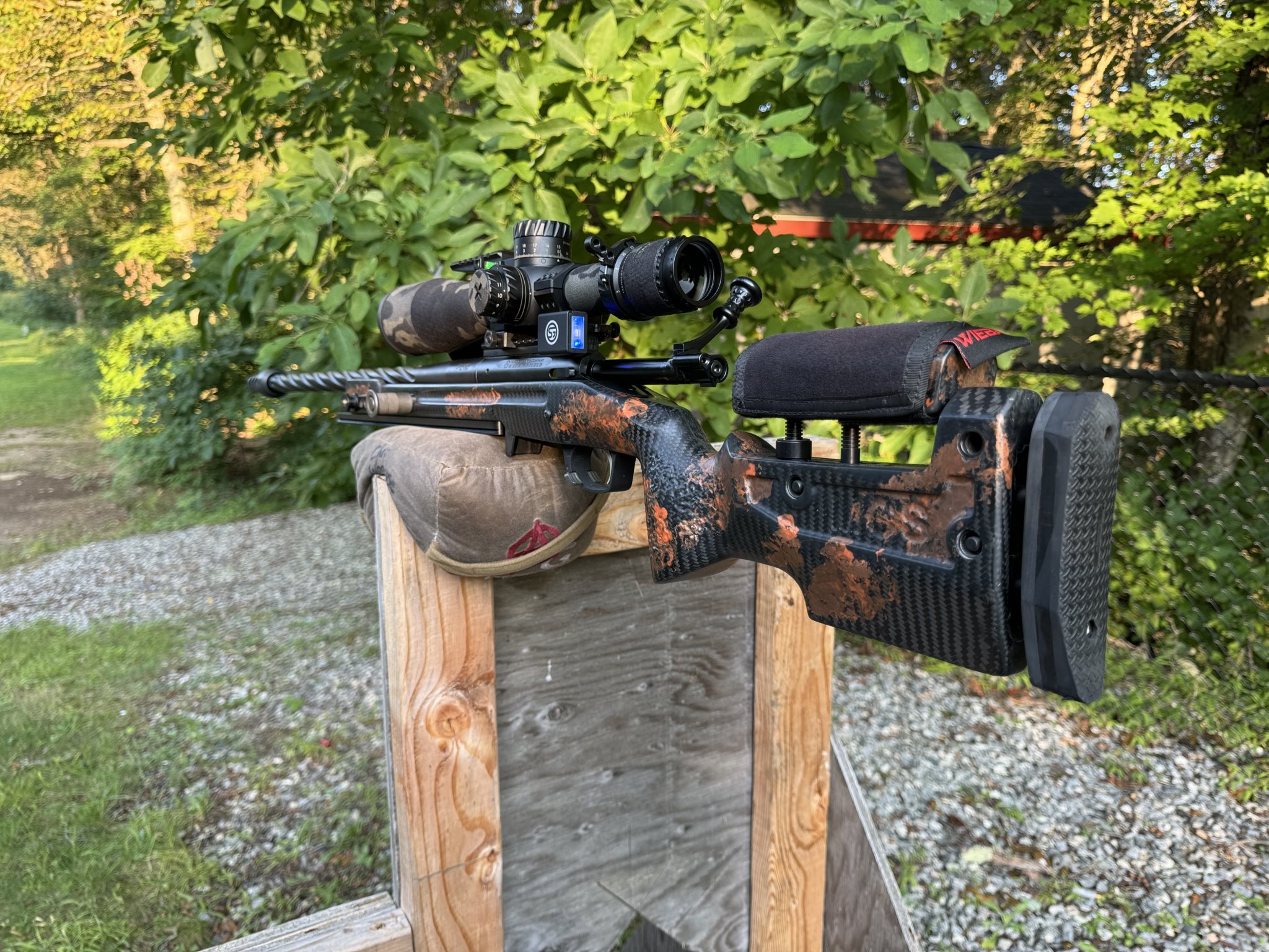

My 6ARC Manners Back in Black build. Some small tweaks I'm going to make are switching to an SP-6001 for the Spuhr mount to drop the scope height a bit I think, putting a 360 precision steel arca rail to get a little more weight upfront and I'm going to drill and tap for a GrovTec flush cup (wasn't a custom order and didn't come with the flush cup up front). Other than that very happy with this setup (y)
Not going to lie, this makes me rethink the choose to get one done in midnight tac instead of back in black

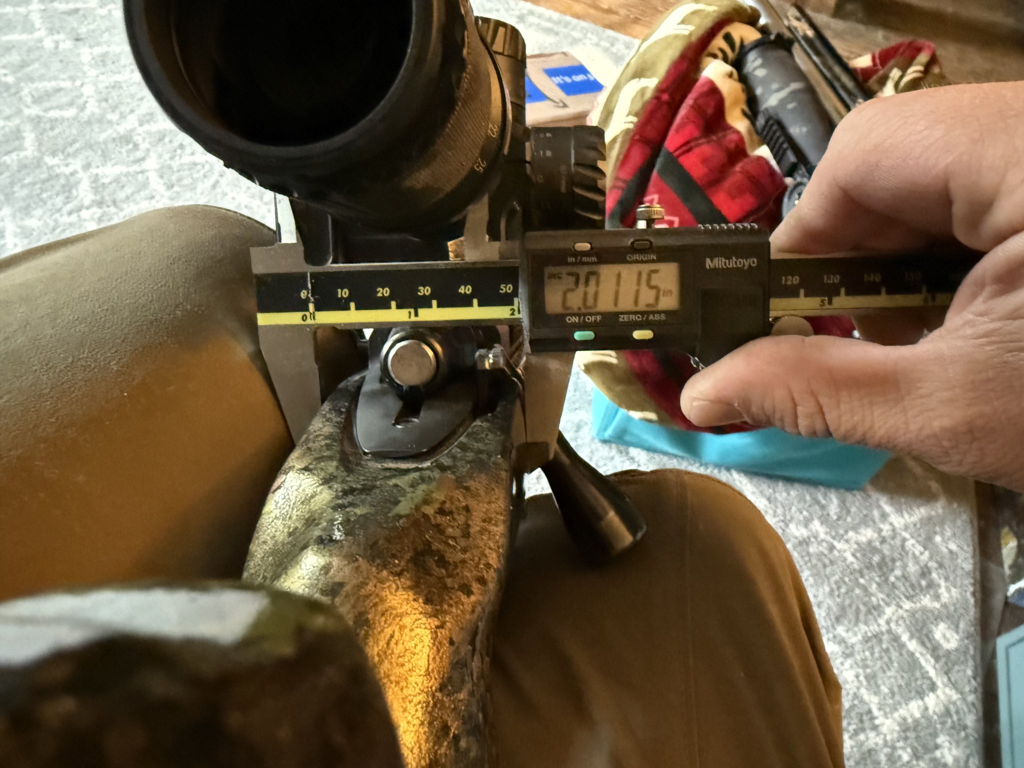

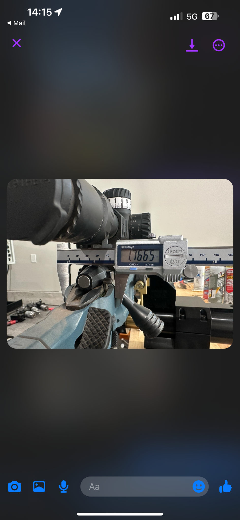

Regarding scope height, I run 1.5" tall mounts on both my current TCS builds with the taller cheekrest columns available from KMW (the design of TCS is actually deep enough you can push the cheek rest all the way down flush with the stock even with the tall KMW columns installed.) I tried 1.25" high scope mounts with the cheekrest lower, and while the 1.25" scope mounts with the cheekrest sitting lower looked better (looks are important, right? lol) I found I preferred the recoil impulse and head/neck position with the taller 1.5" mounts... so my cheekrests are still raised way up and looking somewhat goofy. Everyone is different though.
I might go back to the 1.5" at some point but would definitely want some more adjustability on the riser. Unfortunately the taller KMW hardware is out of stock currently. With the 1.18" Spuhr on there it definitely feels a little less topsy turvy for me and it drops me into a normal range of adjustment on the riser. Both were plenty comfortable, just sitting it higher was almost chin-weld city and it felt a little top heavy moving it around on the bipod and whatnot. It feels nicely balanced now.
I tried a 1.5" high mount and felt it was too top-heavy as well (at least with a fat Razor, a lighter scope might be better). I didn't like the way the gun sat and tracked on a bag under recoil with the taller mount.
For me, mounts at 1.25/1.26" feel best on the TCS. YMMV.

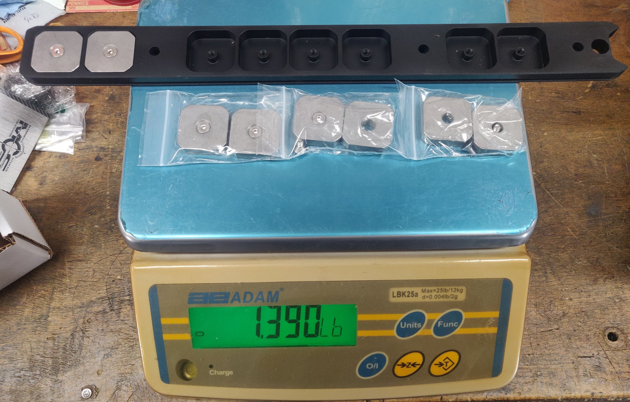

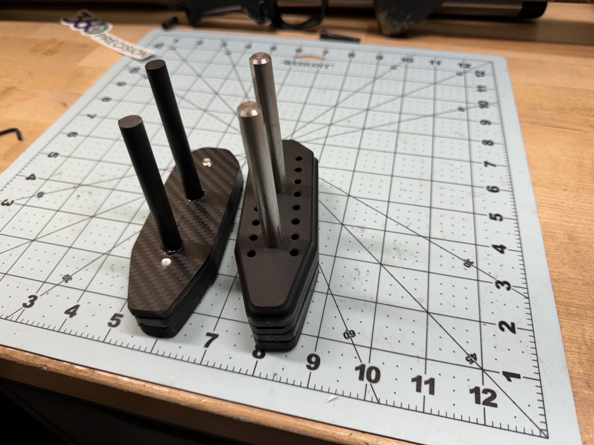

So IDK what the deal is with Manners' heavier steel "MAX rail" for the TCS, but it's starting to seem like it's never coming out... I emailed their CS a few weeks ago about it, and they said they have no idea when it's going to be released.
I already purchased the 1.2lb front stabilizer weight thingy and 6 of their square 1.8oz weights that fit their newer non-A419 aluminum rail months ago (to have them on hand to play with once I got a hold of one of the MAX rails), but they've just been sitting on my bench collecting dust since I don't have the newest rail.
I run the OG steel rail that they no longer offer with all of the steel weights inserted and it weighs 2.6lbs and I am 95% happy with how my gun feels and balances at ~22lbs with a fat pig Razor G3 on top.
That said, I would like to push the weight more out front toward the muzzle as I like the way that feels a bit better (having experimented with stacking a bunch of wheel balancing weights out front on the rail before).

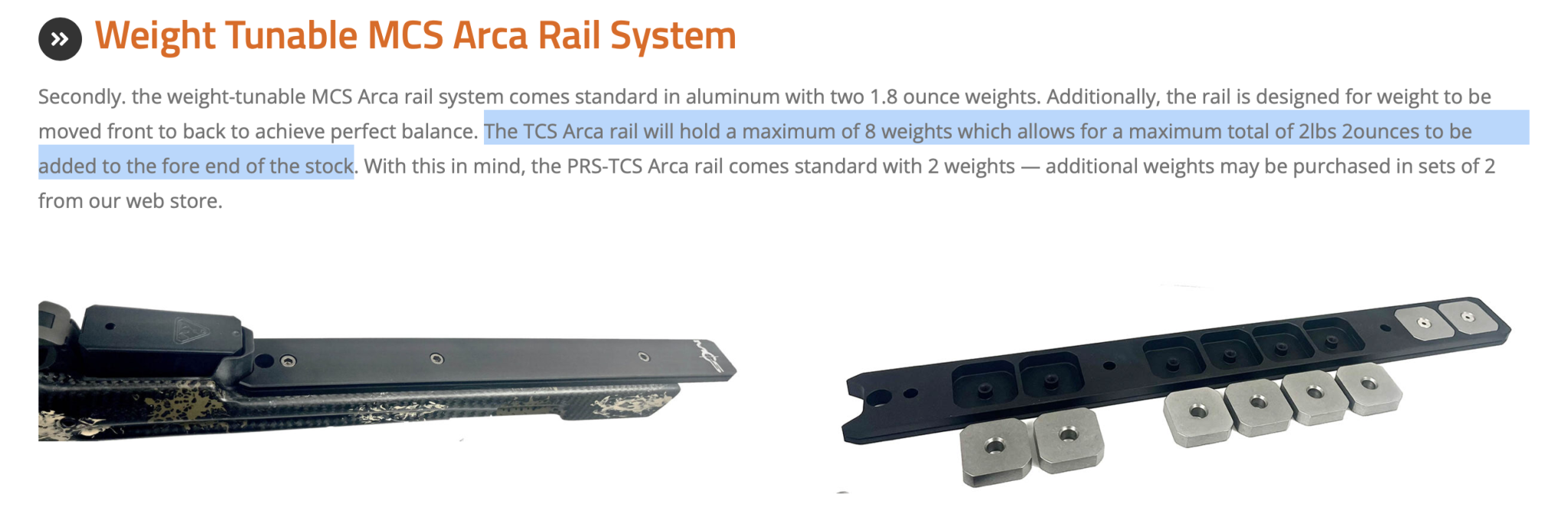

Allegedly (from Manners text on their TCS page on their site) the newer aluminum rail that takes the square weights weighs 2.2lbs... but I kind of find that hard to believe since my OG steel rail weighs 2.6lbs (and steel weighs A LOT more than aluminum).
Can someone who has the newest aluminum arca rail like in the pic below help me out and confirm what it weighs?
Theoretically, if it weighs what they say it does, I should be able to just order one of the newer rails and bolt on the front stabilizer thingy and end up where I want to be at around the same weight as I'm running now or a little more just pushed forward.

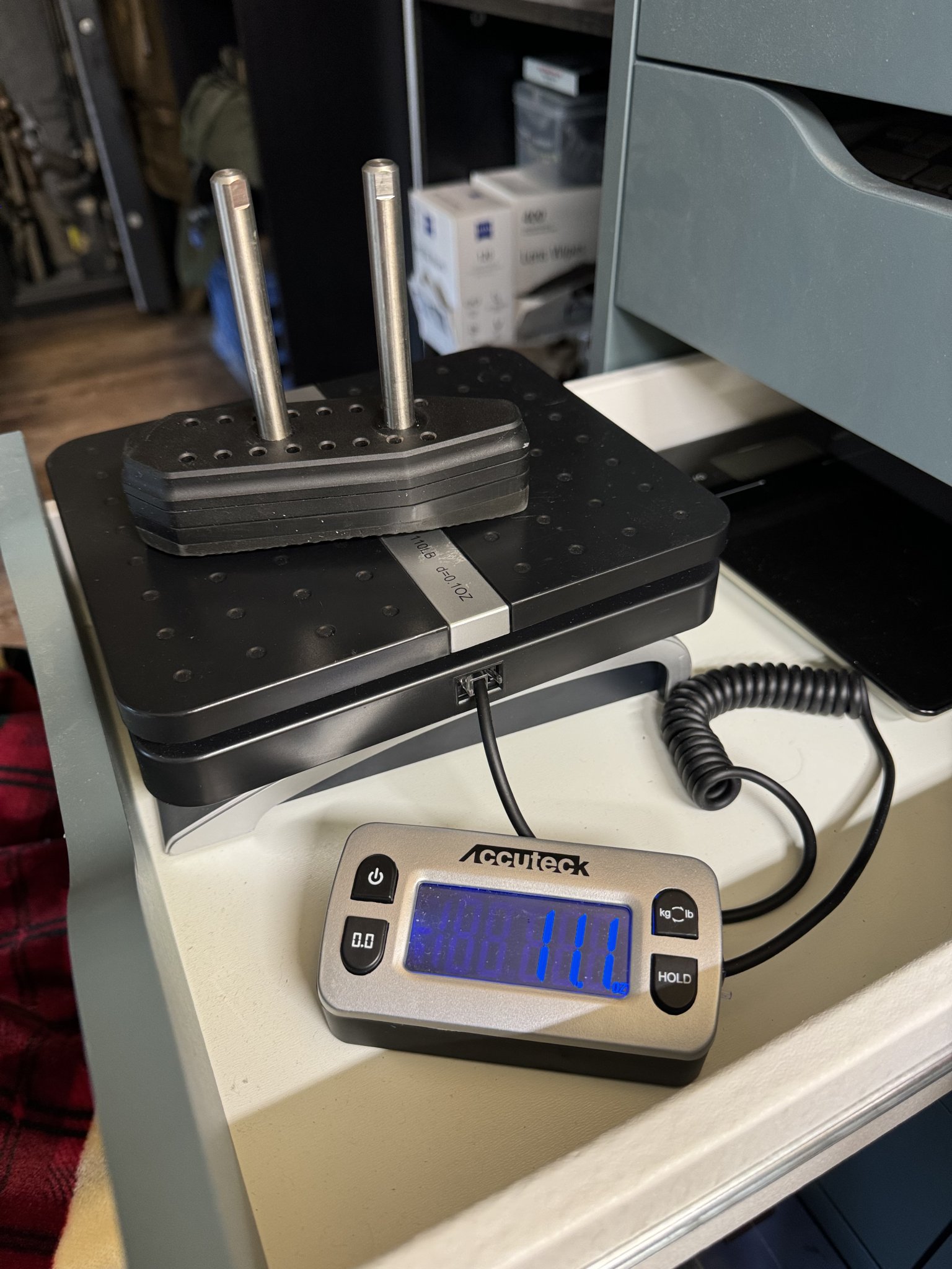

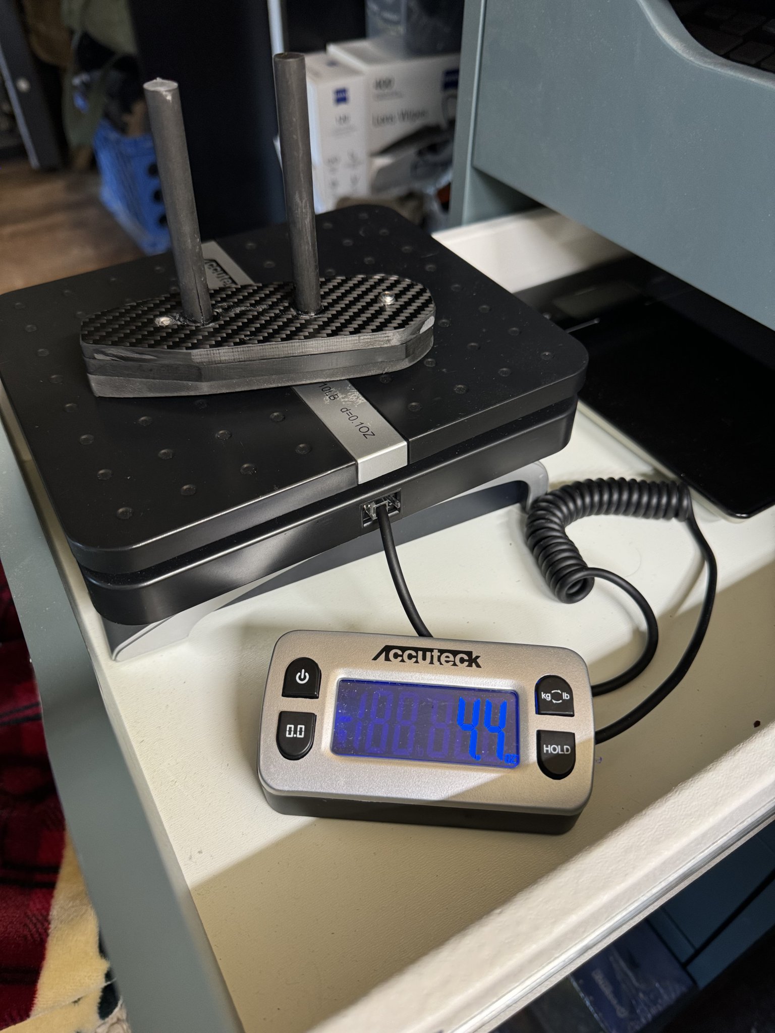

Had to do some digging to find it since I immediately replaced it with a 360 precision steel rail, but here's the latest version aluminum rail with all the weights...
360 precision steel rail weighs right about 40oz, and I believe the OG steel rail on my oldest TCS with all the weights comes in right about 37oz.
