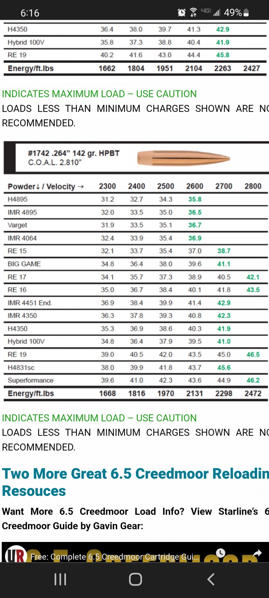

Going from 140 Berger Hybrids to 142 SMKs.
Any advice on how much to start off at? Bergers I am getting ES of 6, SD of 3 and a mean of 2725 @ 42 GR with Lapua LRP and Fed 210M primers.

Sierra load data for 6.5 creed and 142 smk. Not hard to find. But you have yet to say what cartridge you are loading for.
His jump and COAL doesn't represent anything for your gun. Hopefully you're measuring your current jump based on BTO measurements you have taken for your chamber. Measure the BTO of your current load and start there if you want to keep the same jump. SMK's are typically pretty jump friendly.

Ok, hit the range.. and lets say... I wasn't that impressed and a bit, well, confused.
I hit the range with the 142s and found this;
Shot4141.341.641.9
12737ERROR27962836
22734269627862861
327242747ERROR2773
MEAN2732272227912823
ES13511088
SD6.8136.067.0745
The errors were my fault. I haven't used a Magneto chronograph in about a year and I forgot I had to keep adjusting the device or it continues to slide after a few rounds due to the recoil.
After my first shot at 41, I got a sticky bolt. Having gotten up to 2700s with the Bergers I was perplexed. I ejected the round, then every round afterwards never had a sticky reaction after that.
I might have to start lower than 41 and work my way up, what do you think? In comparison, this is what I was getting with the 140 Bergers;
41.241.541.541.84242.5

I am very meticulous with my rounds. I use a single stage press with an electronic scale and forrestor dies and take my time from the first round to the last.
Suffice to say, I was a bit over the place with the SMKs.
Just so everyone sees what I am working with;
6.5 Creedmoor
Lapua LRP
H4350
Federal 210M
First graph is 142 SMK, second is 140 Berger Hybrids. (Which I am trying to get away from and transition to SMK)
Agree with all that's said. . . good advice.
However, the emphasis on "jump" tends to distract reloaders where it's really not so important as seating depth. If I change bullets and use a current load, I want to start that new bullet with a seating depth that's the same as before regardless of the bullets BTO or bearing surface length (as long as it fits without touching or jamming the lands). 🤷‍♂️ I guess it's just become a pet peeve of mine that so many new reloaders are led to focus more on jump than actual seating depth, when seating depth is so much more important than jump. 🥴
Agree. Once you get a bit away from the lands, jump doesn't affect pressure much, but increased seating depth reduces case volume and that can have significant affect on pressure and velocity. Its difficult to test jump and velocity nodes at the same time, but ultimately you have to get both right.
