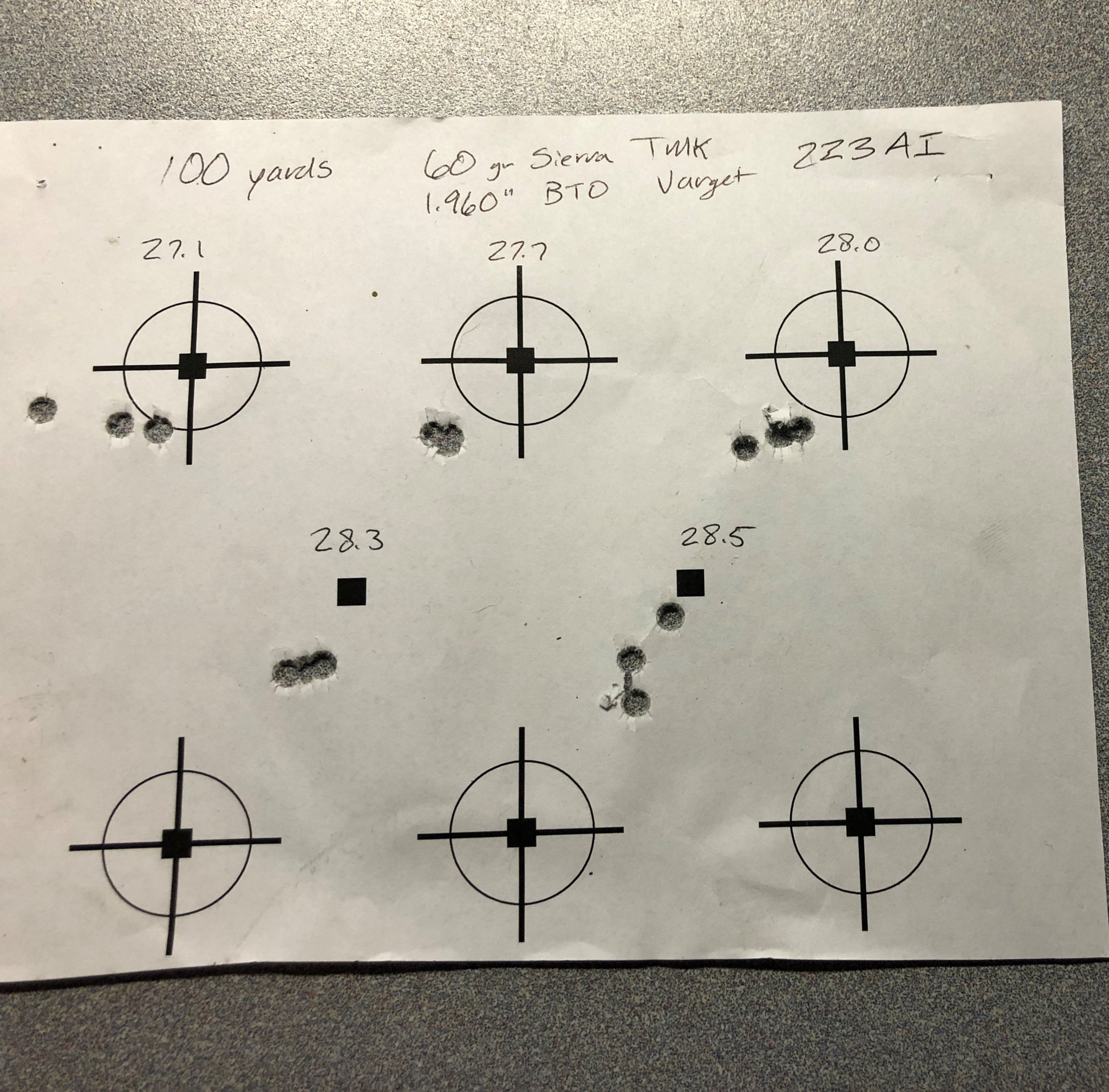

Figured I'd bump this. Did some load development with the 60 TMK in my 223 AI. Will need to redo chrono on them as I can't find the data, which was needed anyway as I only used 1 rd every 2-3 increments for a general idea. Trying to get some final loads figured out. No highly noticeable pressure signs on these with my Origin, although I could trick myself into thinking the CCI 450s were just a hair flatter on the final load, can't tell for sure.
Sierra 60gr TMK
Varget
CCI 450s
2-3x Formed LC15 brass
1.960" +/- .002 CBTO
26" 1-8 CBI, 223 AI
Origin Action with Razor Gen2
Shooting off bipod and rear bag
***Edit - found chrono:
27.1 - 3306, 3284
27.4 - 3335, 3326
27.7 - 3357, 3361
28.0 - 3387, 3415
28.3 - 3427, 3432
28.5 - ?
POI seems to be very similar at 27.7-28.3 gr. Should have went in 0.2 gr increments, but maybe next time. I'd like to just redo 27.7 and 28.3 gr and confirm seating depth, but something tells me maybe I should try out 27.8/9 and 28.1/2 to make sure I'm within that node going forward. Obviously, I'd like to be on the faster side, but wanted to see what you all thought. Thanks for any insight.

I agree with you, no point in going AI if you aren't gonna run it. I don't think there is a node all the way through 27.7 to 28.3, but I bet there is one between 28-28.3-4, the velocities for 28 are half one way or the other, maybe some kind of transition zone, or just a fluke like a weird primer etc, but 27.7 and 28.3 are 60fps apart, do you want that 60fps cause 27.7 looks magical

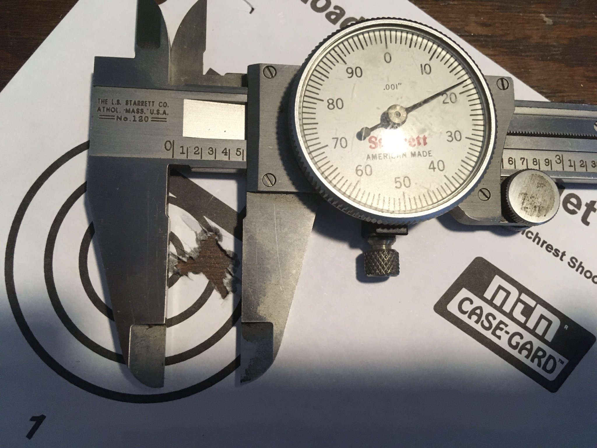

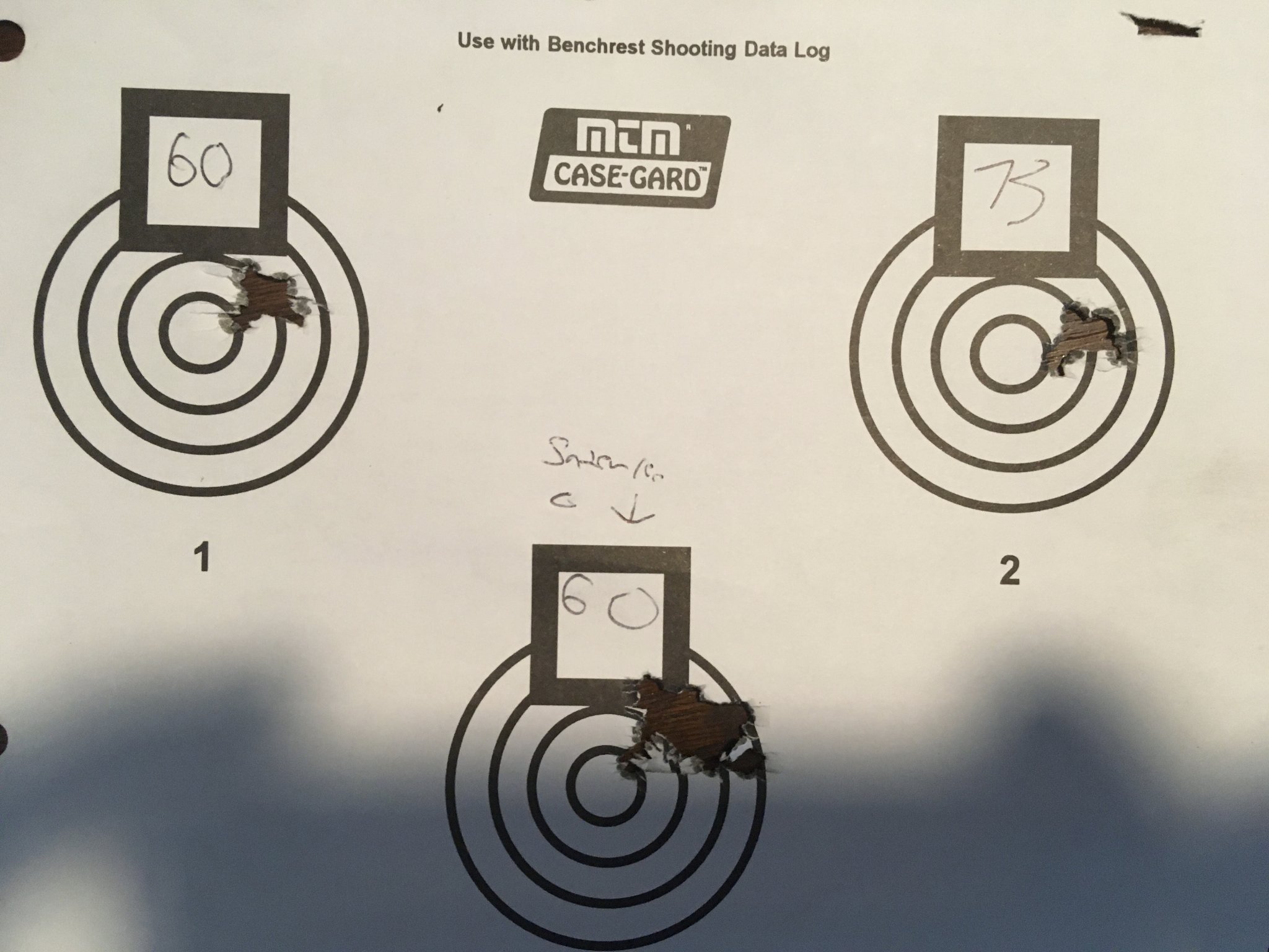

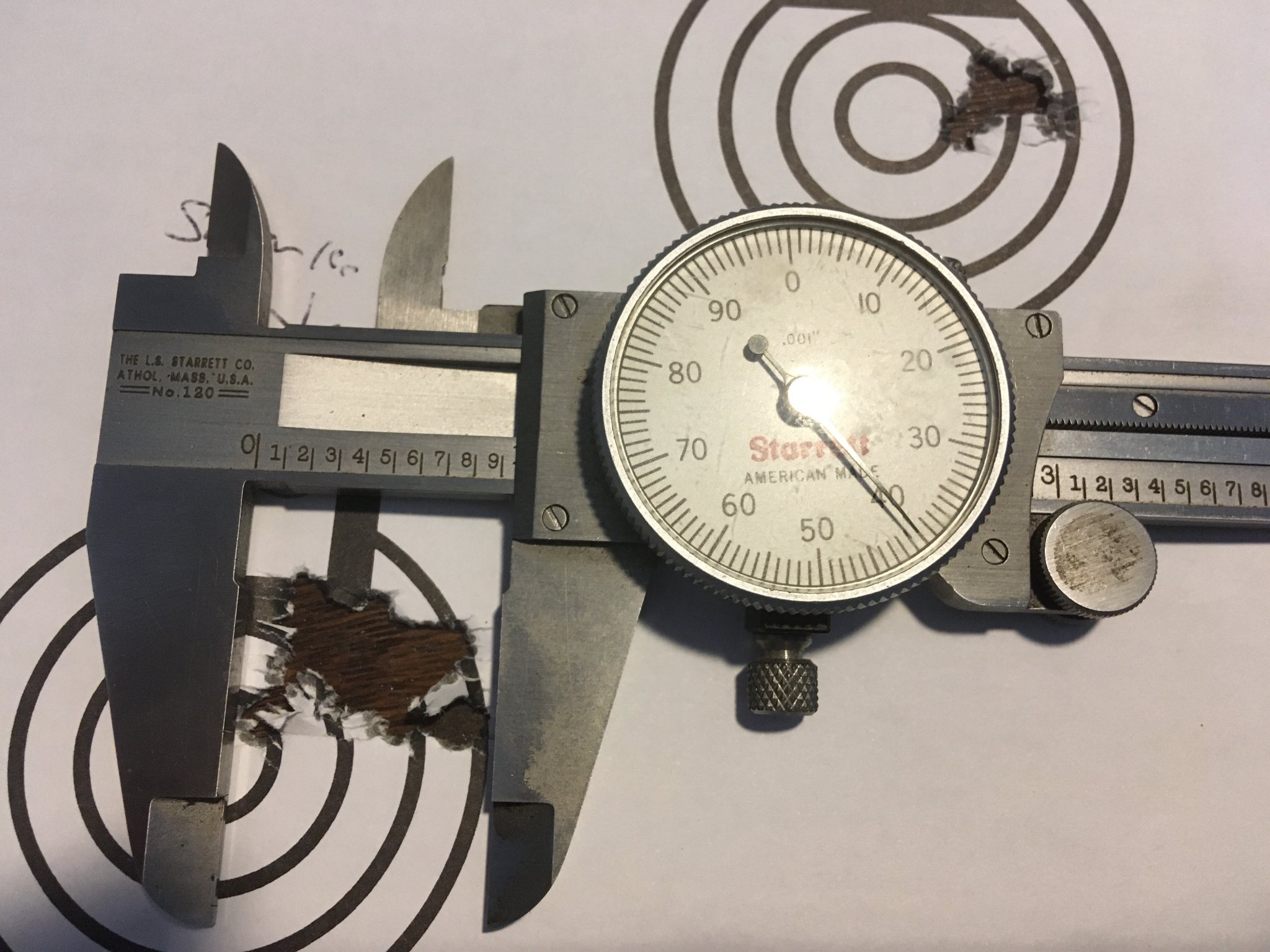

So I shot these today, might have pulled off one of my smallest groups ever, i also did a 14 round saterlee in .3 gr increments and that group was right at an inch, I'll measure them tomorrow and post em, amazing bullets.
Here is my 15 round saterlee, the top right group were to see if my 1:9 would stabilize horandy 75'sD3E7DAFE-959E-4A86-86C6-D3538468CD45.jpeg
After getting my chrony data I had 5 rounds I loaded up with 23gr of varget, they were slow but that's okD2B49B7F-8229-4FE2-A71D-BA92B3645539.jpeg
