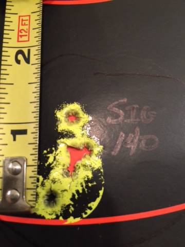

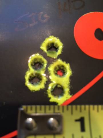

I have had very respectable results with Sig 140gr Elite ammo.
No experience with the SIG 762G2
100yds , benched , scoped, bagged front an rear.
PSA / DC Machine barreled 20" 6.5CM upper....Before True and gluing the barrel
After truing the upper receiver and "glue" ( loctiting the barrel in )
