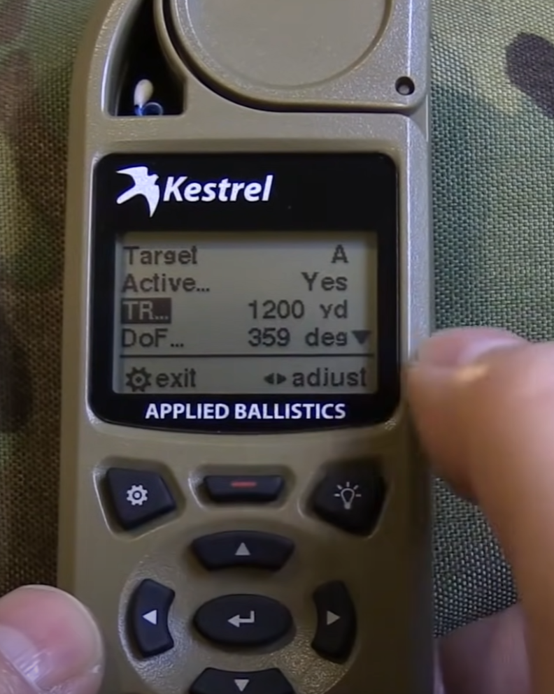

I'm assuming you have a Kestrel weather meter that has the option to set up multiple targets. In the target menu, you need to make sure each target is active. Enter "Tgt" then at "Target" scroll left or right and click enter to activate targets. You will capture ranges for each target at the main menu or manually input range and "DoF" (Direction of Fire). I'm not sure if the Sig Kilo 10x has a built in compass to auto-populate the DoF; if not the DoF for each target would have to be done via the Kestrel.

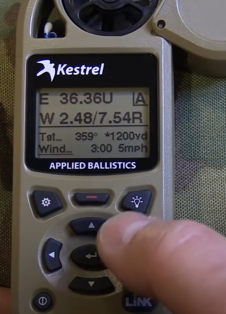

The top right corner which target solution you are currently viewing. Example pic - Target A. To scroll through targets to see solutions, at "Tgt" scroll left or right.
If you have more than 10 targets. You would have to set up a new Sector. Scroll down to "Target Card..." click enter. Click enter on the highlighted sector. Scroll up to "Sctr", scroll left or right til you hit "NEW SECTOR", click enter.
