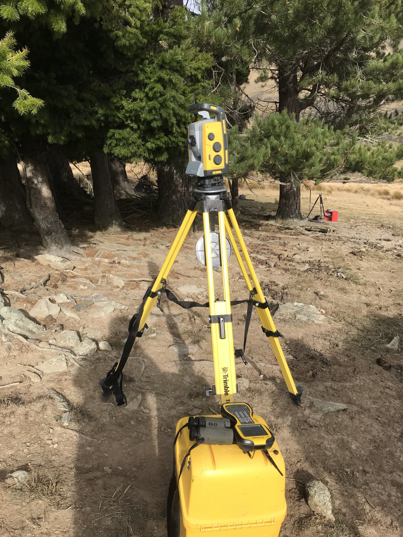

I tried these out here in New Zealand on a local match a few weeks ago. One of the guys attending is a Surveyor by trade so we checked them against his laser equipment, or as he put it “the truth”.
They are within .8m accurate to 4000m which was the furthest we could range. When connected to a 5700 elite we were getting solutions as far as we could range.

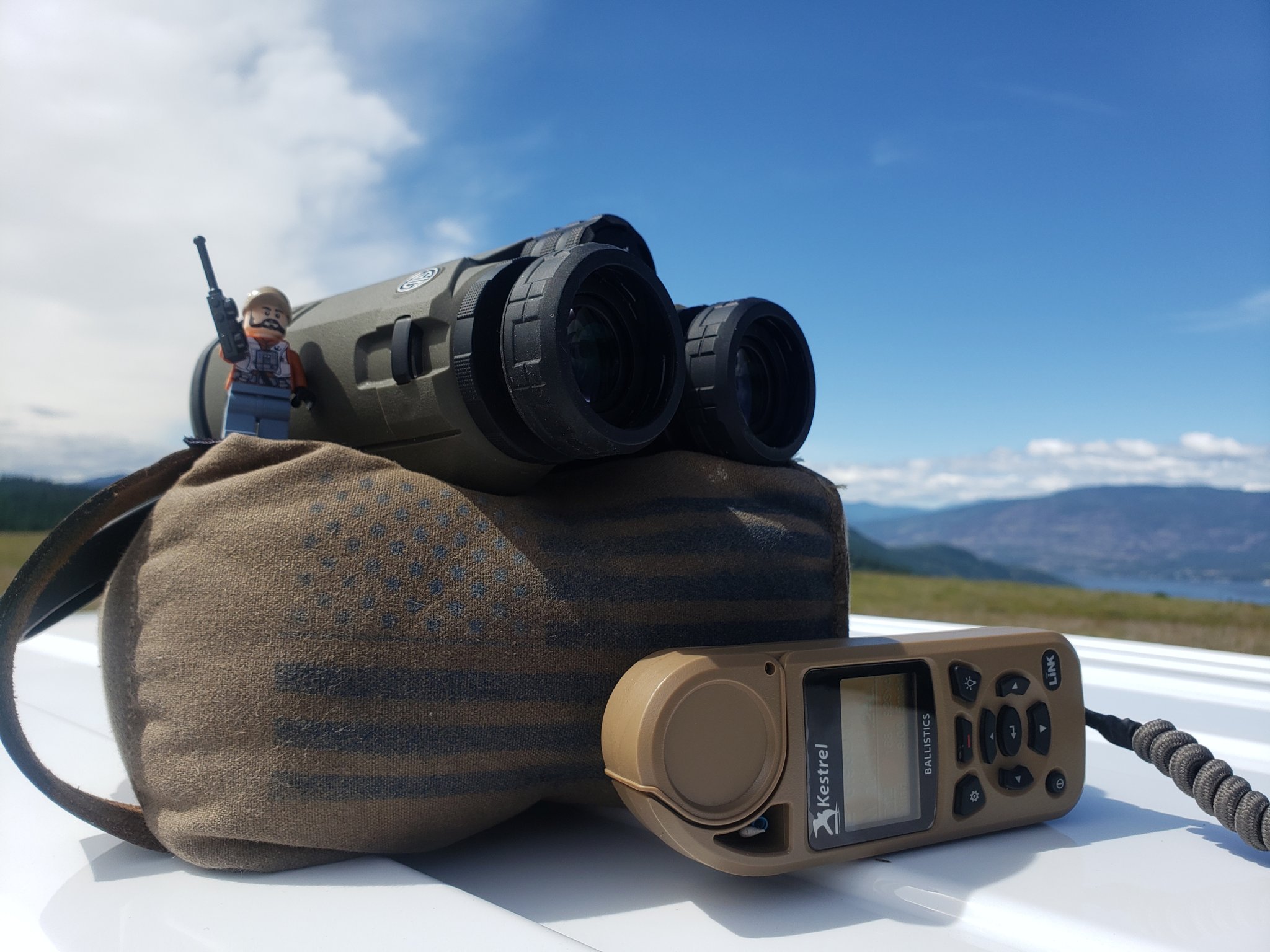

After playing around with my shooting partner's K3000 BDX I ordered a set for myself. Got them in time for this past weekend's Snipershide Cup. On the way there I was offhand ranging rocks at 2550+ yards. With both my partner and I using them at the match, they really helped with our workflow. We'd just split up the targets and range them and since we each had ours linked to our Kestrels and have matching dope, it was really fast. I also hand problem ranging the longest target of the weekend (1445 yards) through some morning cloud/fog.
I did notice the diopters constantly coming un-adjusted during the first day but that was solved with some electrical tape. I'll be ordering the correct size of Butler Creek caps for both the ocular and objective ends.
As an aside, I also got a Hill People Gear heavy recon kit bag and attached their medium bino pouch to the front of it with a single mag pouch on either side and ran that all weekend instead of my usual battle belt. The Binos just fit in the pouch and it was a nice setup for such a tripod heavy match, nice having some admin stuff, kestrel and the binos right up front and not too bad when prone.

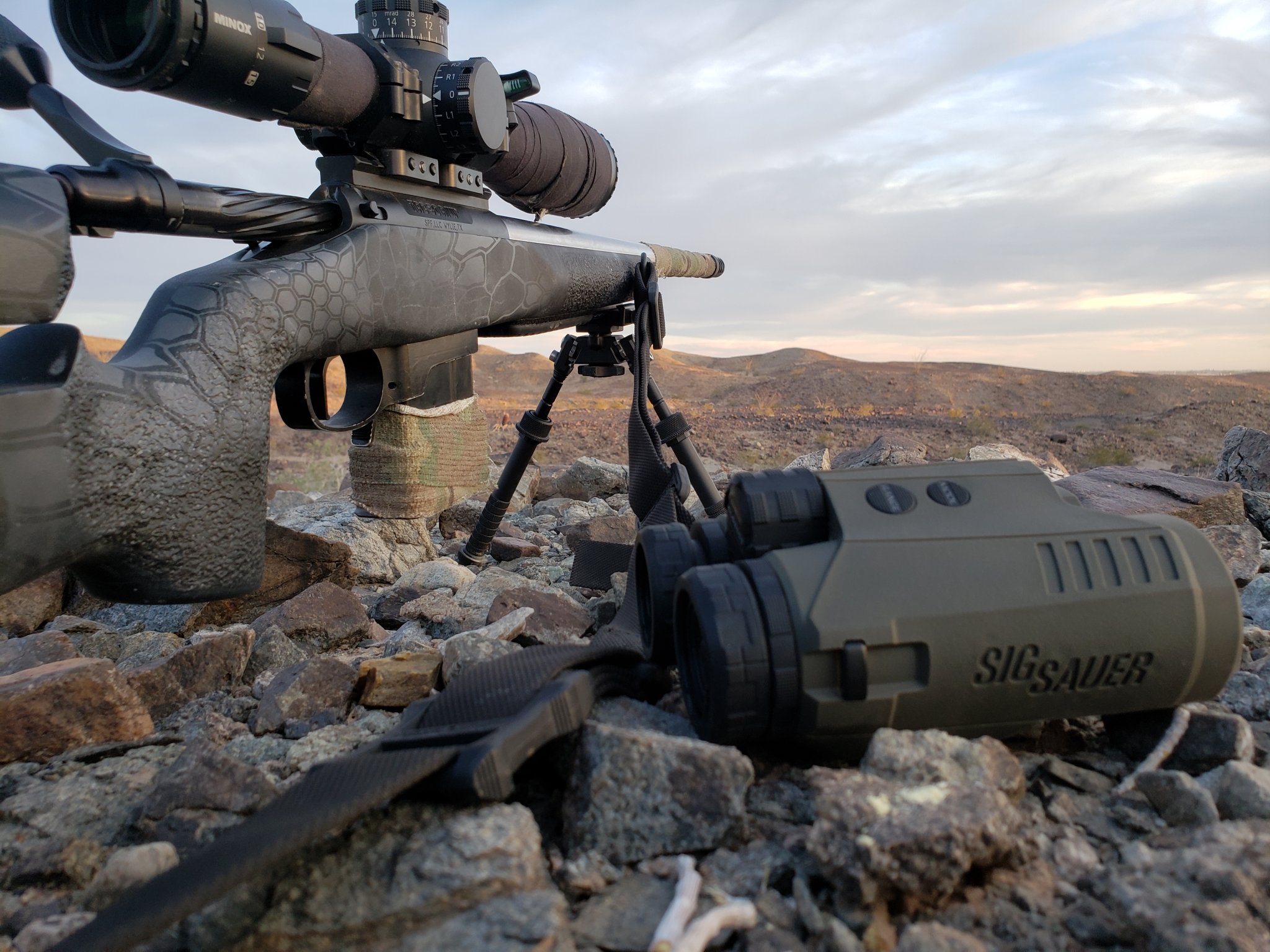

Since I work on UH1Y I figured why not side my side compare them to a FLIR Brite Stsr Block II
They matched exactly with one another out to 3,665 yards in the middle of the desert. I ran out of thing to target
