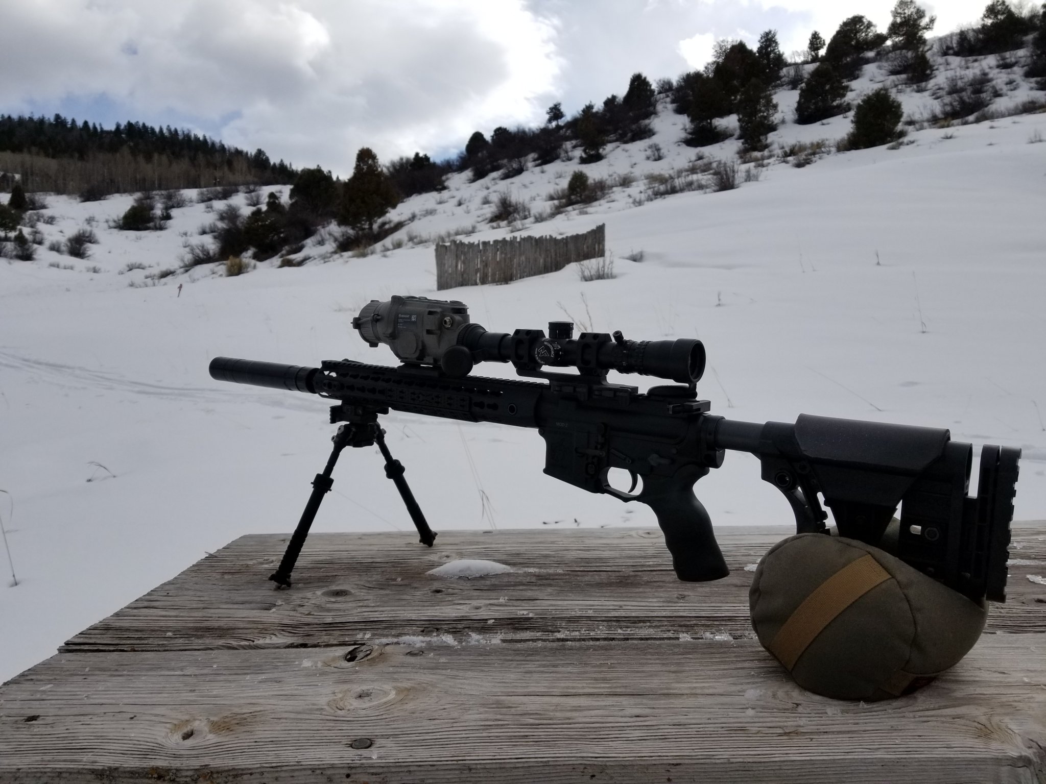

I was finally able to get time to sight in my new-ish LWTS that I bought a few weeks ago at MHSA. Apologies for my ignorance - is there any reason why I can’t sight in during daylight hours? I started on paper - in the foreground - and then went to steel - the two plates in the background are 4” and 6”.

No reason at all, I zeroed mine in daylight. You will typically get better contrast on standard black and white targets in good sunlight since the black portions of the target heat up a bit more than the plain white paper. Congrats on your purchase, they are great scopes. The controls are just so well thought out and yow that sexy image :p

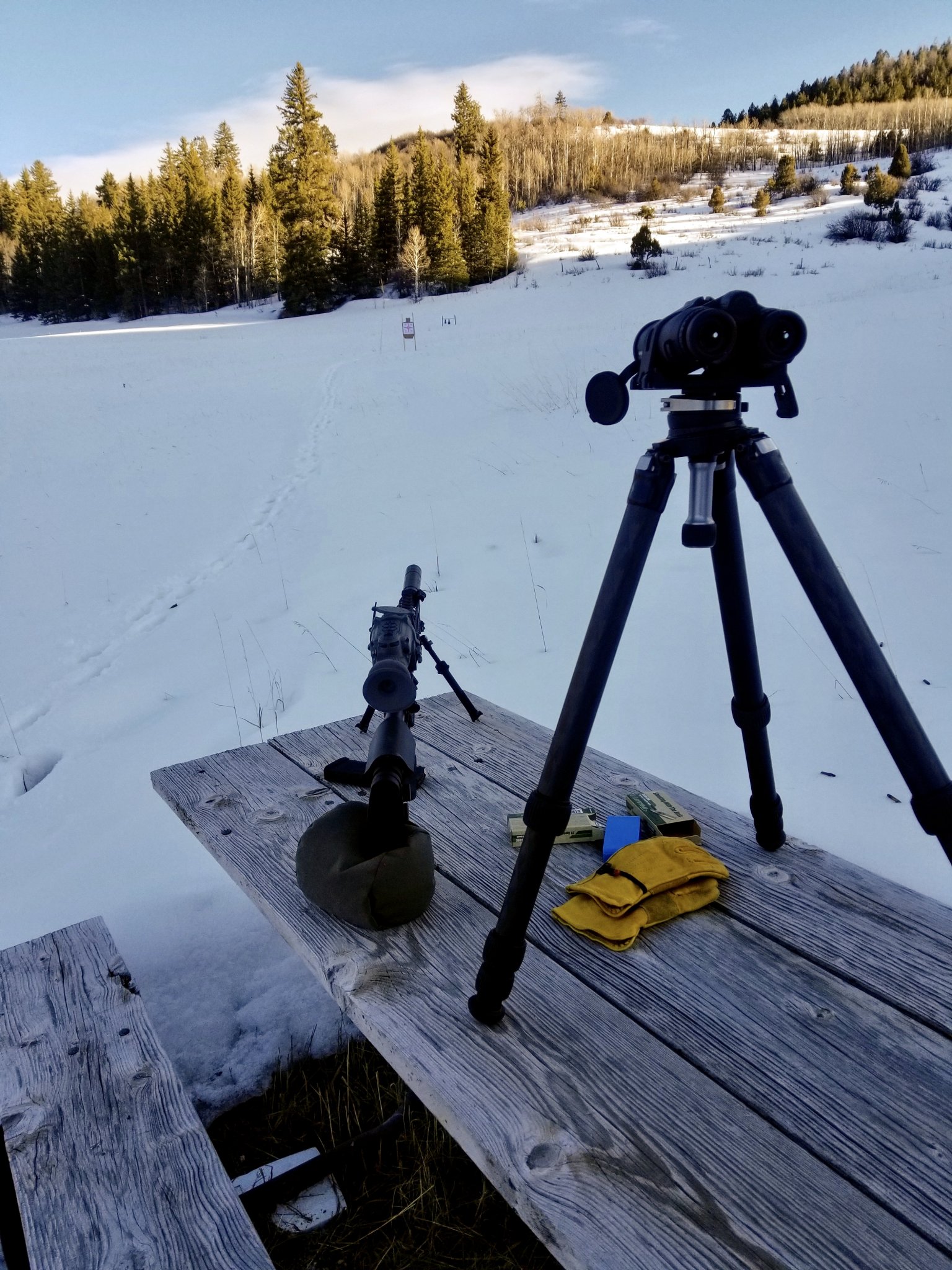

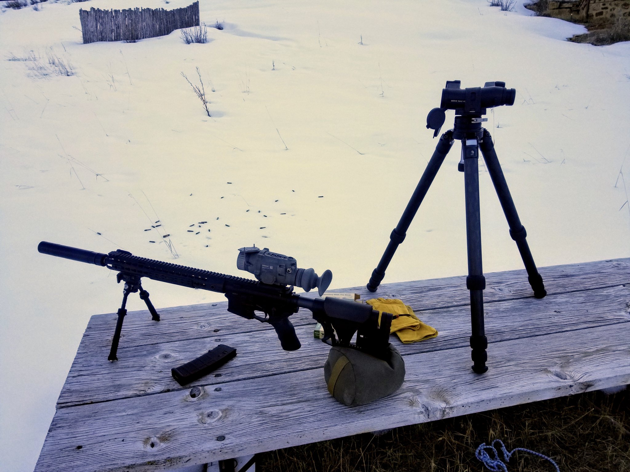

Got the LWTS sighted in with my NF 2x10 - 24. Was surprised how easy this was to do.

Maybe he meant he was measuring the POI shift? If so, I did the same thing when I got mine. Aside from the tiny vertical offset caused by the periscope design, the POI shift was negligible. Great scopes, I loved mine.
Reason I ask is I am experiencing a substantial impact shift with mine. I’m assuming it’s something simple, but I haven’t figured it out yet.
Well, it does look like with the LWTS in front of the NF I am about 1/2 mil high - is this typical? I double checked the NF and it’s spot on. I do need to get back and double check the LWTS as a dedicated unit - I think it was also a bit high - I had to hold low but I don’t know by how much because the manual doesn’t have any info on the M4/M16 reticle. Any ideas?
