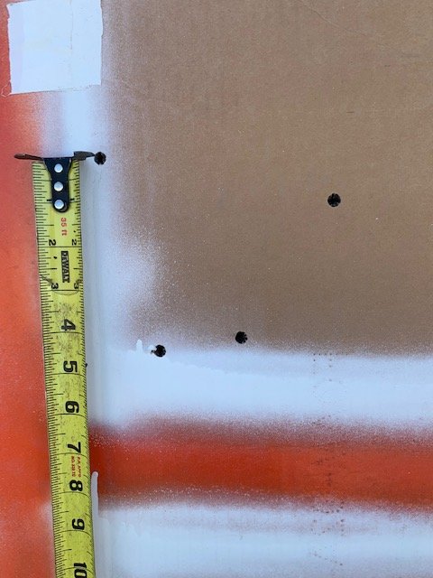

I did my ladder at 300. It shot under 1.5" (three shots) twice with the load I decided on so I moved to 810 yd to see what it was doing. I didn't get a picture of the first two tries at 810 yds, but here is a 5-shot group that was about 5.25" of vertical spread.

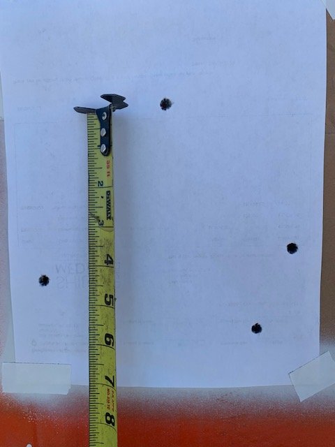

This was yesterday (only four shots) with the seating depth reduced by 0.015".

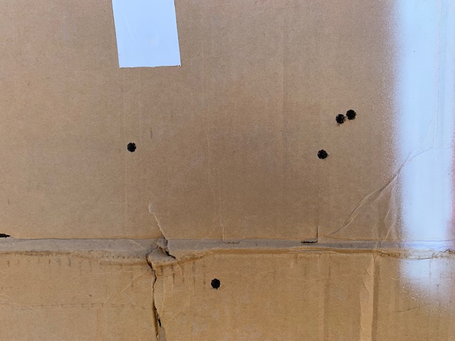

And another four shots with the seating depth reduced by 0.030" from the original load. I'm not sure what to make of these groups.
I've recorded the velocity of every shot. I'll go back and see what it is across all of the shots I've made at distance. Thanks!
