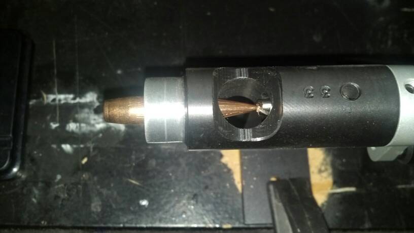

I just bought one to trim my 338 Berger otms with and it's a joke! The bullet holder doesn't "hold" the bullet. It merely stops it. When i insert the bullet and go to turn the trimmer the bullet just wobbles around, catching on the cutting blade. It will eventually chip of enough but it's such a cumbersome and barbaric process that i could nearly achieve the same thing with a pocket knife.
Am i missing something? There is no taper in the bullet stop to match the curvature of the bullet so I'm wondering if it just missed a step in the machining process?

ETA - Just watched your video. There's something wrong with yours or you have the wrong bushing. Mine is nowhere near that loose; I couldn't try and do that with mine if I wanted to.
The box says 338 caliber and the bushing says 33 on it. Pretty sure it's the right bushing but may not be machined right.
Good to know it's not me then. Guess I'll give Sinclair a call, although that'll Probly be more hassle than just doing something to fix it. Either take a tapered reamer to it (right now it just looks like a drilled hole with no taper) or epoxy a bushing (bored to like .339) to it to hold the bullet centered.

Nah, easier to just fix it...
