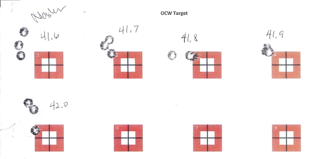

Dan, I had to update this thread based on information you provided for Nosler brass back in February. I asked what the node load should be with IMR4064 and you replied for Nosler 41.8gr. Based on that info I decided to run a little mini OCW test for 41.6 to 42.0 in .1 gr increments.
Ran it today and the results are below. Dan, I do believe you were spot on!
Velocities - 22" barrel
41.6 - 2442, 2415, 2455
41.7 - 2446, 2464, 2469
41.8 - 2482, 2473, 2482
41.9 - 2492, 2496, 2510
42.0 - 2487, 2515, 2506
Average fired case capacity 56.7gr water
Cool. That means your chamber is dimensionally similar to a Remington factory chamber and will yield similar water capacity values for the brass.
To me it looks like Nosler brass is similar to Federal Gold Medal even though it weighs less.
