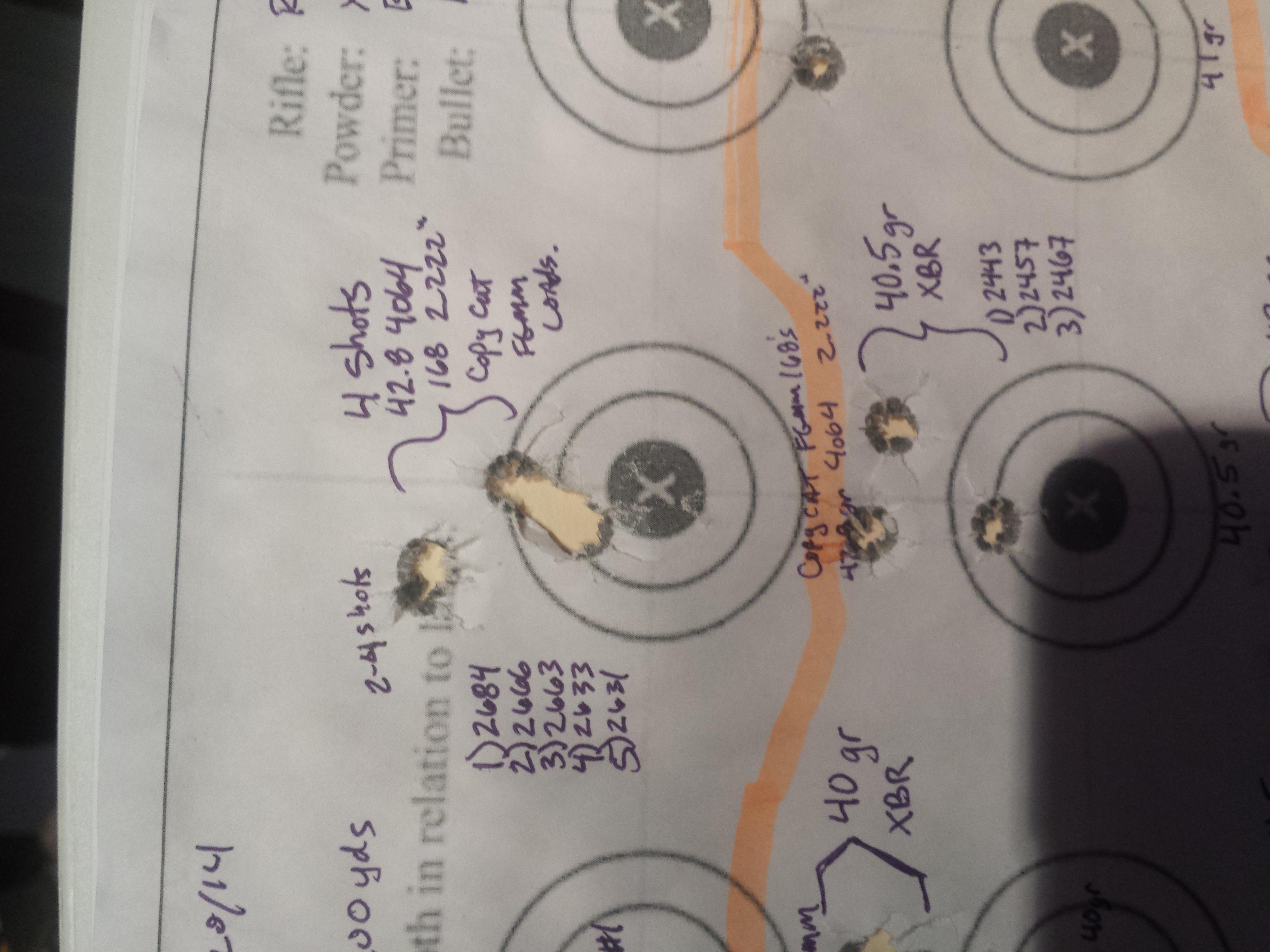

here is my copycat loads. They were better than the factory loads! The 1st shot was a sighter shot. Had very bad crosswinds with pouring rain. Looks like These loads are legit!!!

When I was chasing the 168 FGMM load a few years ago, I knew the powder was IMR 4064.
Now the most interesting thing I have noticed is that the 168 FGMM does NOT use a Federal Match Primer. I punched the primers out from a few different lots over the past 3 years and they appear to be the regular Large Rifle Federal primers. There is no red-yellow look to the primers in the FGMM. I once heard a myth about the FGMM using a gold match primer not available to reloaders.

For the 168, the 42.6gr IMR-4064 load sounds about right; my load for the 175 is 42.2gr IMR-4064. I just use WLR primers; consistent enough and very positive ignition. All my 308 loads, when I had .308's, were made from Rem brass. Factory ammo is often made with the same primer they sell for reloading, but sometimes they don't nickel plate them. If plating on primers is anything other than cosmetic, you could fool me...
