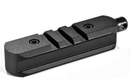

Many factory rifles come with the old sling studs, which I completely hate and have utterly no use for. To me it's like drilling a wood screw into the stock for no reason. All of the good slings I use for competition are on QD. Only my hunting rifles have slings that live on them where I don't mind these studs.
In the past I've removed the studs, drilled out the holes, and installed GroveTec flushcups. This way I can use the rifle for silhouette and off hand matches with a sling, but also remove it for Base Class positional shooting.
My LGS that focuses on ARs found these:
I'd never seen them before, but they're a great idea if you have no use for sling studs and they require no modification to the gun. I ordered a pair, and my only reservation is that they may annoy me, flopping around, went the sling is off...but we'll see.
Warne 7953M SLING SWIVEL Accessory Rail $56.99
Unless I totally misunderstood what you’re after…
I would also prefer the flush cups than someone screwing a wood screw into my stock, period. However, on the CZ 457 AT-ONE the rear sling stud is in the plastic housing that covers the adjustable comb and stock. Getting that to look professional and factory is going to be hit or miss. I haven't removed it and I kinda don't want to. Rather than deal with that I can snap one of these on and go. The front stud is getting a flush cup..
