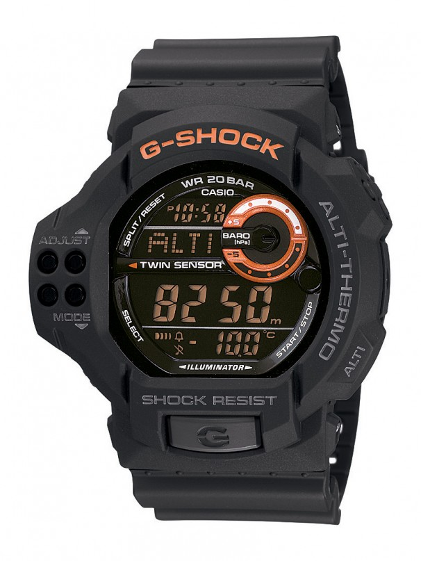

    @Skookum may I ask which G-Shock you use? I’m a watch fanatic.
    GDF-100, probably the cheapest one with twin sensors.:LOL: I'm probably due for an upgrade. I want a Riseman or something similar.
