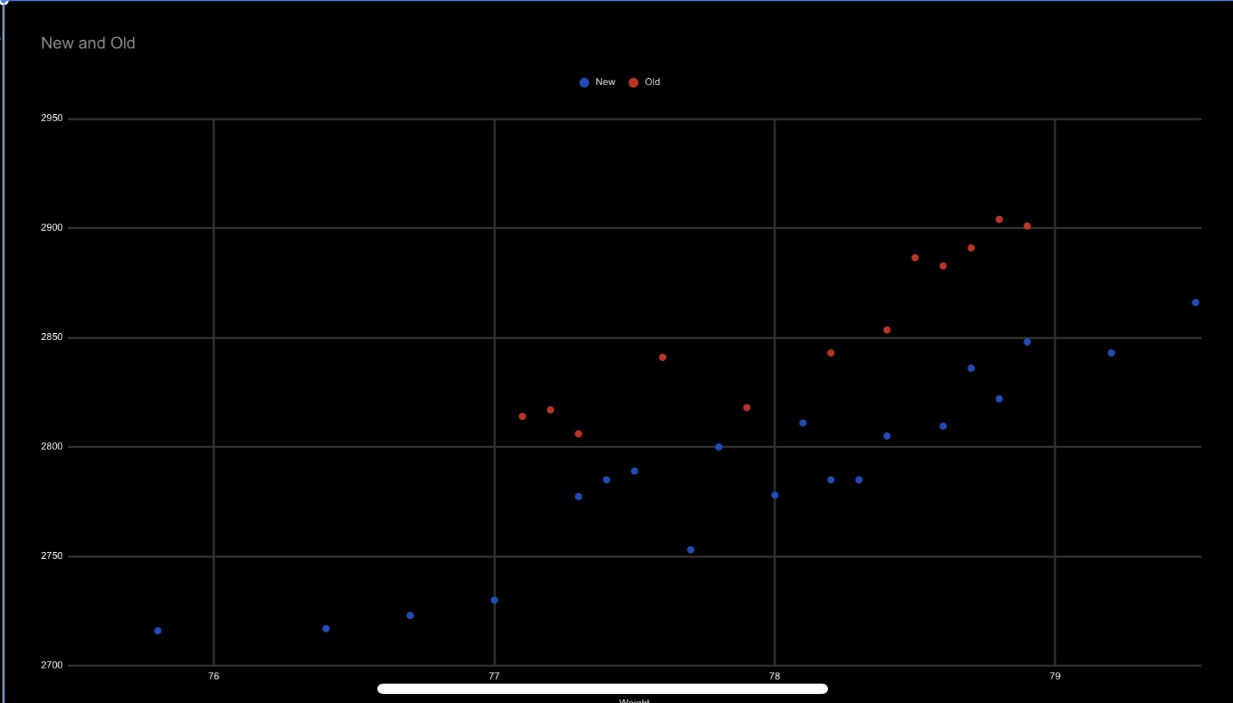

Not to dig up an old thread, but here is some data about that. Blue points are from fresh powder, red points are from just a few days in my autotrickler hopper. I live in Colorado and it’s winter here, very low humidity dries this powder out pretty quickly evidently.
This is 8133 in a 300 PRC.

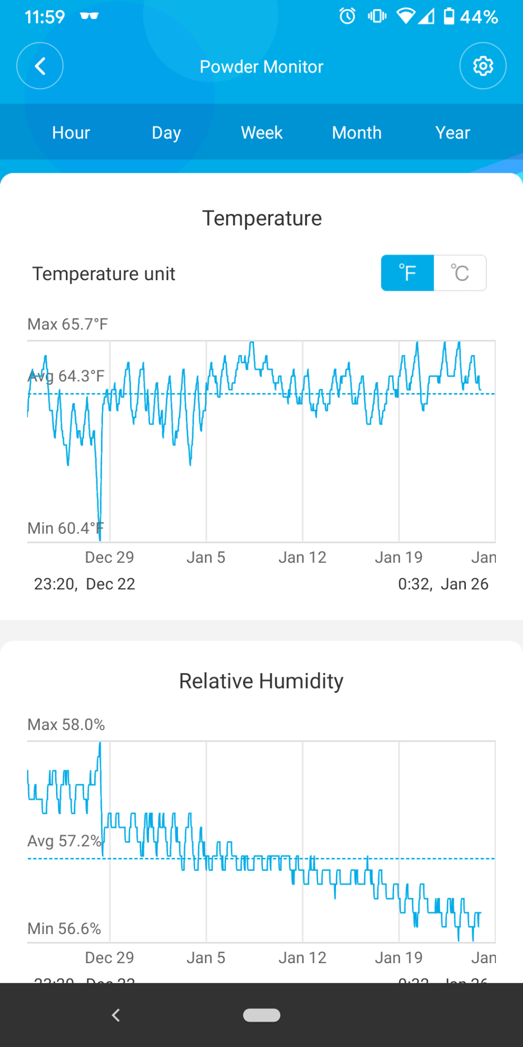

Another data point. "Sealed" containers aren't exactly sealed either. Also in Colorado, but in a climate controlled (humidity included) house. In the basement, so a little more temperature fluctuation. This was a fresh 8 pounder of H4895, opened only to drop the wireless sensor in and then sealed back up. 5 ish weeks of data here so far.
