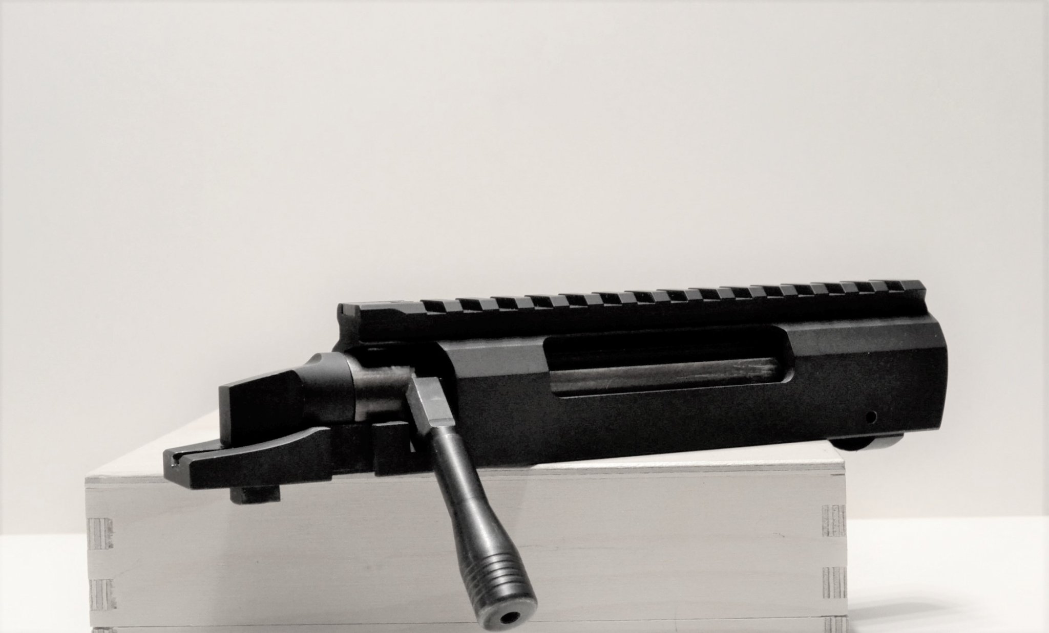

    Well I figured with everyone going off about someone not having any details or pics of their upcoming new product release, lol...
    Figured I would play the exact opposite side of the coin and just drop picture hint with the full alloy details.
    NOTE: We are not entering the receiver market at this time...only production weapon systems. (Reasoning will be released soon :))

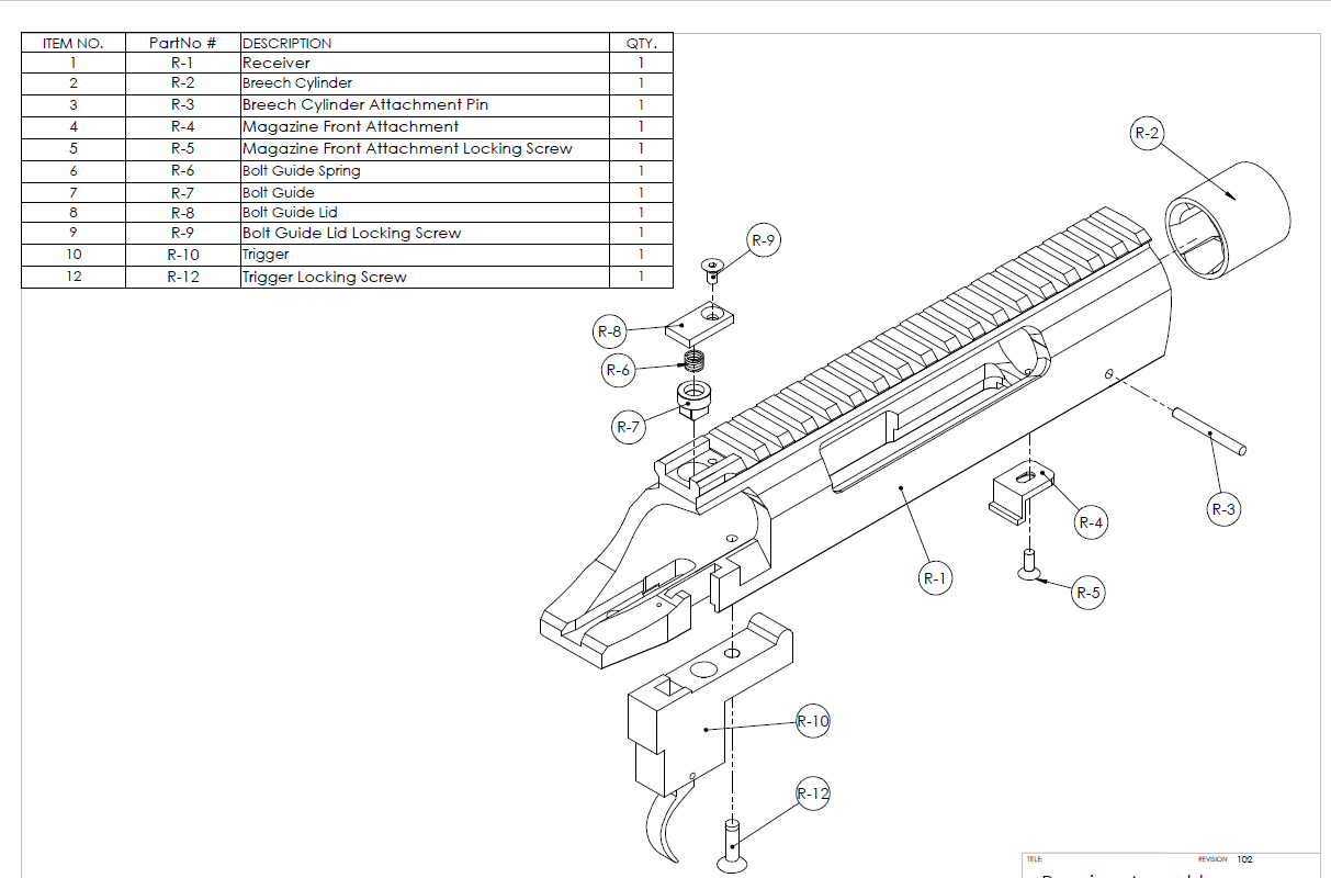

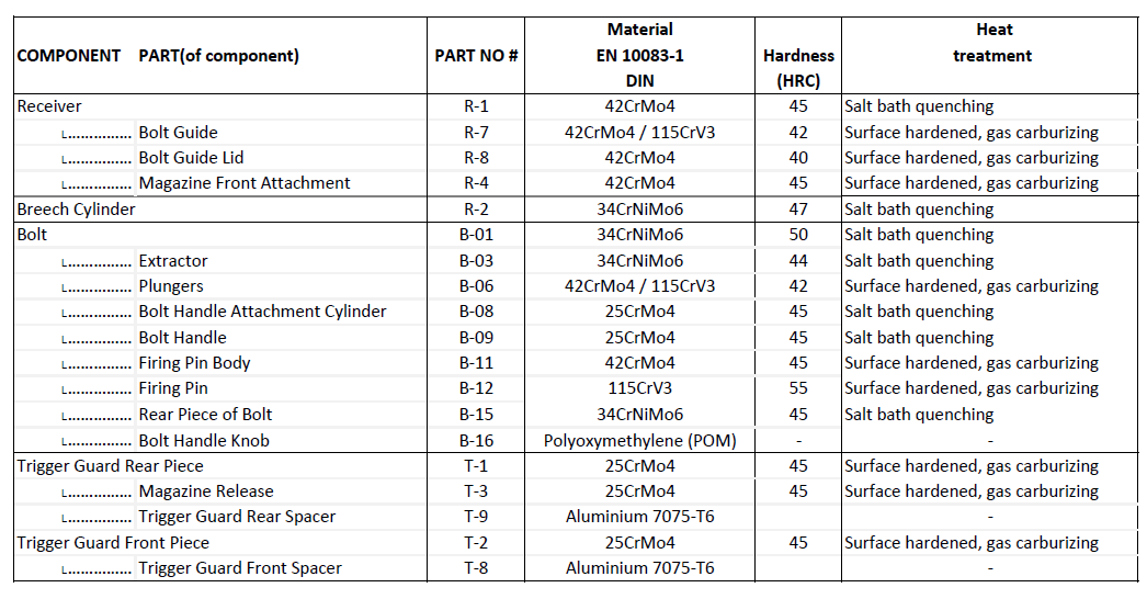

    I am updating the first post so that the below information can be easily located and easily accessible for reading/review.
    Initially, we (Hoplite Arms) will offer complete weapon systems and will not be offering actions alone.
    Through a methodical R&D testing program the soon to be offered weapon system and its specifically selected components have been painstakingly tested, redesigned and refined. For over 2 years the R&D process using software in tandem with field trials, have been performed in the most adverse conditions that can be found. Including but not limited to the winters in Finland and the deserts of the UAE. ranging in temperatures from subzero to 120F, while also enduring windblown snow and ultra-fine sand/dust particles which are known adversaries of firearm actions.

    In controlled testing environments our receivers have remained operational at pressures up to and including 131,000 PSI. Stage 2 pressure testing had increased pressures to approximately 152,000 PSI pressures without catastrophic receiver failure.
    As expected the Aspis weapon systems’ action had not failed at that immense pressure. Although it should be noted the WM cartridge itself tore completely apart and locked the bolt up. In order to view internal results of the 152,000 PSI pressure test the barrel was cut out of the receiver.
    Once the barrel was removed and the action was inspected, it was noticed the integrity of the action was not compromised. Particularly observed and noticed the extractor within the bolt itself was not compromised.

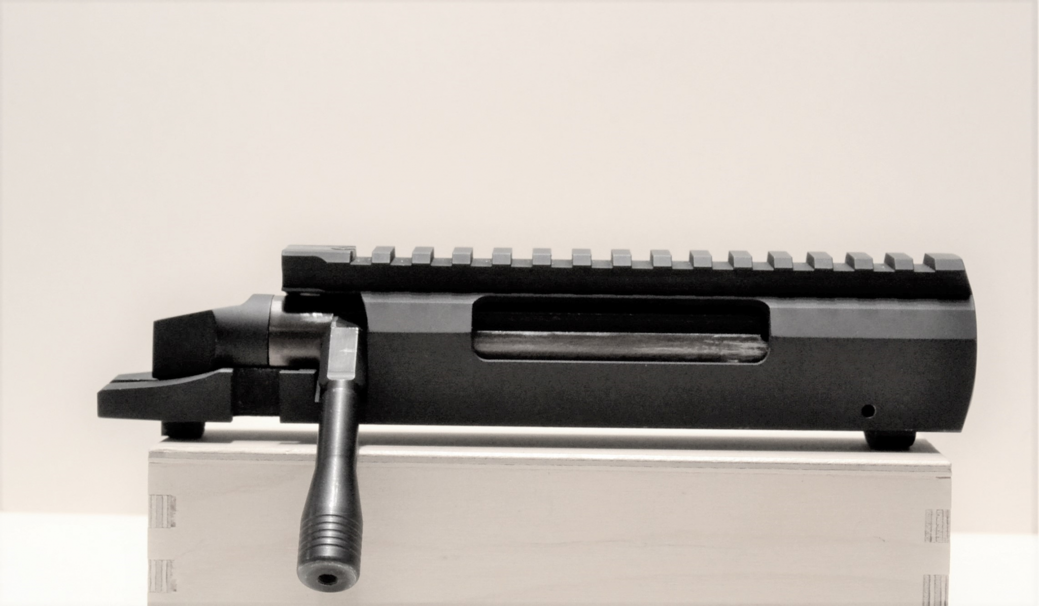

    So.... 3 lug bolt from the looks of it. Breech ring instead of machined in lugs. Not a 700 footprint. Top-mounted bolt guide instead of on the side.
    Interesting.
    Hi,
    Yes, 60 degree bolt with 10 degree above horizontal.
    Double plunger ejectors.
    M16 style extractor.
    Bolt stop has no springs, levers, etc....
    Also an important safety feature is that it is not possible to throw the bolt in to the action with the firing pin in forward position (fired position) causing an accidental discharge of any live cartridge in the chamber. Trying to do this will cause the bolt to hit the rear surface of the receiver.

    Flat bottom???

    That last bit is really interesting.
    Reactions: Mrpike71 and THEIS
    I like the 90° sear surface, ala Anschutz. Trigger housing and single bolt to attach is interesting. I'm curious to see what you guys are doing with the trigger.
    Reactions: THEIS
    Hmm might have to rethink my future plans. I’m really interested to see the final results. Or even some not so final results. ? @THEIS. I’m sure you will have a endless supply of people willing to do testing for you. But I’d be more than happy to be on that long list.

    From the title of one of your images one might deduct we are looking at an "Aspis Mk. II Action". since it read Aspis Mk.II B&W and the jpeg was black and white..
    Hi,
    Almost lol, that was name we name we messed with a while back...but no longer since we are going full weapon system due to some unreleased info :).

    @THEIS ,
    Hmmm...this looks good. I see the Mk I concept evolved a bit; this looks good. Glad to see you able to bring this to market!
    P.S. I still want a swept bolt handle. :D

    Concur.
    As to the bolt handle, mimic the AI. It's not just angle, but length as well. I personally feel, that putting the force for moving the bolt to the rear (and minimally offset from the longitudinal axis) makes the bolt movement "feel" smoother by not allowing a shooter to bind the bolt against the receiver wall. As we discussed earlier, I think this is why the "AI style" bolt handles are so popular with the Tikkas; they reduce the perpendicular leverage by the shooter when transitioning from unlocking the bolt to extracting (rearward movement) the case. As a result, the bolt operation just "feels" smoother. Essentially, you're pulling the bolt back, rather than dragging it back.
    Again, just my personal thoughts on this matter.
    As an aside, after @Lowlight 's discussion on LOP of stocks, I've begun wondering if moving the trigger group back a full inch (via changing the geometry of the trigger hanger) on an action might be worth exploring. I say this for two reasons:
    1. It would allow a shooter to better "square up" behind the rifle by not forcing them to have to shift their strong side shoulder around the rifle to reach the trigger.
    2. By not having to reach around the rifle as much to reach the trigger, the strong side arm would stay closer to the body, allowing a narrower (stronger) angle for the body's position (smaller, shorter triangles would create a stronger, more stable position).
    If you think about shooting a bullpup rifle, one of the reasons it feels "tighter" is that the shooter's limbs aren't as extended due to the compact nature of a bullpup design. This lack of extension is why (JMHO) most shooters comment on how "nimble" or "manageable" the rifle feels when operating it.
    It would also alleviate the issue most shooters of shorter stature have with rifle stocks (LOP is too long). Or as Beau (one of our local SS Instructors) put it about his wife, "her "T-Rex arms" affect her ability to easily "get on the gun" when building a position on the clock".
    At any rate, just an after thought that has been rolling around my noggin' the past few months since we talked about rifle designs, and Frank's discussion about the LOP being typically too long for many shooters since we have transitioned to the "square on the rifle" for recoil management, vice the older "angled away from the rifle" positions of the past. This design would be a radical change in stock and trigger location ergos, but something to think about...
    I'm rambling...need more coffee...

    I'm a fan of the AI style handle. I've got an early Tempest action, and the bolt handle is actually one of my favorite things about it. As a PRS shooter, the shape and position of the handle makes it really easy to manipulate, especially in a hurry.

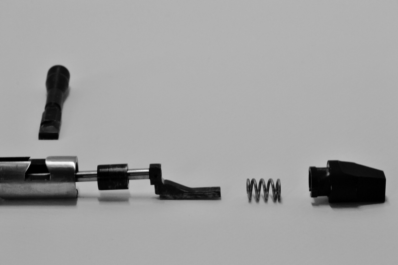

    @THEIS how is the bolt removed? Do you first have to unscrew and remove the Bolt Guide Lid?
    Hi,
    Actually you do not. Essentially there is a notch that will allow the bolt to be turned an additional 30deg counter-clockwise that compresses the firing pin spring during the rotation that allows the bolt to come out.

    Wow, this is quite interesting! A lot of very unique features here! I’d be happy to compare it to my AIAT, if you still need more people to test/review it..... ;) :LOL:
    That having been said, I’m with the others on the AI style bolt handle/knob. I wasn’t sure I’d like it when I got my AI, having been used to the Badger knob (which I still like). But honestly, I REALLY like the bolt shape and angle of the AI, and wish I could get it on all my rifles.
