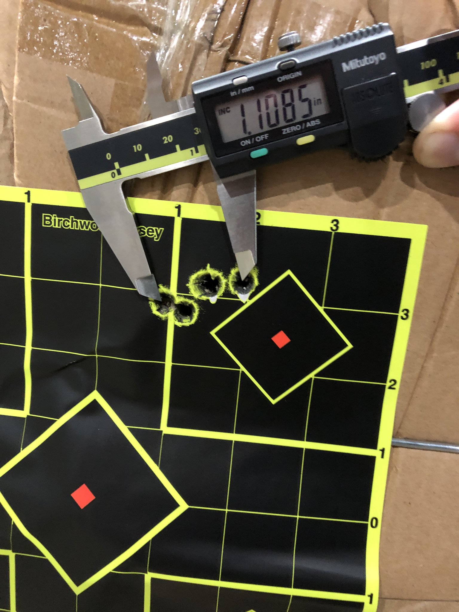

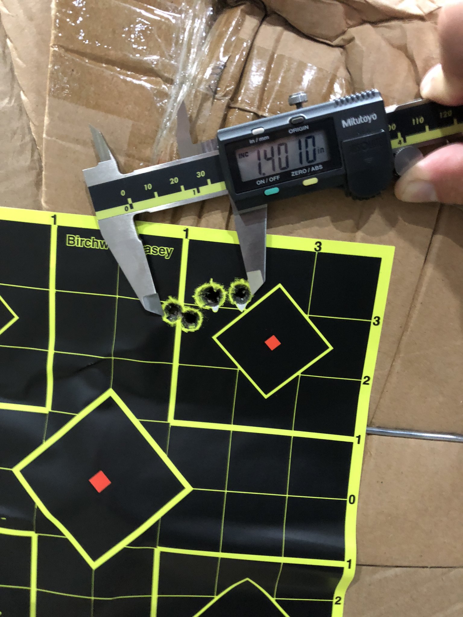

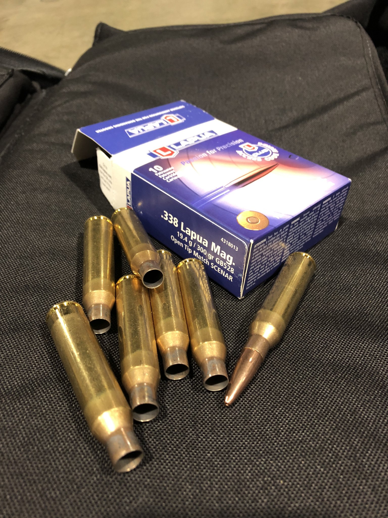

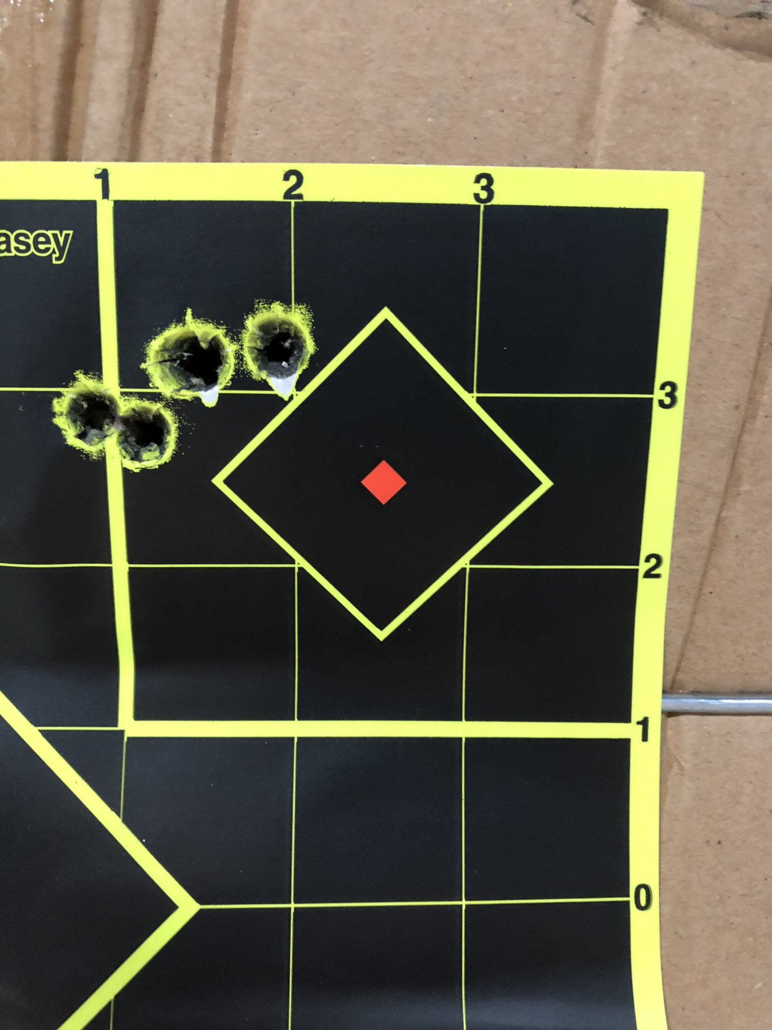

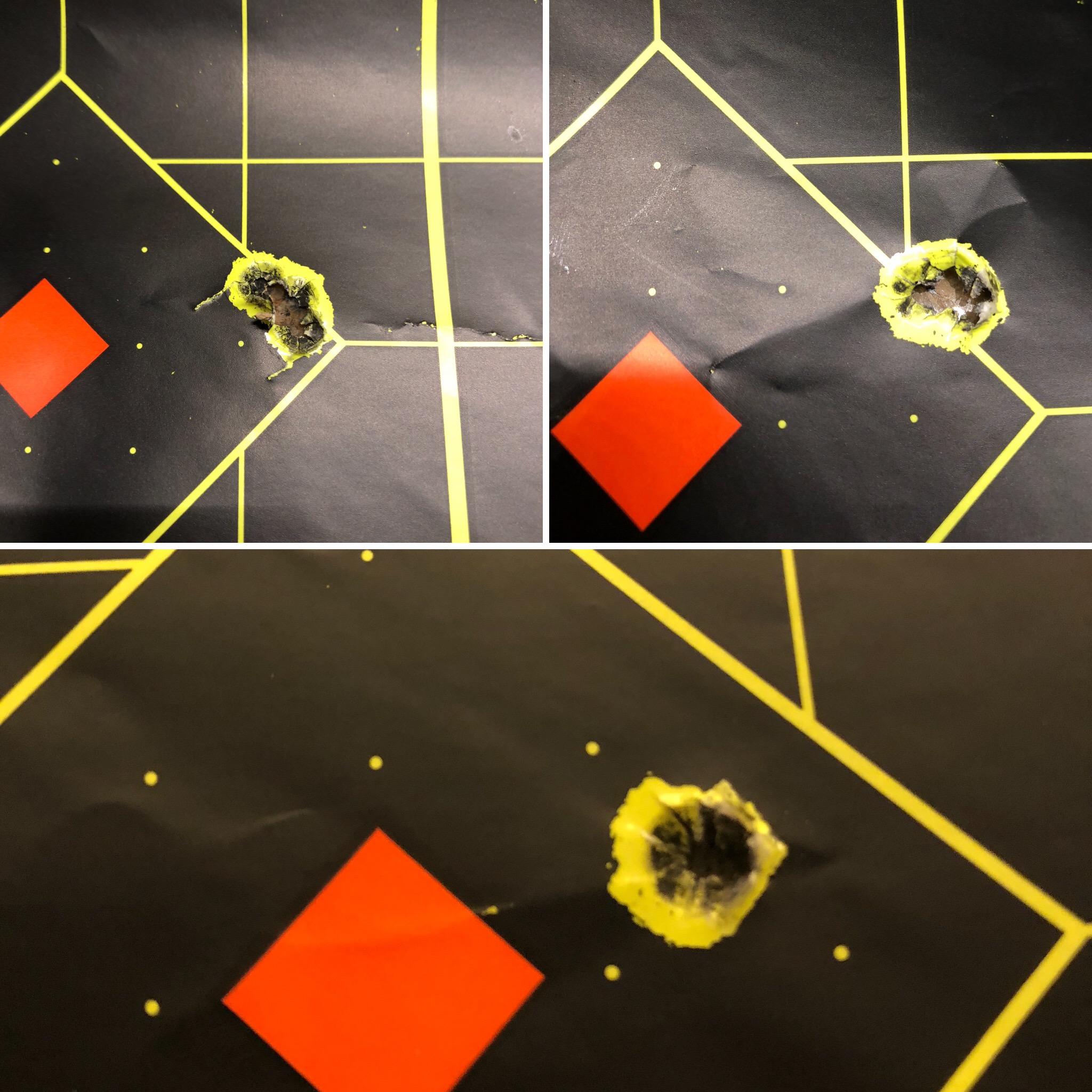

Shot today and this is pretty much the same results I’ve been seeing. I shot a fouler, let it cool. Then, shot 5 shots with a minute and a half rest between each shot.
