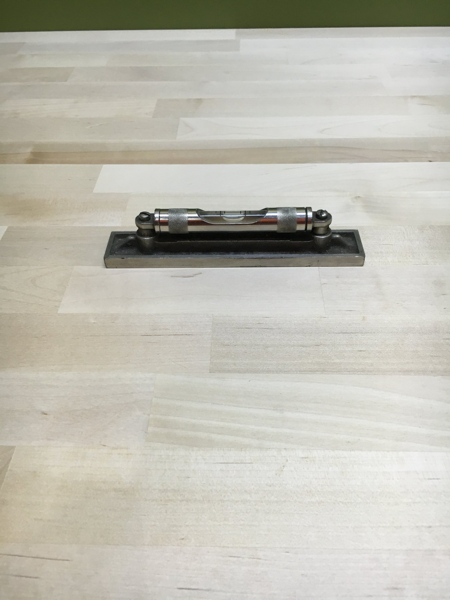

I'm going to make a 3/8" or so aluminum base with leveling feet for the whole thing.
That way I level the base, then level the scale and adjust the Area 419 trickler base for powder flow. After that, if I move things, I just level the base and everything should be ready to go just setting it on top of the base.
That should make my powder measuring system complete.
OR just have a level bench...

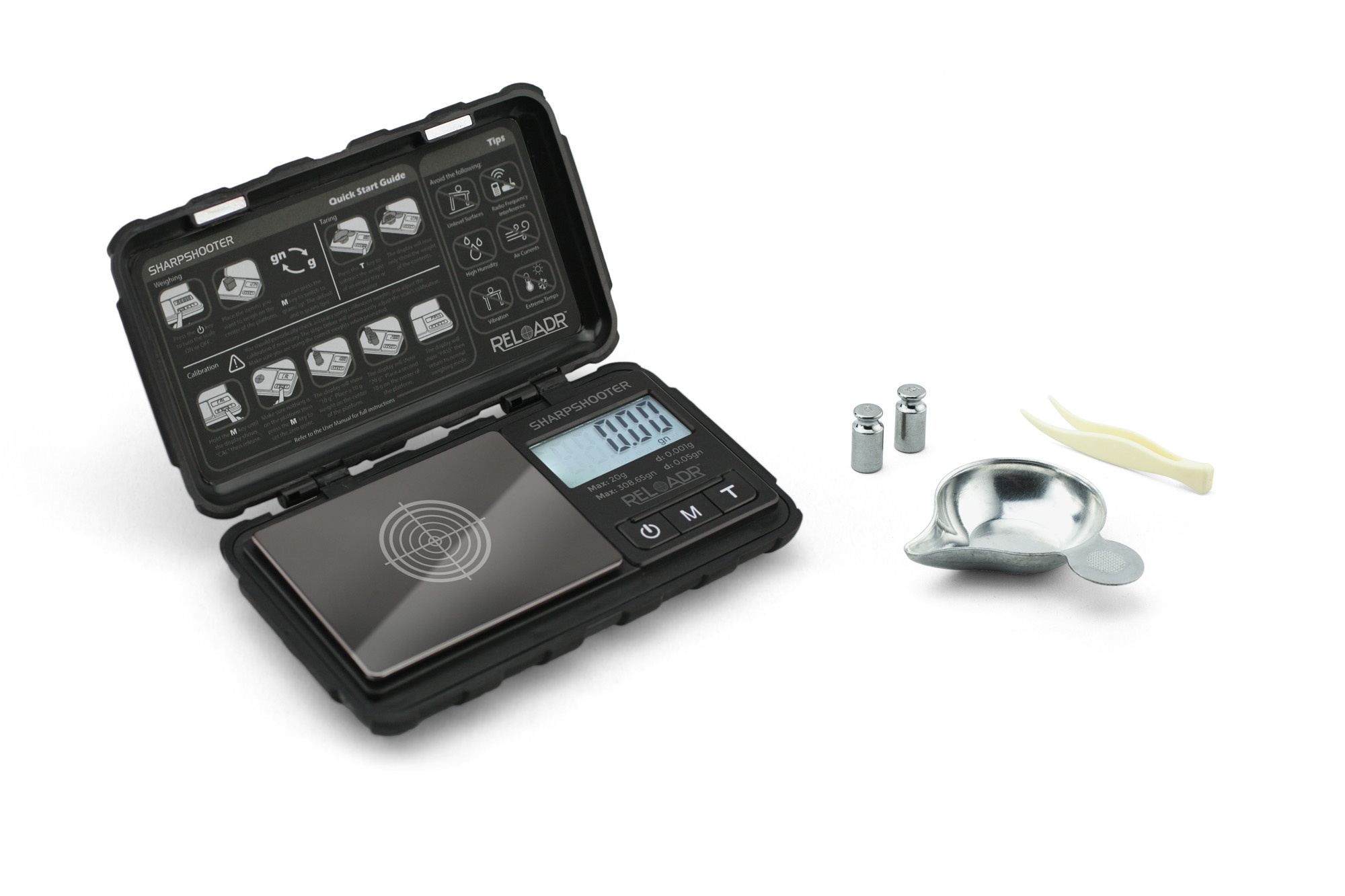

Just to mention an option, this battery powered digital scale is pretty amazing. The SHARPSHOOTER Digital Reloading Scale 20 g x 0.001 g by TruWeigh.com is designed specifically for reloading. I was really surprised when it came in a hard plastic case, well packed with the scale, accessories, and instructions. It appears to be very accurate, at least as verified by my other 3 digital and manual scales.
