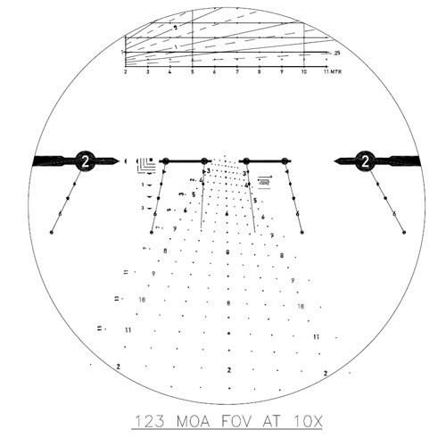

Has anyone looked at the Tubb DTR? It will be available in the 5-25 Mk5 in the future. Currently you can get them in the Mk6 and Mk8
Just a quick search and I'm not sure about what I read. The article made it seem like its essentially a BDC type reticle with a 250fps velocity range. It also said the scopes come with different calibrated elevation turrets for different 308 loads/projectiles.
Is that it
Yes
It uses distance in yards and wind in mph instead of conventional MIL and MOA. There are various versions all based on BC and velocity of various projectiles and calibers. Not only 308. They are surprisingly accurate and the wind dots take into account the gyroscopic characteristics of the bullet as it’s effected by the wind. Very fast in practice. Also several videos on YouTube of it in practice.
