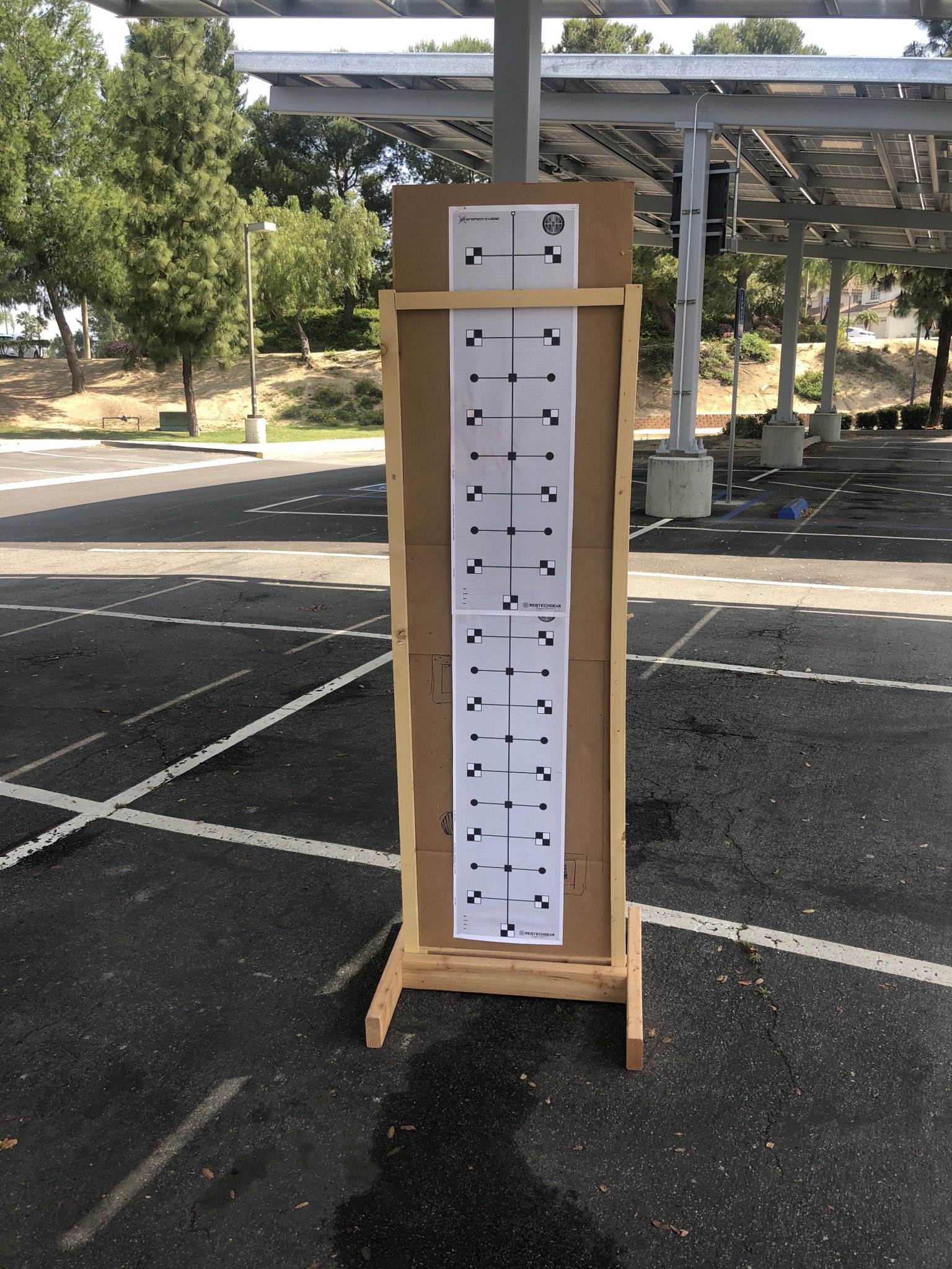

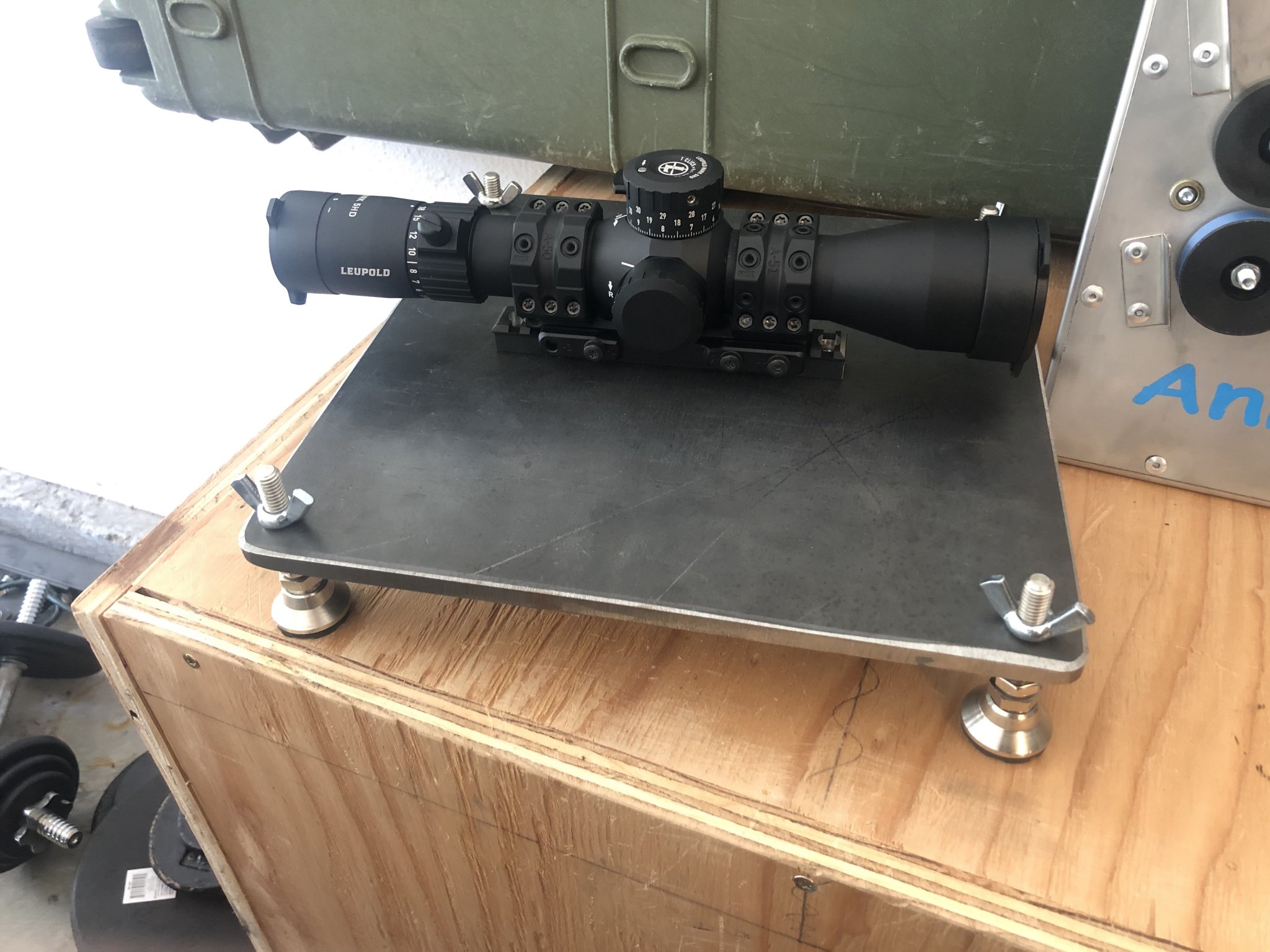

I just picked up a Mark 5 3.6-18 CCH and ran it through a tracking test, figured people following this thread would be interested in the results. I mounted the scope in a Spuhr 5001 and used the leveling wedge to level it. Next I mounted it on my tracking test plate pictured below which is a 15lb steel plate with a pic rail and levelers on it. I placed my tracking target (snipers hide / B2B precision 10mil tracking target placed end to end for 20 mils) at 100.0 yards verified by my leica 2800.com and leveled the vertical stadia of the tracking target with a plumb bob. Finally I adjusted the levelers on the plate until the bubble level on the Spuhr showed level and checked the vertical stadia of the scope reticle against the plumbed target - spot on. When the spuhr shows level my reticle is plumb. After tesing tracking out and back 5 times I'm happy to say that each time it tracked with less than .1 of error over 20 mils, meaning between 99.5%-100% tracking, and returned to zero each time. That being said, the parallax is picky and the CA is very bad, but for a 26 oz 12" scope I'm okay with that, it's good for what it is!
