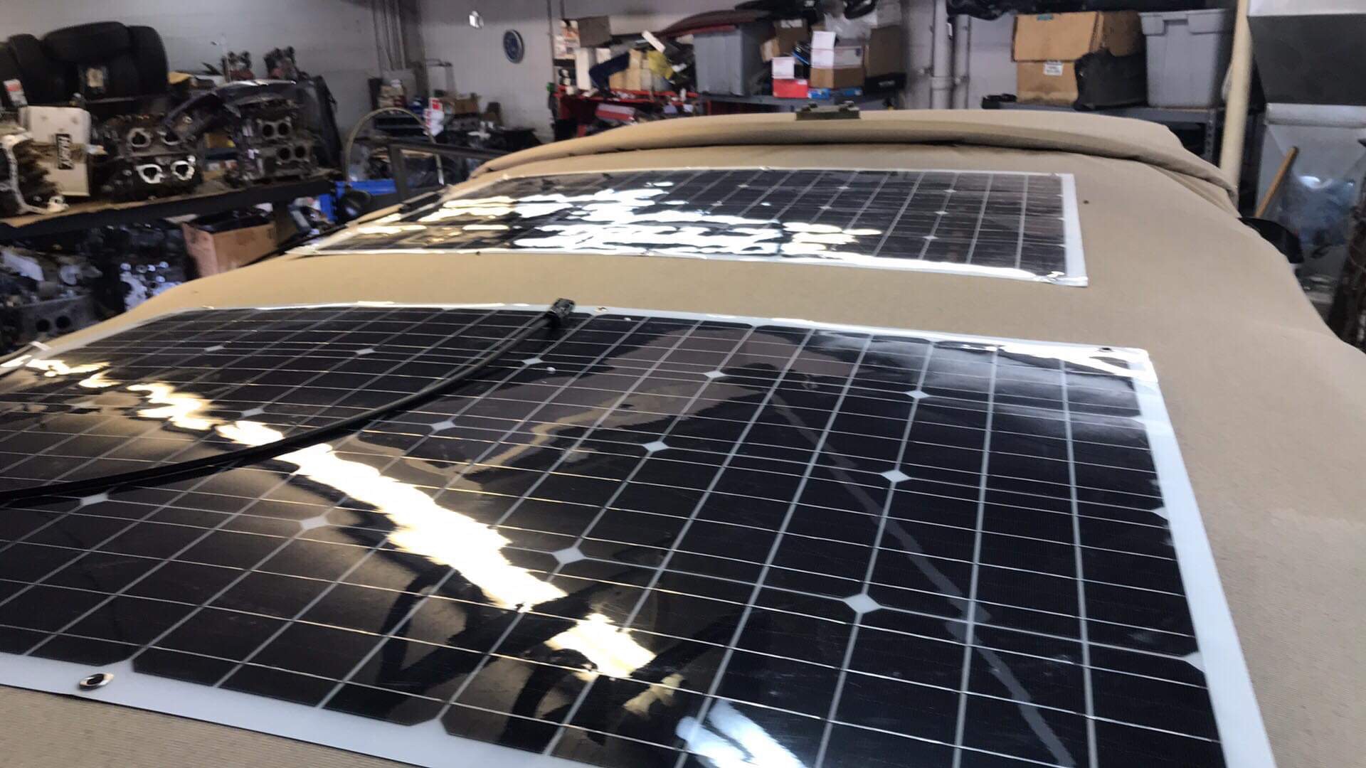

My land is in the Missouri Ozarks and I use solar in the woods. Below is a pic of the thin flexible panels on my Pinzgauer. They run through a charge controller to a deep cycle battery and then to an inverter separate from the truck's 24 volt system. I also have three panel 100 watt system I set up for use of my buddies while I'm out of camp.
I have a couple of smaller folding panels for phones and such as well.
