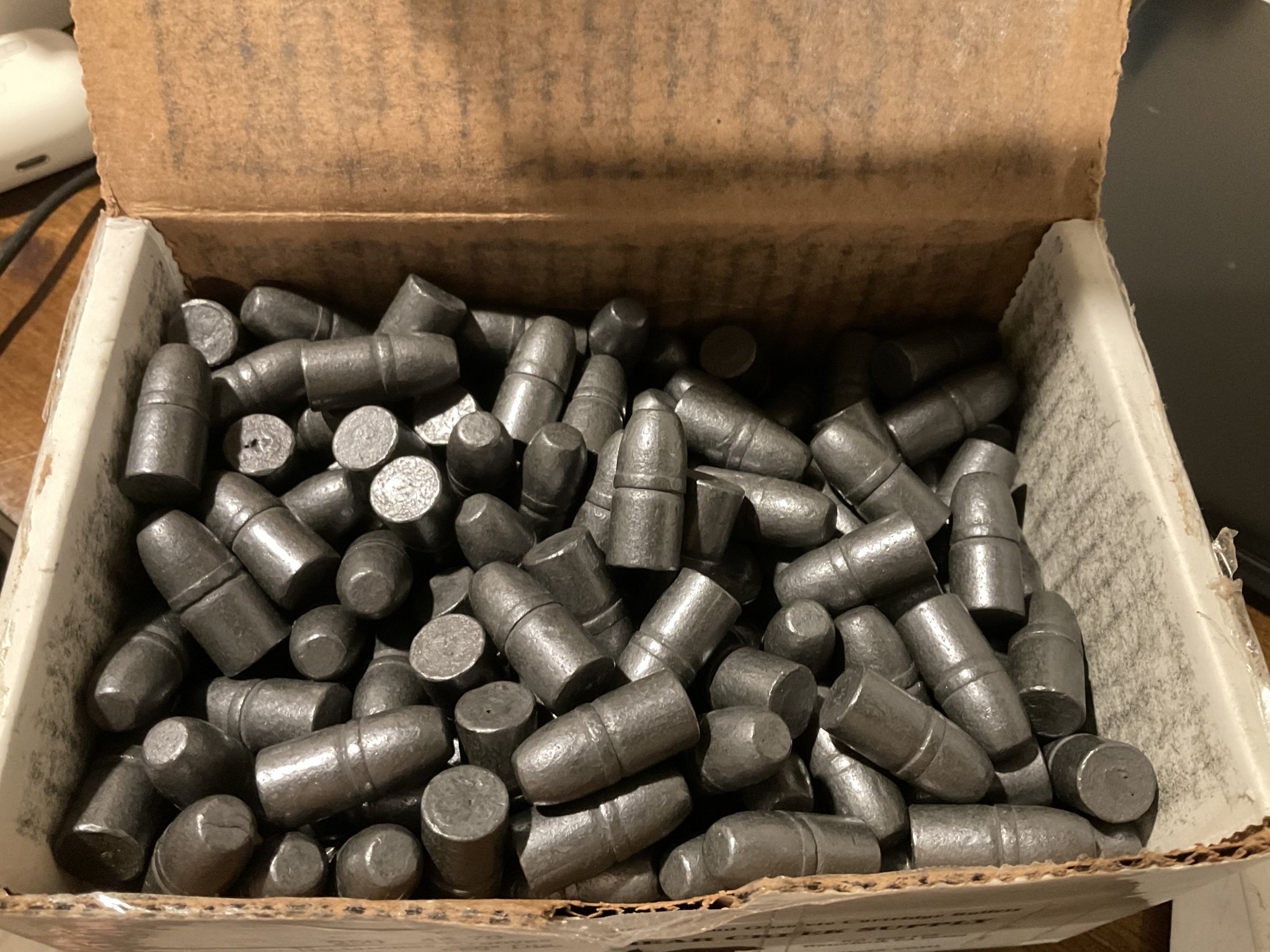

    I am also on the Montana Bullet Works train. I also tried RimRock. Rimrock is much more economical but I struggled to get them to not lead my barrel. The premium uncoated is the serious use projectile. The black powder coat is for practice.
    Reactions: Gustav7 and padom

    Do you know who manufacturers properly powder coated bullets?
    I just bought some Bearcreek Supply 400 grain coated bullets for my 45-70. This particular bullet does not have lube groves like their 405. Their gooved 405 shot very well in my 1886, so I’m hoping these non-grooved 400 shoot even better. I’m not sure what kind of coating is on the bullet, but I’m not running these over 1400 fps, so it probably does not matter as long as they fit the bore properly. My load that shot well with the grooved 405’s was 27.0 grains of 5744 which averaged 1286 fps.
    I was buying mine from Beartooth Bullets, however I think he may have closed up.

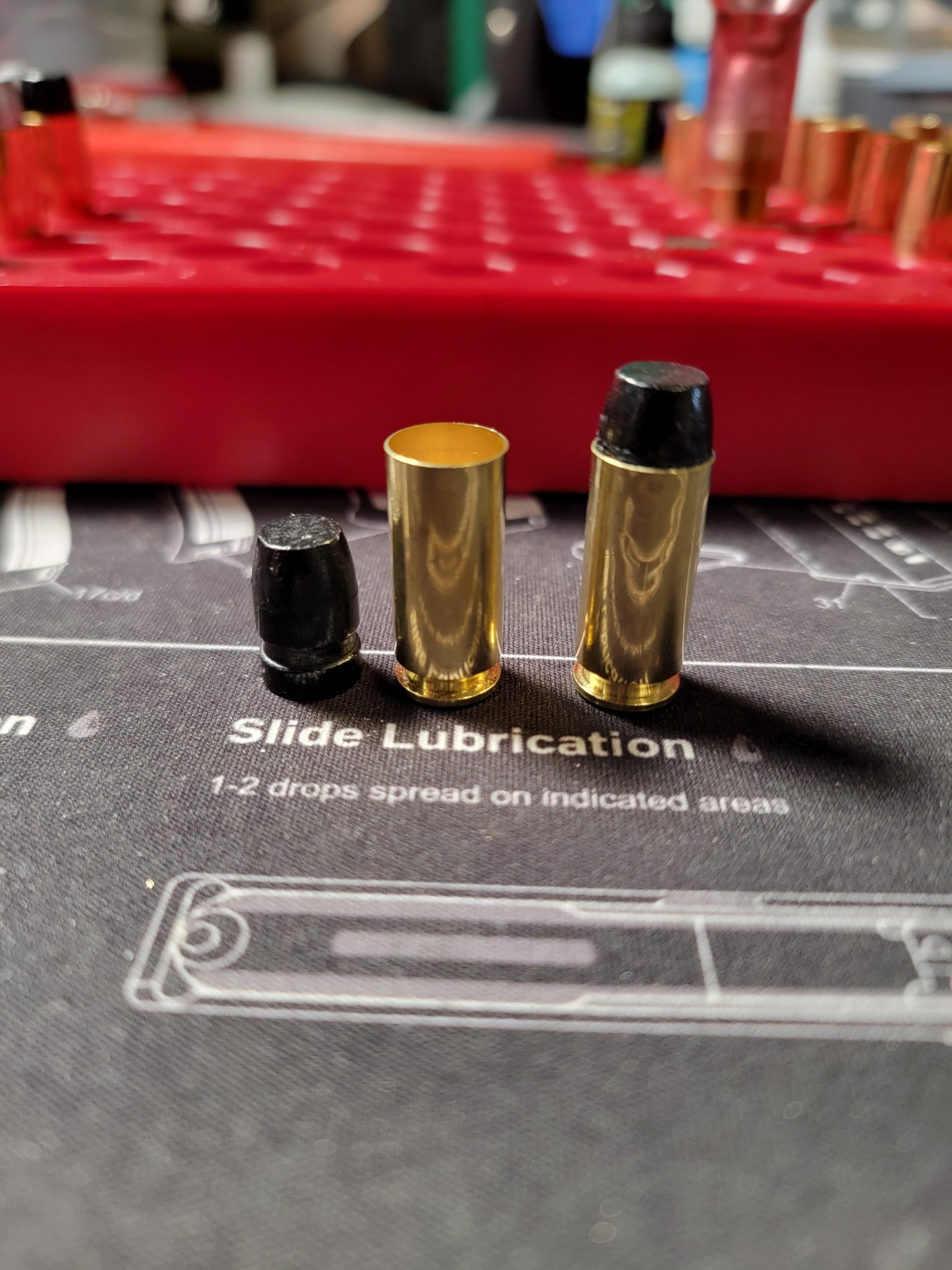

    I just bought some Bearcreek Supply 400 grain coated bullets for my 45-70. This particular bullet does not have lube groves like their 405. Their gooved 405 shot very well in my 1886, so I’m hoping these non-grooved 400 shoot even better. I’m not sure what kind of coating is on the bullet, but I’m not running these over 1400 fps, so it probably does not matter as long as they fit the bore properly. My load that shot well with the gloved 405’s was 27.0 grains of 5744 which averaged 1286 fps.
    You know, it's been a couple years since I paid much attention to who was using powder coating (commercially), but after doing some googling I'm not seeing anyone specifically listing that - so maybe no longer offered?
    Those Bear Creek bullets are something a little different that pre-dates powder coating; I have a bunch of those too and like them. Seems like their coating must have graphite or something like that in it. They won't handle the higher velocity and pressure of a hard cast powder coated bullet, but they're great within their intended use. That should be a really good bullet for your 45-70, as long as the driving bands are slightly (.001" or more) larger than the rifled bore.
