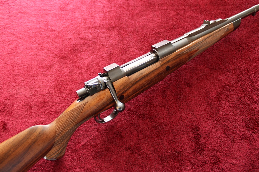

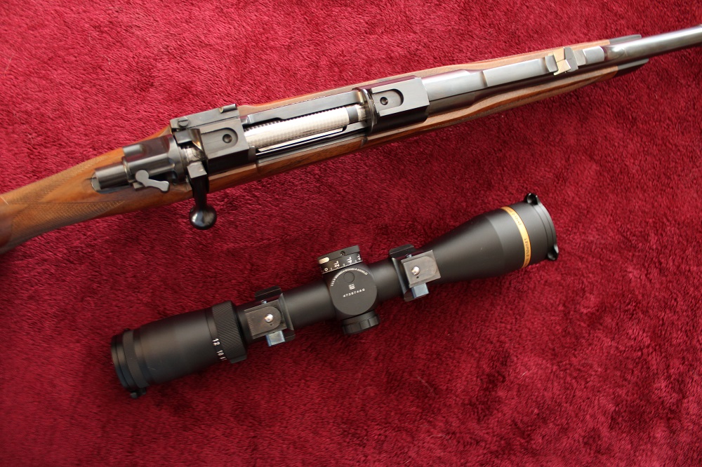

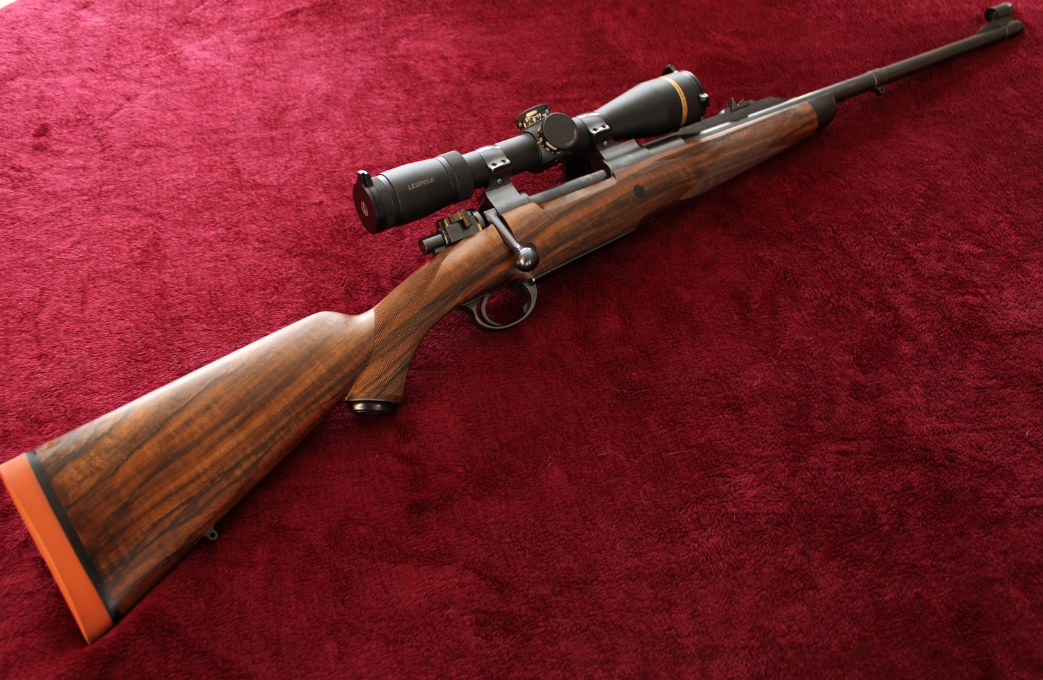

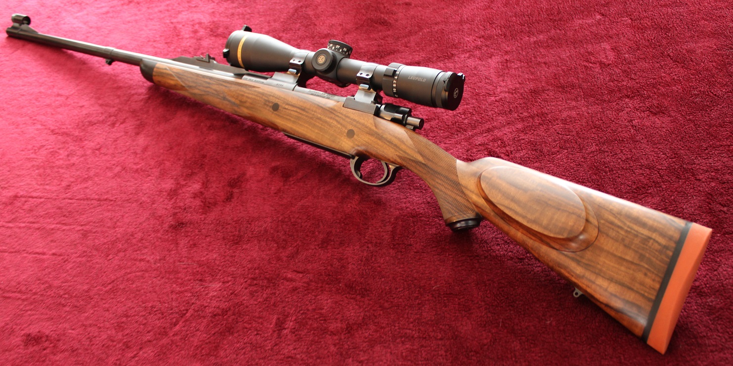

I own and operate a small custom rifle operation just outside Deadwood South Dakota. Our name is Satterlee Arms LLC. I started Satterlee Arms LLC. back in 1998. The focus of my work has been building rifles based on existing Mauser actions and our own in house produced square bridge M98. There are three of us working full time here and we produce around 25 rifles per year.
Attached for your viewing is one of our most recent works. This one is a 375 H&H based on one of our Satterlee Arms square bridge actions. The barrel features an integral quarter rib and sling band and a soldered on front ramp. On this build we've gone with the Smithson QD scope ring system which allows rapid removal of the scope, this is a unique system where slide actuated ball bearings lock into recesses machined into the square bridges. At first, I was skeptical of this system, however, this being our 3rd build using this system accuracy has been very good as it relates to a sub 10lb traditional style hunting rifle. All the metal surfaces on this rifle are hand polished to 320gt and then rust blued. Test ammunition for this build so far has been the commercially loaded Barnes Vor-TX 300gr, fired from the bench out to 100 yds, 1st round clean and cold out just a touch 2nd two nearly a perfect double.
