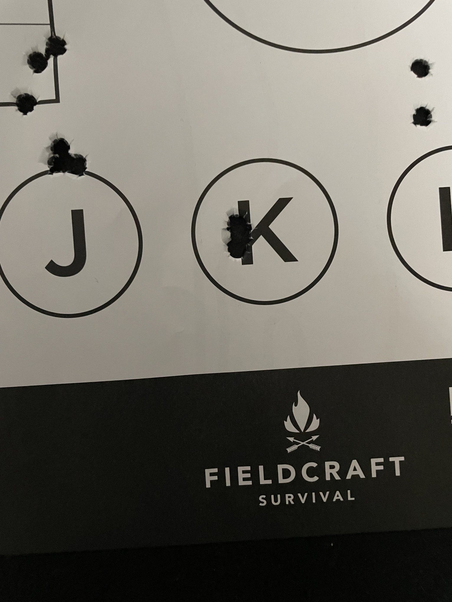

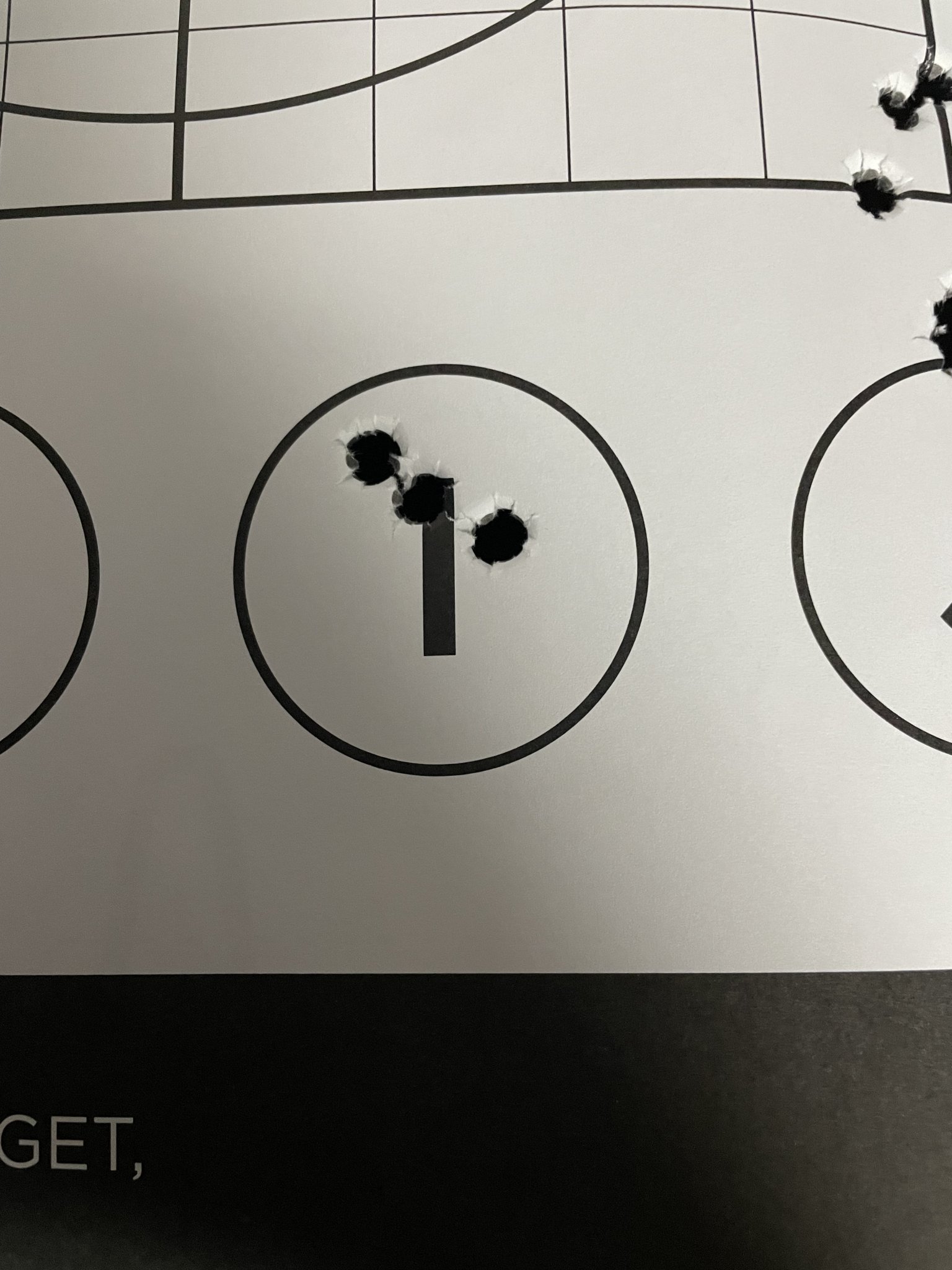

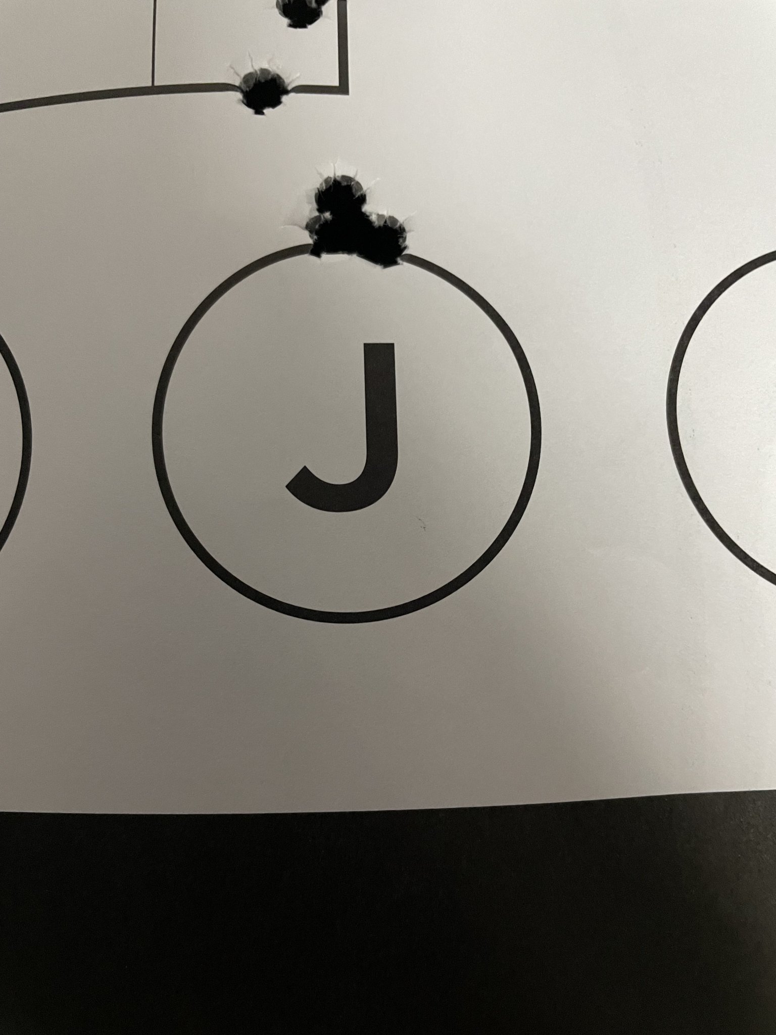

Here's the test group that came back with the rifle.

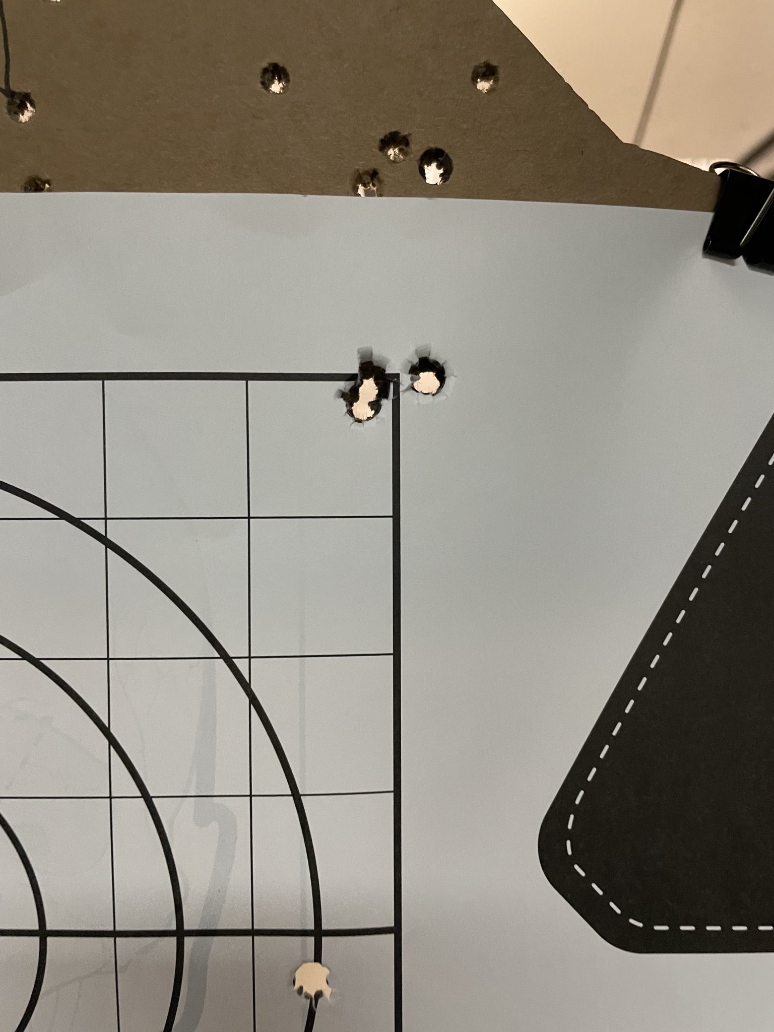

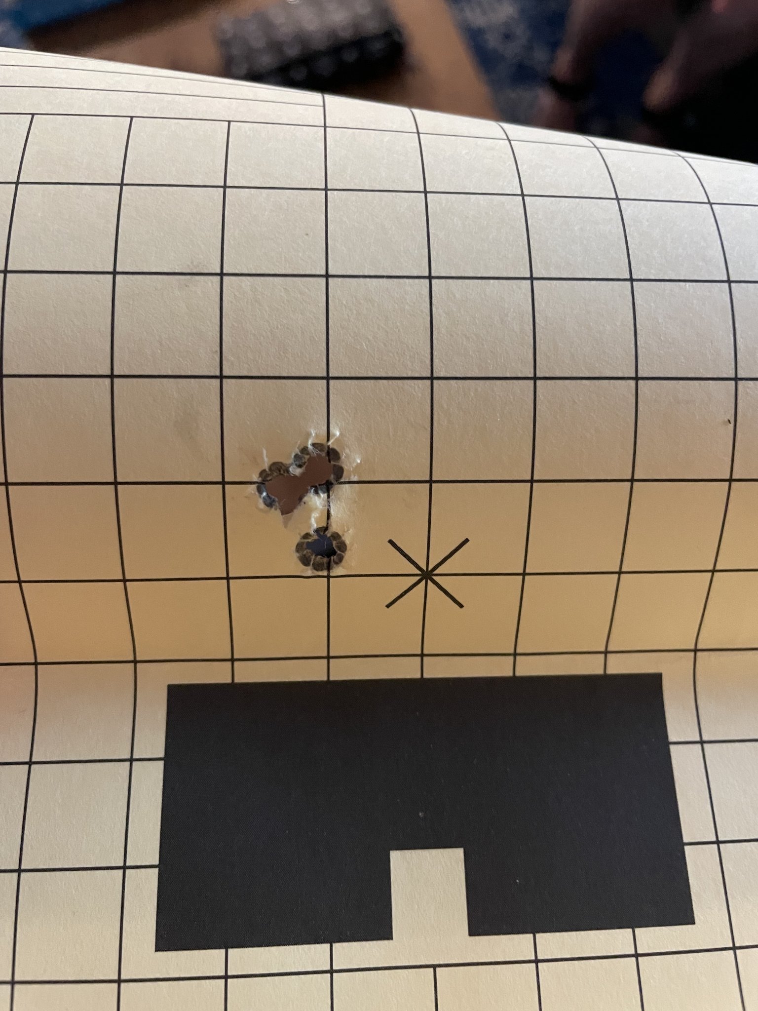

Here are a couple groups I shot when the rifle was somewhat cool. Same ammo as the original thread btw!
I'll probably end up selling the rifle anyways because the groups open up when the rifle is hot, but it's great for a hunting rifle!
Nope, no reason given. They just sent me back a rifle that works.
View attachment 7903917View attachment 7903918View attachment 7903920View attachment 7903922

Hi all,
I just took my new Springfield Waypoint in 6.5 with the carbon barrel to the range for the first time today... Not impressed! For a gun that guarantees 0.75 MOA, my example was hovering around 1.5 MOA. This is after 100 rounds of Norma 143 Match ammo. Not a good showing when my 16" Scar 17 was consistently putting down 0.75 MOA in between my Springfield frustration!
At this point, I doubt it's the ammo, although I could be wrong as this is the only ammo I've shot through the rifle. At the range, I checked the scope rings, and mount—all were at the same torque spec I initially tightened them down to.
I suspect that the free-floating (or lack thereof) may be the issue. Everything looks good from the outside, but it's possible the barrel is coming into contact with the stock during firing.
I took the barreled action off the stock and found what looks like the slightest bit of rubbing. It's very hard to capture this on camera, but there is a very slight rub mark right along where the forend sits. The carbon sheen really covers it up.
Could this be the culprit? Is this worth sending it back to Springfield for their warranty fix? Or would y'all find a gunsmith to diagnose the issue first?

I have the same rifle, currently trying to develop a load for it.
If I shoot factory ammo I use the Norma 143 Bondstrike Extreme, averaging 1/2” groups, sometimes 3/4”, sometimes 1/4” groups. The ammo is very consistent, the group size variation is on me I assume.
Initially I tried the top Hornady offerings, match, precision hunter etc, and they were rubbish out of my rifle. From 1.5” to 4” groups kinda rubbish, and during that same shoot I ran the Bondstrike and immediately was VERY sub MOA. The best group we have achieved with the Norma BSE factory load was .23 MOA.
Interested to see what you settle on.

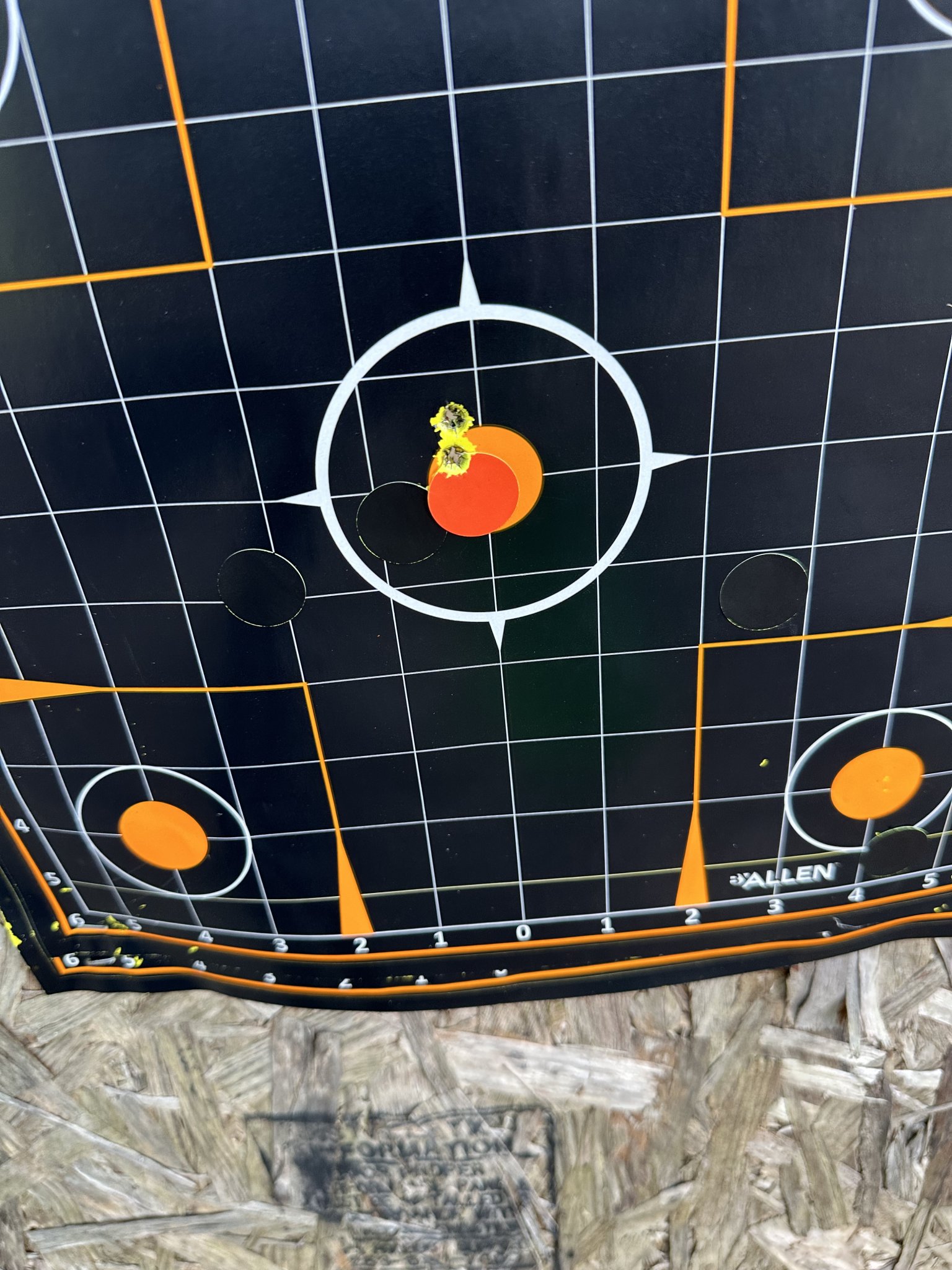

I know it’s an old thread but I had the experience with my waypoint 6.5 prc not shooting less than a 2 inch group the first time I shot it. Took it back home and cleaned it throughly and retorqued the action screws to 65 in lbs and now with the same ammo ( Hornady precision hunter) the bullets are damn near touching every time. This is off of bipod and rear bag.
