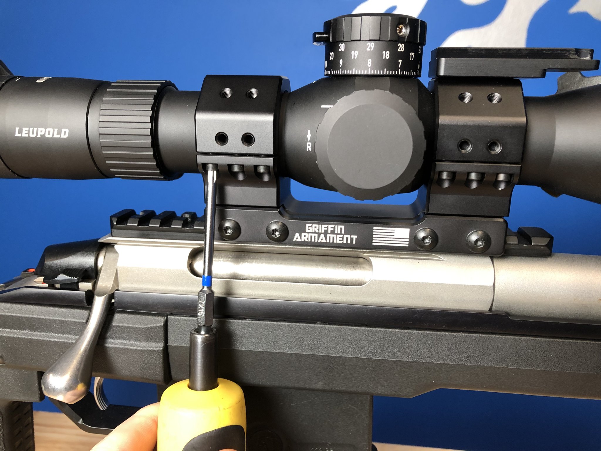

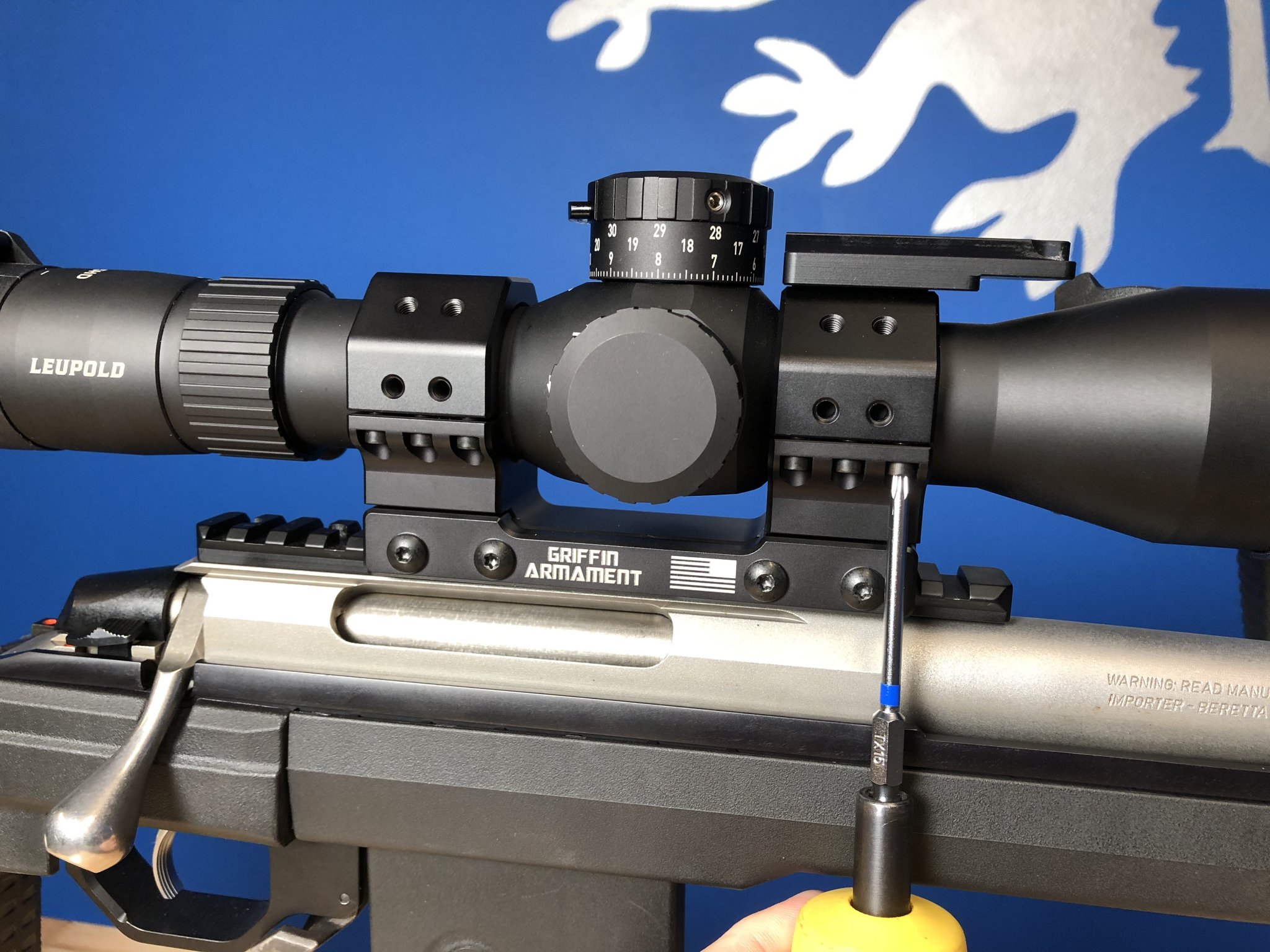

I'm still not grasping what you guy's gripe is here... I can reach the fasteners just fine with the optic mounted. That being said, if you install your optic following our procedure, and torque the 8-40 fasteners to the recommended spec... you won't have any issues.
Now do that without the extended bit. Let us know how easy it is to get a straight grasp on the screw.
The extended bit that anyone can buy at literally any hardware store in the US? Come on man...
These complaints seem to be largely born out of laziness as one commenter in this thread admitted earlier. If you don't like the product because of this one feature, then move on. We demonstrate how simple installation is, cover any considerations, and make recommendations for tools and procedures... All this to support a product that can be had for a ridiculously competitive price. I'm not going to win you all over, and some of ya'll seem to just want to be mad and I can't help that. ?‍♂️

They do seem like a very solid option for a great price. No complaints about that. Was just honestly curious as to why screw placement is where it is, that’s all.
For me personally it is just a matter of simplicity, it requires a tool that I do not have or an etra step I do not need with other products for no apparent reason. (Or am I missing something) Nothing personal, just an observation.

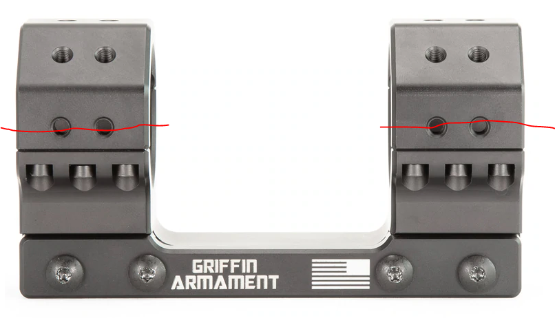

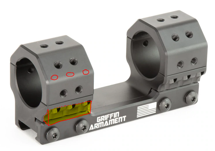

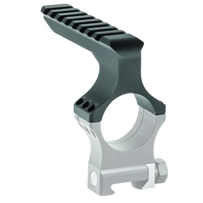

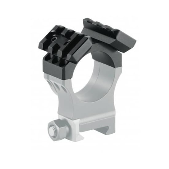

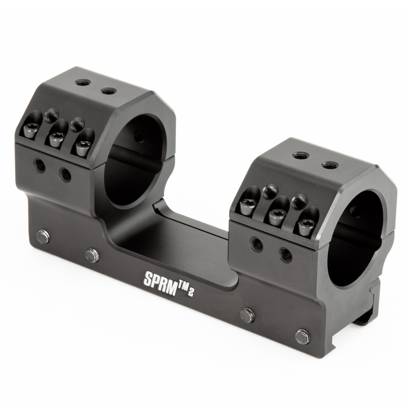

People have asked what positives there are for having the screws on the underside, and apologies if i missed it, but I havent seen that question addressed. An extended bit is just another piece of kit that can be misplaced in the field, so w/o significant advantages, why?
People have asked what positives there are for having the screws on the underside, and apologies if i missed it, but I haven't seen that question addressed. An extended bit is just another piece of kit that can be misplaced in the field, so w/o significant advantages, why?
Why? I figured that was obvious, so my apologies. This design facilitates accessory mounting on all 5 sides of the mount (10 surfaces total, 5 on each ring).
This mount, once installed, should not require servicing in the field... but if it does, keep an extra extended bit in whatever tool kit you already have put together I guess? How many folks on here are mounting optics on the firing line versus at their workbench? Your concerns aren't really valid and you're hammering away at a usability feature that Is not an impediment to the function of the product.
SO WHATS YOUR REAL BEEF??

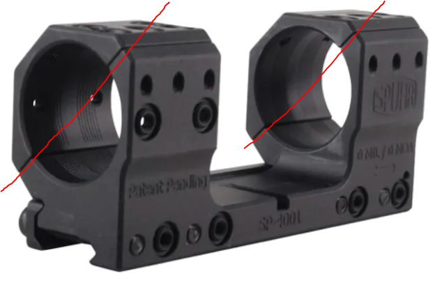

My guess would be that it's a simple way to avoid patent infringement suits from SPUHR.

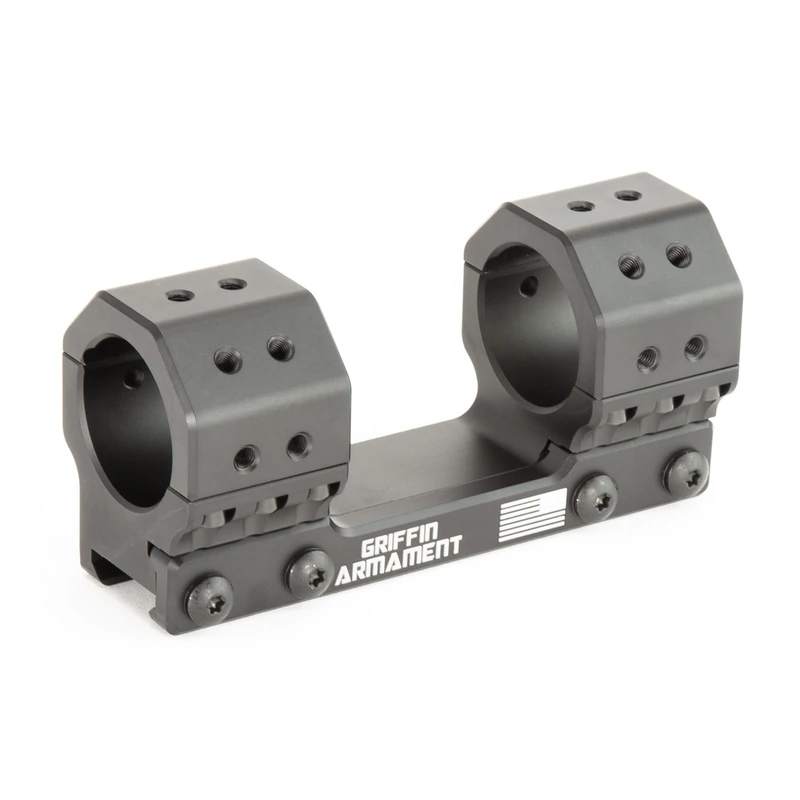

i think the real question is...
if the screws can be on the top of the mount on the 'high side' and still have a usable mounting surface on that 45 degree angle, what makes the 'low side' different.
is it just to have the same length screws on both sides?
high side
low side

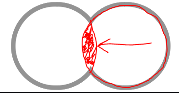

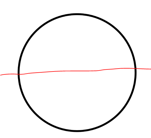

I get why they had to with their chosen design parameters. Its so that they can bisect the scope tube in half so the scope can actually fit into the ring.
or for the angled split in half
If one part was any more or less than half then the scope wouldnt be able to enter the rings.
But splitting it in half in the horizontal middle puts it right in the middle of their side mounting holes. So they have to offset it if they want to keep their accessory mounting holes. (who really ever uses these holes though? Ive never seen anyone in real life use them.)
Sphur got around this by bisecting the ring at an angle and leaving meat on the corners so that the screws had enough material to bite into without possibly tearing out the aluminum. But it also allows them to tighten the cap screws without removing the entire mount or carry around extended bits... and adding an extended bit isnt the worst concession to make... provided that the entire rest off the wrench can fit which which a borka cant like you said.
One might also be able to leave a larger gap between the base and the caps to make up for the necessary material clearances for the scope tube to drop in... but then that could get into pinching or way over torquing should someone not be familiar with needing to leave the larger gap and it sacrifices surface area which I can see some arguing against.

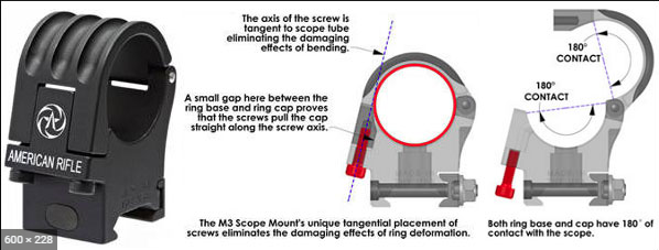

I think a better method would have been to make the lower side a hinge sort of like ARC kind of does with theirs (and displayed amazingly in this old image of their previous experiment).
If you dont make that hinge and fastener tangential though you can start to squeeze the mount in a non uniform manner which leads to pinching the tube which is why people dont like the vertical split rings which requiring closing one side completely and then torquing the opposite to clamp it down and hope that its pinching it uniformly instead of only on the gap side.
So I can see why griffin was forced to make the screws on the bottom. But its their general assholeishness thats seeping through (we're assholes too but we arent trying to sell anything so it doesnt matter for us) and refusal to acknowledge the issue is an issue for most people that I think most people are really jumping on them over.
"It was designed, tested, and manufactured by people who have devoted their lives to this industry." Yeah and then they named it after cum so I'll take the blind devotion with a grain of salt.
Personally, I would have put them up top while keeping the split down low and just left more meat on the bottom half with 1/4" longer screws for the threads to bite on.
But then it wouldnt be "ambidextrous" for whatever the fuck benefit that could be.

the griffin doesnt split in the middle
they have an angled split. look at the two images i posted. the mounting screw side is the 'low side' and also the side that has the upside down screws
the 'high side' has the up/normal screws and ALSO has the mounting option even with those screws there
mirror those screws to the other side and make them 1/2" longer and you can have up facing screws?? and you'd still keep the mounting options on all side of the mount/ring

Buy a mount and try it out for yourself!
Might i suggest *gasp* trying it, following our instructions, and then make your informed criticism if any.
additionally, I mounted a scope in the field this past weekend. All I used was my fix it sticks kit which has all the small bits and torque limiters. It was last minute for a friend who brought some new gear out and if he had the splooge mount we wouldn’t have been able to do it without taking the whole thing off a few times that would have been a Major pain in the ass.

And.......if you use the longer bit with a Wheeler Fatwrench, will you run out of space between the benchtop and the screwheads ?(it’s dependent on the rest height).
With a Spuhr, or other “toploaders”, it is possible to load up each cap with all 6 screws in advance of placing the cap on the base. Can’t do that with the Griffin, each screw has to be inserted one at a time.
Simply flip the screw orientation and I’d probably buy one. Spuhr doesn’t use “special” aluminum......
