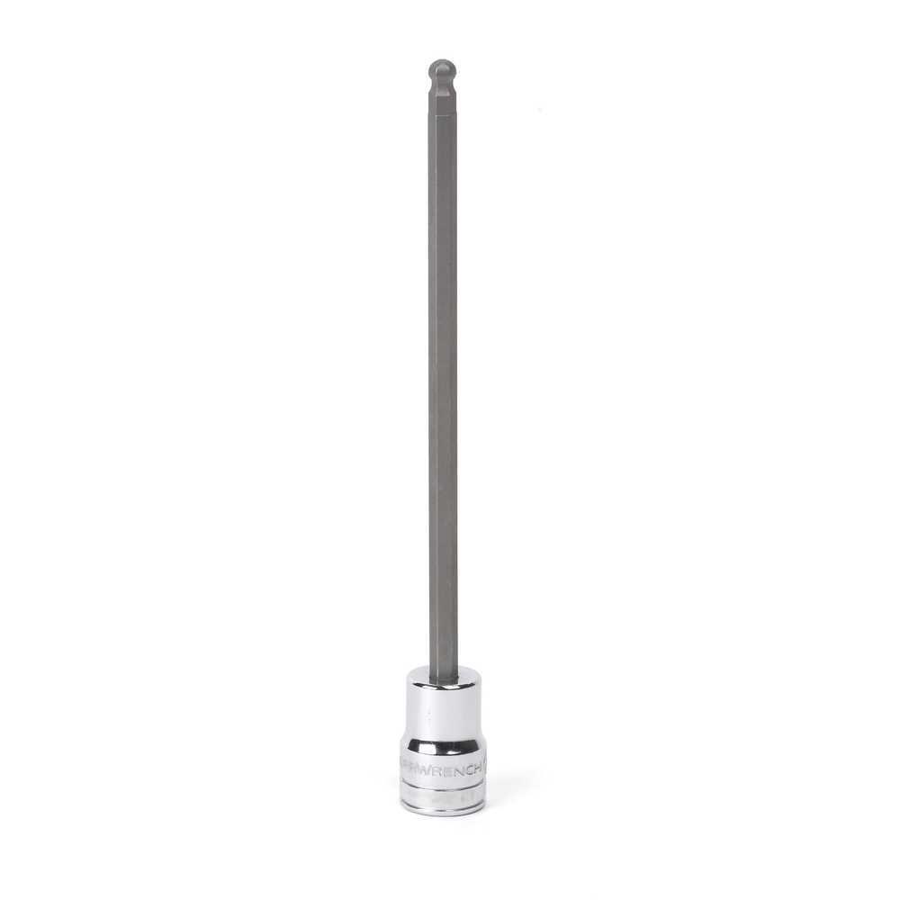

@Waorani
I suggested that in the first post (Bear Pit) that got deleted.
Switch the screws out for allen head cap screws then supply a ball driver bit for fat max or Borka.
No response???
Torx bits must be engaged square or they strip.
Since I'm on the topic of fasteners @GRIFFIN_ARMAMENT Please explain the choice of 8-40 fasteners for the ring caps?
It's been my experience that coarse fasteners are much better when tapped directly into aluminum i.e. less likely to strip and easier to tap cleanly in gummy 6061. I think your going to regret the 8-40's. They make perfect sense attaching a pic rail to a hardened receiver, but not into 6061 at least not to me.

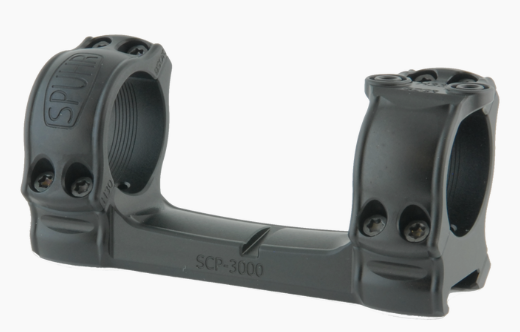

there's a reason you see spuhr and ARC on a HUGE chunk of rigs
I’m not entirely sure why the ARC rings are as popular as they are. It has hinges, which are cool I guess? Granted, they look better than say, seekins rings, so they do have that going for them.
I’m pretty biased towards 1-piece mounts except where I need to use rings to mount a scope lower that that allows. To that end, a Spuhr (and others) have full length mounting surfaces whereas the ARC mount doesn’t and is QD oriented for whatever reason.
1 screw. easy as shit to use. hold scopes well. good tolerances.
i use SPUHR but if i wanted hunting oriented would be a a tossup between ARC and spuhr rings/hunting mount
If you are truly curious, I theres a video out there of Ted talking about the engineering and holding power behind them. Plus they are the simplest design on the market for install.
Yeah, nothing wrong with them, maybe I just underestimate how much people fiddle with their scope to warrant the convenience/cost difference.
