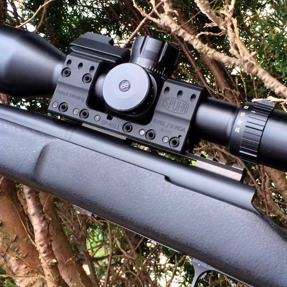

Hakan, are the rings on the SP-4602 and SP-4616 mounts the same distance apart? I just mounted up my Bushnell XRS in a SP-4602 mount and I can't get it far enough forward on the rail to accommodate my natural point of aim. This led me to look at the SP-4616 mount as it's the same height and cant as the mount I now have. The reason I ask about the rings is there isn't a lot of room between the rings and turret housings and I don't think I'd want them any closer.
Yes they are same distance apart
If you need a lower mount we also have SP-4011 that is the special mount that works as a cantilever mount as well as a straight mount also.
But it yet only comes as 0 moa and in 1,1" height.

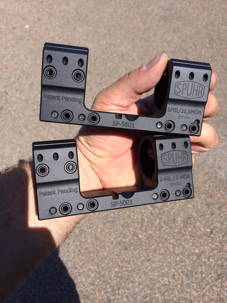

New version Of SP-5001 and SP-5601 is now ready, and they have been out of stock to long.
Difference betwen new and old is that The new model is shorter so it accepts new Leopold and it have a cutout for springhousing on IOR.
