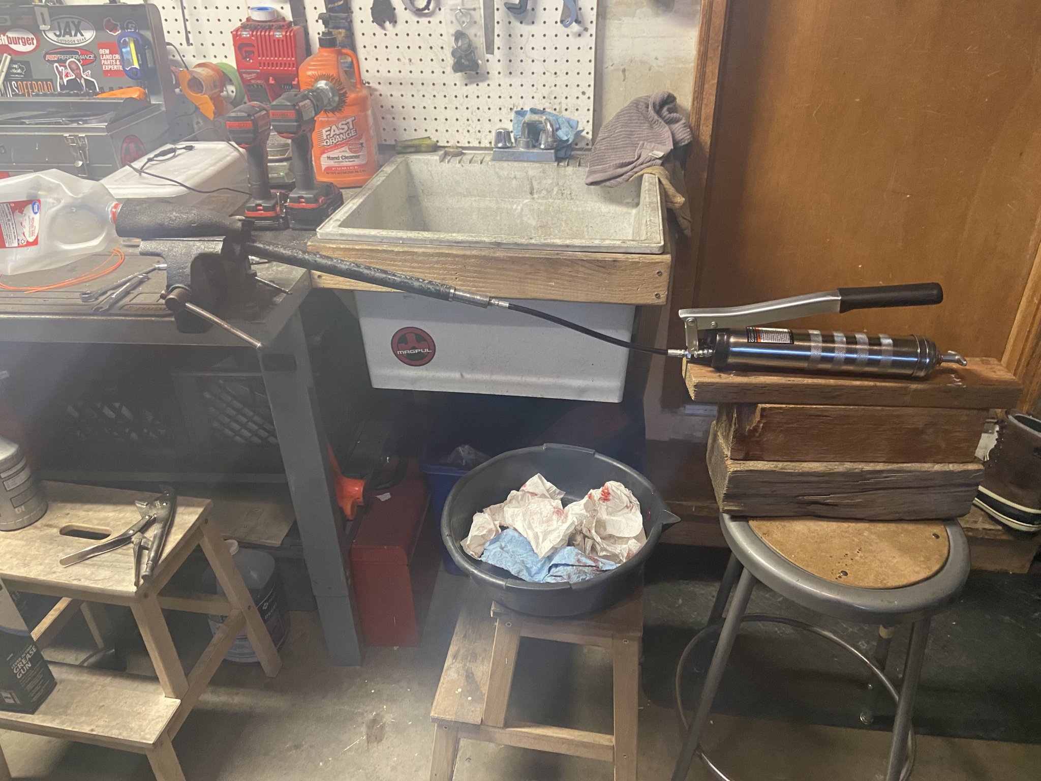

Squib load, got it out!
verdugo60
  • Jul 6, 2010
    2,265
    987
    40
    Denver, CO
    I’m an idiot. Let’s just get that out of the way first. Doing a ladder test on a 6.5 Creedmoor proof carbon barrel, I didn’t powder the case. Primer shot bullet into lands about an inch and a half from the back of the breach, including chamber. Bullet is a 140 ELD-M.
    1. Tried tapping, then ramming it out with a cleaning rod. No luck.
    2. Tried a steel rod next. No dice. Really hammered on it (idiot).
    3. Tried tight fitting brass rod from the hardware store after soaking in penetrating oil. No luck.

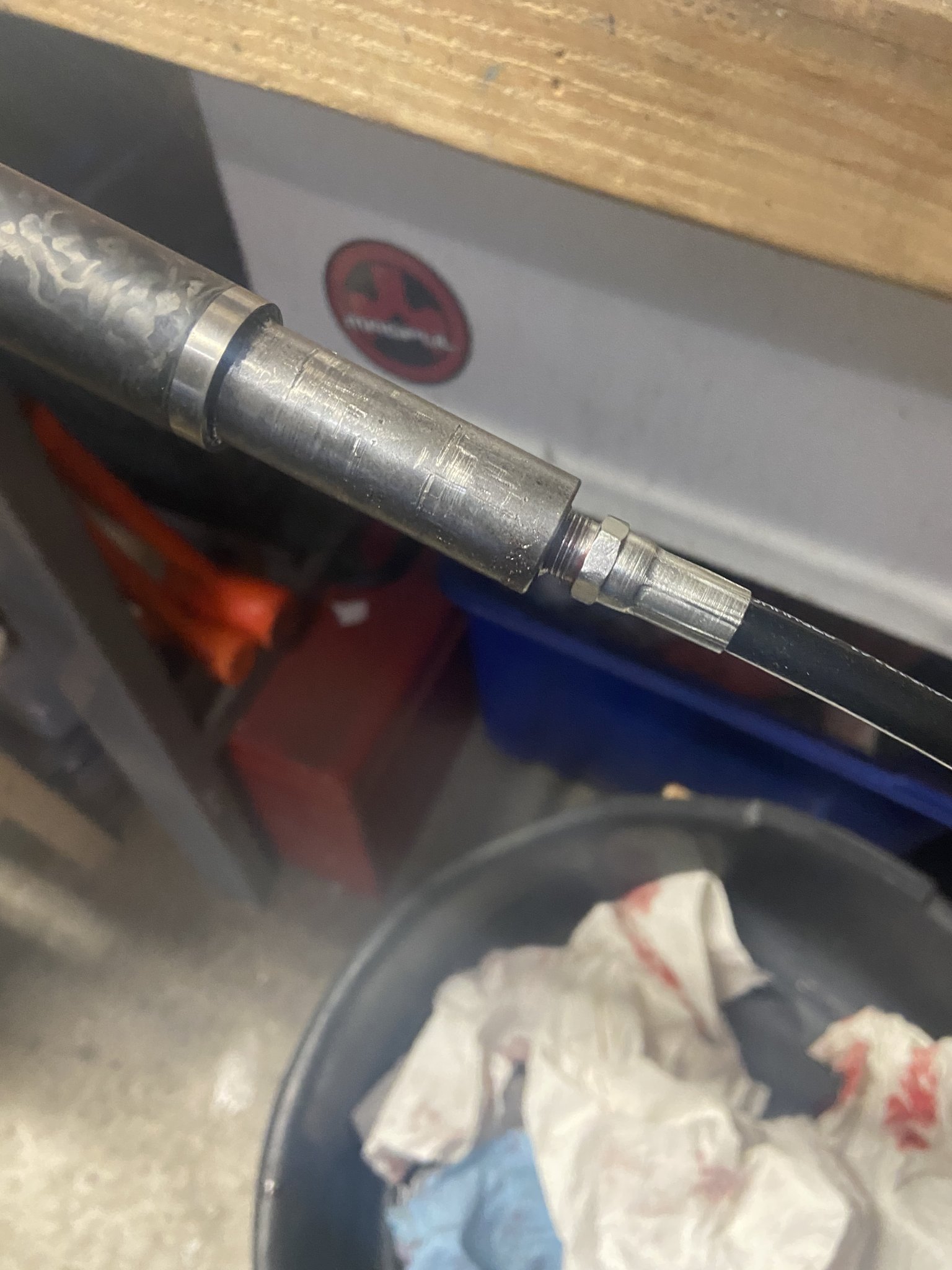

    4. Rigged a 5/8-24 fitting into threaded muzzle in an attempt to use hydraulic pressure and blow out with a grease gun. Ruptured 2 grease gun tubes, hasn’t moved.
    I’m guessing with the hammering from the muzzle end the bullet has expanded, making it even more tightly stuck.
    Any ideas or a smith that could take this on before I send it to PROOF and beg for mercy? This barrel was just starting to show promise and I’ll be really bummed to lose it.
    Have or know anybody with a powerful air compressor? Instead of using the grease gun get a male air adapter for the hose connected and adapt it to the 5/8-24. Fill the void with water and then hit it with air. You need a lot of PSI for this to work. But drilling out the center may be easier if you have a drill press.
    Maybe try putting some CLR down the muzzle. Might be able to eat enough jacket to rod it out?

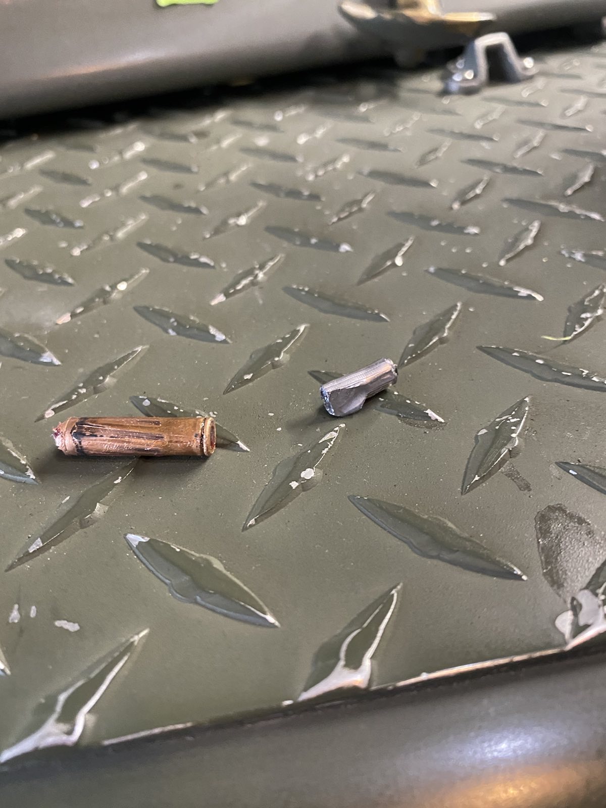

    What comes out will look something like one of these depending on caliber and bullet...

    Im really surprised a grease gun did not pop it out. You are saying the "grease gun tubes" ruptured you mean the rubber hose correct?
    Is there a pressure rating on the hose? The ones I use are rated to 3000psi.

    Curiously asking….
    How would air work if a grease gun can’t? Our grease guns claim to kick out at something like 8000 psi…..not sure of any compressed air getting anywhere near that number. Like I said, not bashing, just asking.
    Curiously asking….
    You're only using the air pressure to move the liquid a bit, you can't hardly compress a liquid so it's essentially a solid. Back in the good old days if you had to remove the bolt on the end of a crankshaft (holds the harmonic balancer on) and you couldn't get it out with air tools because a crankshaft spins, what do you do? At TDC ,both valves are closed in the cylinder head, pull the sparkplug and fill the cylinder with water, put the plug back in.
    Once the piston hits the water it's not compressing and the water can't go anywhere if the valves are closed so now you can use a ratchet or breaker bar to get the bolt out. You don't need the much PSI but probably a compressor that can go up to 120 PSI. I had an adapter at one point which was the male end of the spark plug with whatever NPT male air. Could hold the water against the piston or just air to hold valves if you wanted to mess with locks or whatever so they don't drop into the cylinder.
    I watched the crazy guy on that one reloading channel blast grease all over his wall doing this to get a squib out of a Krieger .308 barrel, same premise. He ended up doing what I'm suggesting (air) because a 5/8-24 to a grease zerk would leak or the gun was but he had a barrel full of grease.
    I can't speak to how they rate the PSI on a grease gun, you'd think it should work if it's actually that much.
    Find someone with a high pressure nitrogen bottle and regulator. [ aircraft mechanic shop ] Fill the barrel with water and use the regulator to slowly apply pressure thru your threaded adapter. Most nitrogen bottles go to 4000 psi. Good luck.
    Thank you for all of your suggestions. The barrel has been off the gun, fyi. I may try drilling next in combination with air, water, dowel, lol. I’ll update with any progress.

    Success!!! Drilled out the back of the bullet very carefully using a collet made out of thick tape. We purged the grease gun of air again and gave it 3 quick pumps and the lead core went shooting across the room! LOL.
    It seems that just relieving that pressure allowed it to shoot out the back after drilling the base. We then easily tapped out the remaining shell of copper jacket with a brass rod. (Note how flat the nose was, pounding on it just flattened it into a wad cutter, lol).
