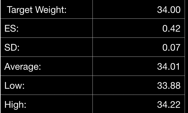

We’re all always looking to for ways to spend less time loading and more time shooting. Well most of us.
StaBALL has been fairly easy to find in comparison to many powders. Being a ball powder, it should meter well out of a volume throw.
We have a Harrells BR Premium thrower. We did a 50 charge test to see what kind of error we would be working with before seeing what that looks like on chrono.
Here are the results for anyone interested:
Scale: Fx120i
Thrower: Harrells BR Premium
Number of Charges: 50
Target Weight: 34.00 gr
Average Charge Weight: 34.01 gr
Lowest Charge Weight: 33.88 gr
Highest Charge Weight: 34.22 gr
SD: 0.07 gr
ES: .42 gr

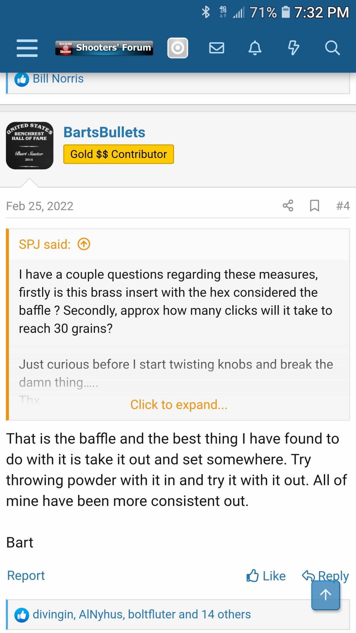

Dave, is that with the baffle installed or removed?
I've noticed with my Harrell's (Little BR model) that I get about a .1 difference with the baffle installed. I drop a little over 34gr for a BR/105-107 combination.

Baffle should be install. Took it out the box as is and went to town.
What kind of results did you see without the baffle?
It’s brand new for me, so I’m sure I have to learning to do with it.

Also, the 34.22 was definitely an outlier. The highest that repeated a bit was 34.12.
The StaBALL seems “sticky” as far as not always falling completely out of cup or funnel.
So I could have easily had some kernels left behind.
It'll get more consistent after getting a few pounds run through it.
A few of the guys from AS say they are much better without the baffle. They even go so far as to say the fill percentage of the bottle makes a difference.
I never bothered to test to confirm or disprove that.
I use the baffle in mine.
I'll see if I can find the thread(s).
BRB
BRB
I missed this response last night.
Sticking in the funnel could be caused by not having it fully seated into the collet.
I always turn mine upside down to install the drop tube.
Also, use the largest ID tube you can use without causing the neck of the cartridge to insert into the tube.
My 3/16 tube hangs up with Varget sometimes.
