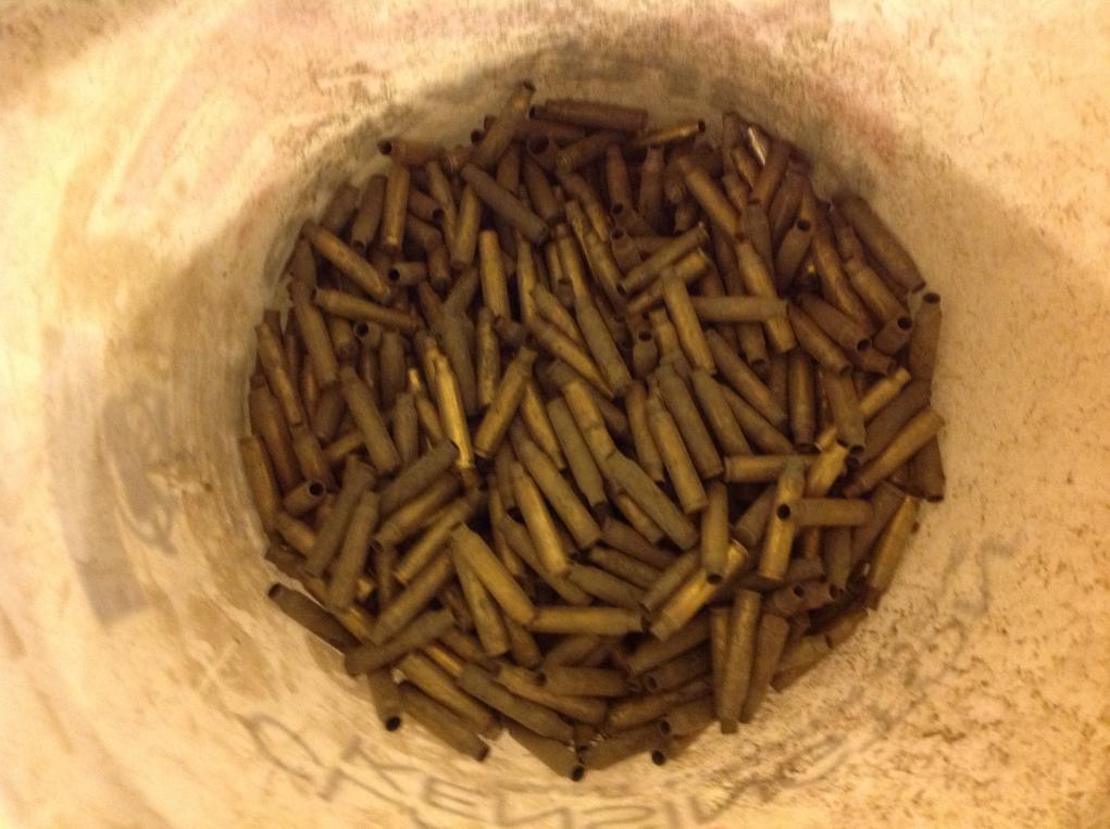

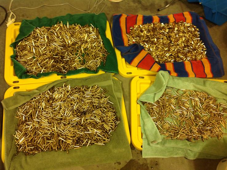

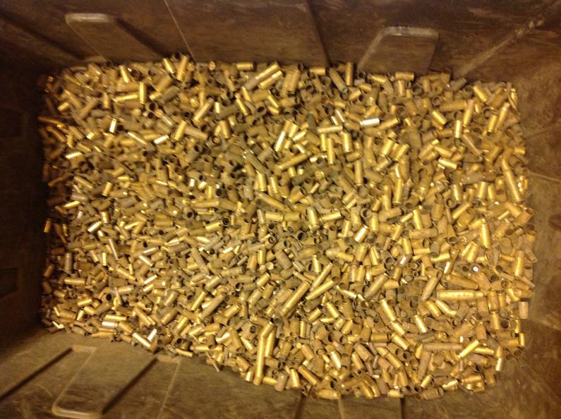

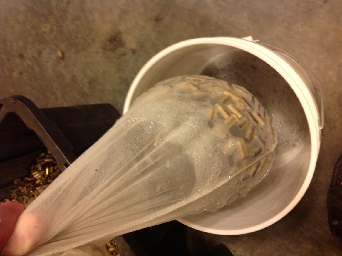

To cut the time I have started to soak the brass in hot water and Lemi for about 20 minutes before putting it into the tumbler. This has cut my time down to a little less than 2 hours.
To soak the brass, I use a five gallon bucket with a paint strainer liner. This allows me to agitate and remove the brass easily. A quick rinse and into the tumbler.
Here are some photos. Suggestions are always welcomed!!! photo 3.jpgphoto 2.jpgphoto 1.jpgphoto 5.jpgphoto 4.jpg
