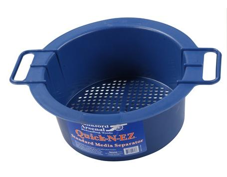

Then I dump my rifle brass, SS pins and remaining dirty water from the tumbler into a basic media separator sitting over a bucket.
The bucket sits in a deep utility sink that has a hand sprayer attachment on the faucet (like a kitchen sink)
I spray the brass and SS pins while stirring them around with one hand.
This rinses the brass while washing the SS pins down through the media separator into the bucket.
Once all the SS pins are washed from the brass, I then pick up the rifle brass and tap them neck down on the media separator to knock out any excess water or remaining SS pins. At the same time, I check the flash holes for any stuck SS pins.

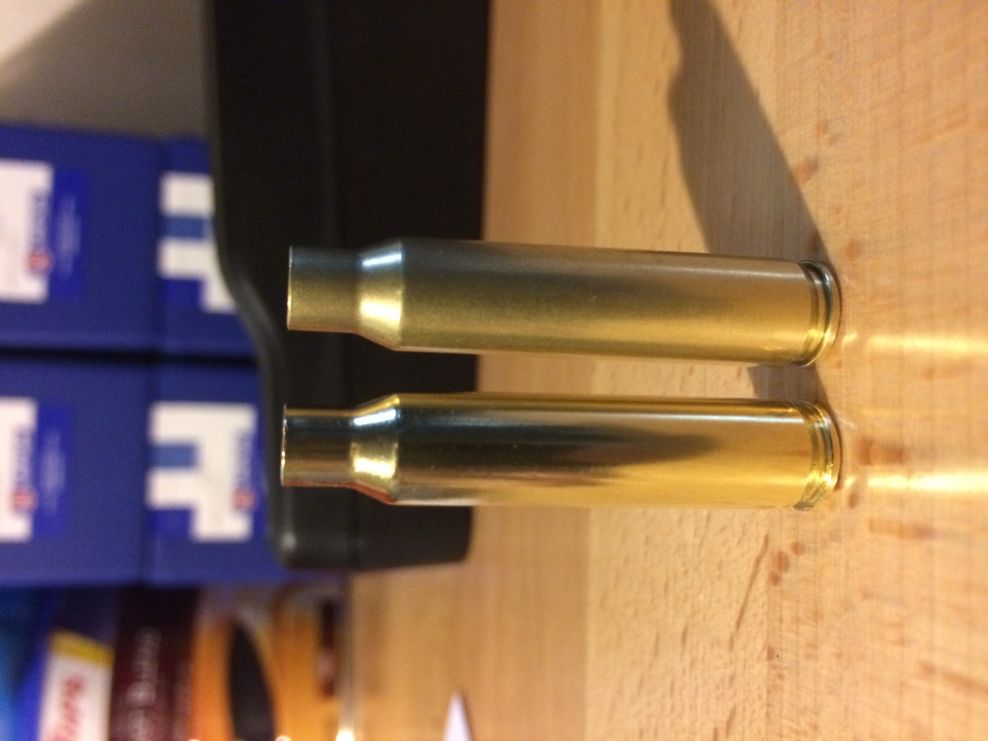

on the "patina" problem...sometimes I get it and sometimes I don't. I have the cheap dual drum from harbor freight. I split my brass into the two drums. dawn, pinch of lemi, 1-1.5 lbs pin media. Sometimes both batches come out brilliant, sometimes they have the patina. Sometimes one drum is shiny and the other isn't. If it comes out with patina I can re-run it and then it will be bright, or it might be worse. I can't figure out what variable is causing it. It's on a 3-hour timer and sometimes I don't get back to it until the following day so it sits, but I've had them sit and still be pretty. The water can be really dirty and the brass will be bright, or the water can be fairly clean but I'll have the patina. I read the earlier posts about carbon in suspension, I wondered if it was caused by the rubber interior of the drum? help!
