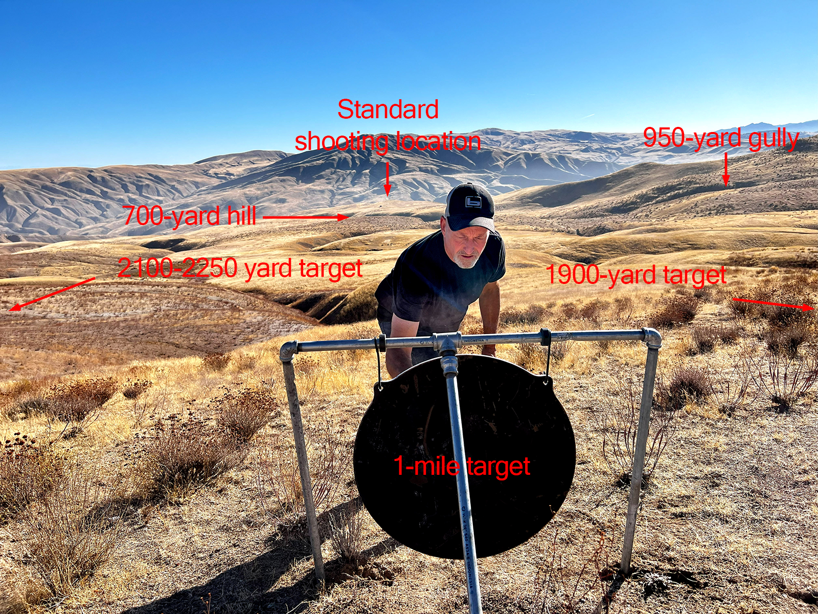

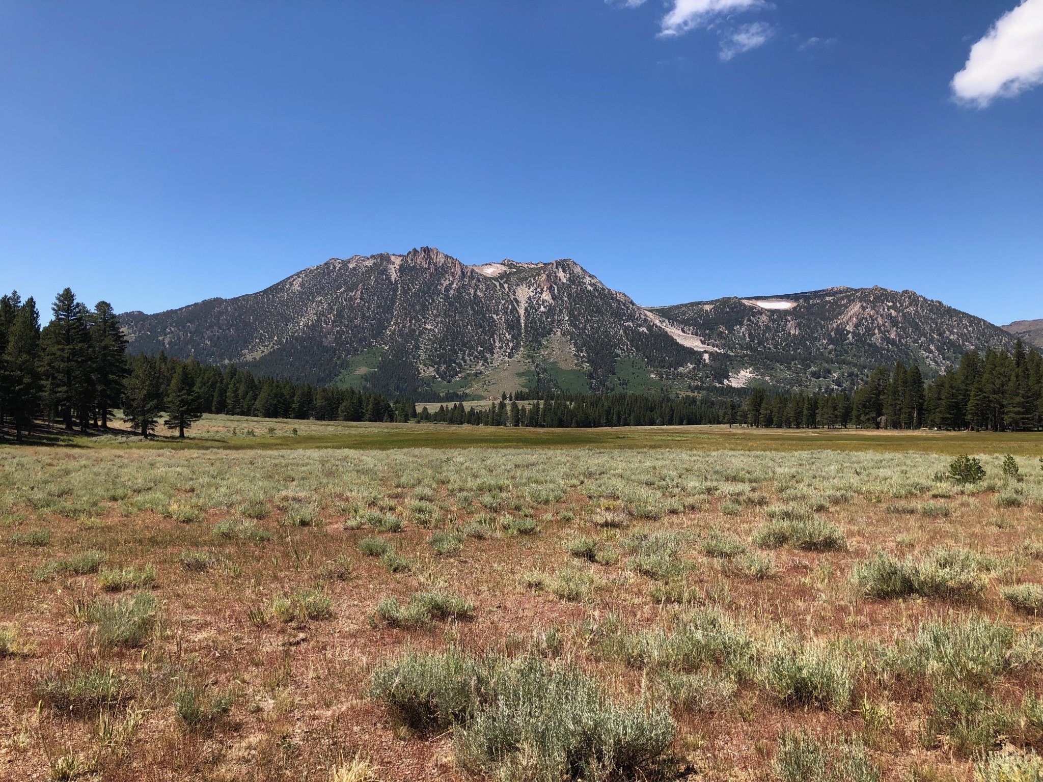

Yeah, it's tough to get going without someone to help. I'll say, though, that as soon as you hit a shot at 500, you need to then hit 1000, then 1500, then...
As for finding places to shoot on public land, I agree 100% with your notion of doing a scouting trip where you don't even bring your rifles. Why? Because when you try to do both scouting and shooting, you do neither well. As an example, one of my favorite places to shoot is this:
The first time I scouted this area, a friend and I were planning on scouting and shooting both. We stopped about a mile short of this valley to shoot at a sub-par spot. It wasn't until I got home and started looking closer at the area on Google Maps that I found this valley. We went back on another trip, but lost a lot of time finding the best places to set targets, etc.
Besides, I find scouting trips to be really fun. You have to find open spaces with easy access to the shooting location and target spots, and are safe to shoot at (e.g. not over roads, have a sizable backstop, etc.). When you find the right spot, it's like striking gold.

No doubt about this. This is my go-to spot for winter shooting:
All the target locations except for the 2100-2250 yard ridge (off picture to the left) are within like 100 yards of the road that goes down the valley. On the way in, we set targets. On the way out, we pick them up - easy. But it still adds at least an hour to set on the way in and probably like 30-45 min on the way out to take down. If we go over to the 2100-2250 ridge, we have to stop there separately on the way in and we have to hop a barbed wire fence (with a 60lb target and stand) and hoof it like a quarter mile. We don't tend to set that target too often...
And I forgot to add 45 min from the highway using a capable 4WD vehicle.
Still, nothing beats spending an entire day in a place like this.
